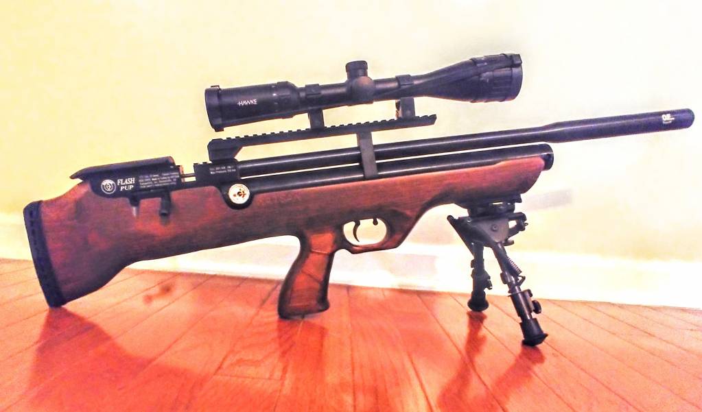

Thank you for all the help! I tried the artillery hold and it did bring the groups in some with JSB Diabolo Jumbo heavy 18.13gr being the most accurate. But I ended up buying a Refurbished Hatsan Flashpup in .177 because I like to see my holes touching. LOL! Thanks Again!
