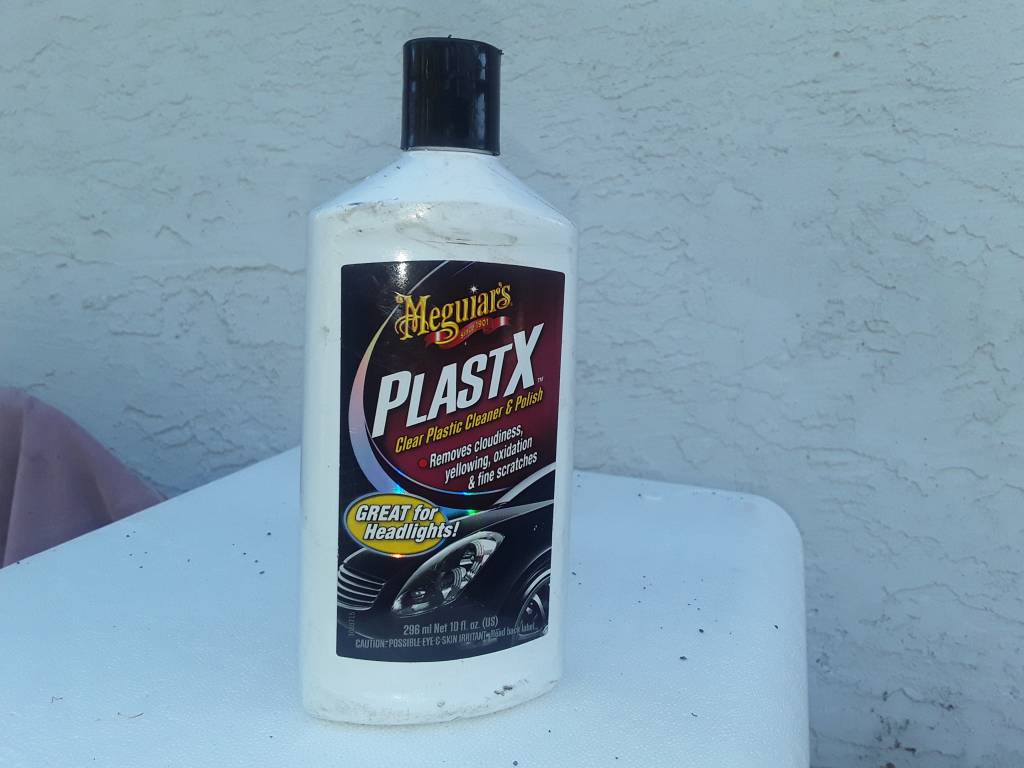

I was looking at my FX Boss' pepper laminate stock in the sun today & noticed a couple "cloudy" areas. Mostly on the cheek rest & butt. Microfine scratches, but enough of them to cause dullness. I used some Meguiar's PlastX & it removed the cloudiness & brought incredible shine & luster back to the stock. Looks brand spanking new! I've used it for years on my drums that had high gloss finishes too & it's never failed to make things look beautiful.
P.S. Works wonders on guitar finishes too!
id say depending on surface, most automotive paint and clearcoat polish will work and the finish can be worked the same as any other paint .. never tried plastx on paint, it works good on plastic lol .. its probably just a really fine cut though ie, more work than an actual compound ir scratch remover/ clearcoat polish ... no idea how any of this would react to a 'truoil' etc finish, but high gloss clear laquer or urethane, yeah ...
