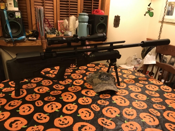

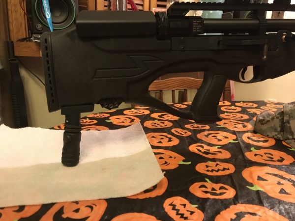

Was going to clean my Bullies barrel in a bit with the PatchWorm kit but then I remembered that I had a Accu Shot Mono Pod so I removed the sling stud that came on the Bully and screwed in a single stud without the sling strap piece and then put on the Mono pod so now it should hold on target Steadier then the Caldwell rear bag.

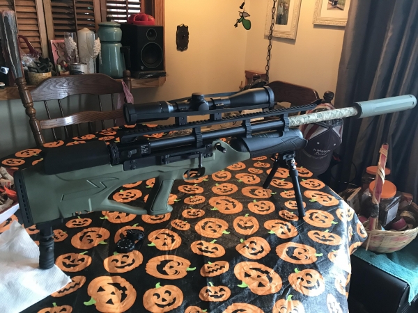

paint job looks good. Did you end up just re painting over the old paint?
What did you put on the barrel shroud? Camo tape?
I took and put my heat fan on it and it started to cure way better then I just repainted the areas that had marks from handling, it was still wet in a few spots when I took the newer pic and then I put my fan with heat back on it and it’s doing just fine now, the only time I’ve had paint do this is if it was real old or just plain cheap, it all looks uniform now and I did put some camo rap on the barrel to see if it helps with any vibrations and sound, can’t get any quieter then it is now well maybe a electronic loading system would make it quieter hahaha. I also just tried to even out the color a bit being I only painted the main stock and LDC.

Jim- are you going to paint the rest of the stock? The bottle cover and cheek rest?
ive always been leery of trying to paint aluminum, which is why I did not paint my DonnyFL Shogun. But, I am unsure about painting over anodized aluminum. I know raw aluminum does not accept paint well at all, just unsure about the anodizing. Let me know if the paint takes, and if so, it’ll give me a reason to repaint the stock with a better color match to my scope
I’m thinking of painting the bottle cover and cheek piece in a desert tan or something like a fde, the paint I used was for decoys,rifles,bows,boats so I thought it would have a tuffer coating and I would also give it a try on the LDC, most it will do is scratch off the ldc, I have not touched it since I did the touch up so I’m not sure what it feels like but I’ll check in a few more hours, it’s sitting on my table still, that camo tape is kinda tricky to use in tight areas but I would like to get those other 3 barrel sections taped in camo, I think it will look nice with the green - tan and then the camo wrap on the barrel sections but that’s my taste I guess.
Have you ever had your barrel shroud off? If I may suggest do not paint the shroud or tape it inside of those shroud bands/scope rail mounts. There is an O ring grooves inside of those bands, which gives it a snug fit. If you tape your shroud and decide to remove your shroud it’ll be either a fight or a mess.
Just my thoughts. Just trying to slide the shroud as it is is a snug twist and pull. That was the main reason I did not paint the shroud.

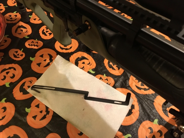

Jim, I was noticing that nipple sticking out of your Bullys fill port. Is that just the full probe that you leave in there with a plastic cover over it?
Yes it is, I removed the long metal arm that covers the port hole when cocked and just put a probe in it with a cap, when tetherd every time you cock the rifle that metal arm moves to expose the fill port hole so I just removed it that way it’s not binding up against the probe every time I cock it and I never forget the fill probe that way.
