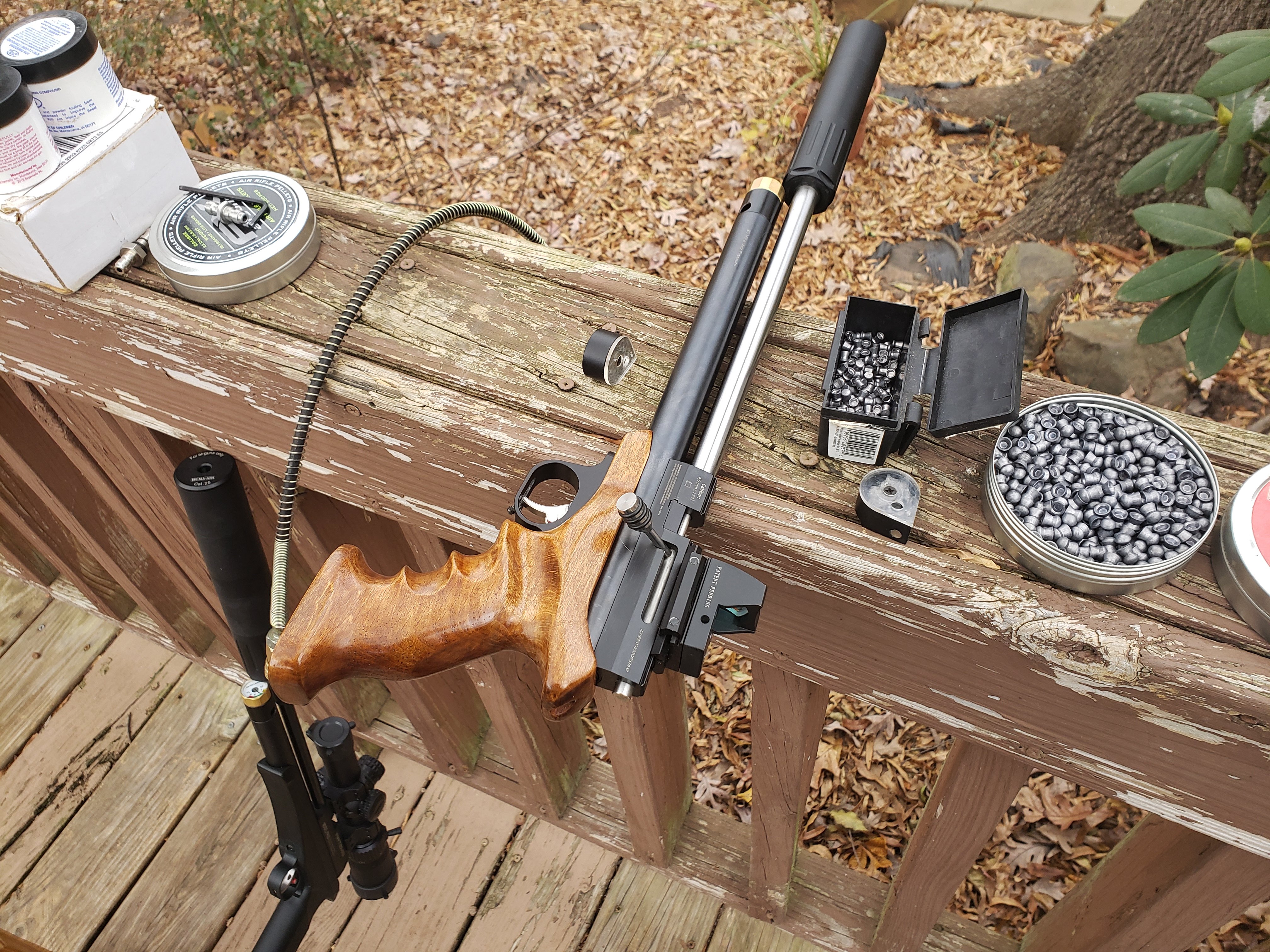

Guns, depending on what they're equipped with will have different balancing points. As well as different reciprocating masses (hammer). The less hammer mass, the less the gun is affect by its start and stop travel. Which is why real target pistols employ lightweight hammers and lightweight hammer springs. As well as heavier barrels sometimes. (and for other reasons) Position of the hammer in the gun (forward, rearward, height) all affect how the gun acts when fired. This is a relatively small affect. But the worst gun I have regarding this is my 2 pp800's. They have heavy rifle hammers, and where they are positioned in the gun seems to be rather disruptive. This can be compensated by balancing the gun out. Different weight optics positioned forward or rearward or different weight/length moderators. Here is what my 177 pp800 looks like in its most balanced config (also has a lightened hammer). The moderator is from huma and can be configured at various lengths. In 20mm or 40mm incriments. More or less weight on the end of the gun. Hold will also affect how a gun behaves when fired, and hold can compensate for any imbanace as well. But it's better to balance a gun first, and just use a normal hold. 20211201_155115.jpg

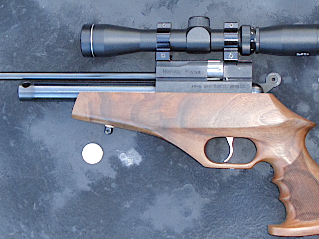

This 35 yard SIX-SHOT group measured just .64" center-to-center.

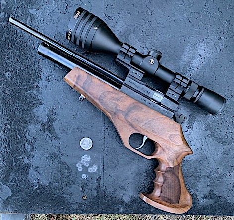

The 1" diameter quarter lends perspective to this TWELVE-SHOT group at fifty yards.

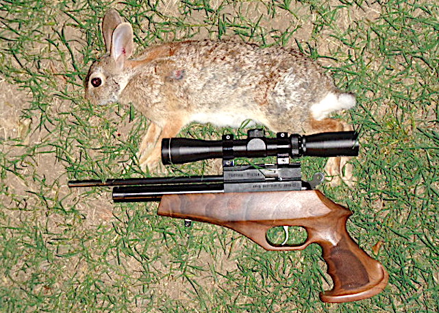

An 18.1 grain JSB at 700 FPS+ zipped right through this cottontail (broadside) at 46 yards; an excellent example of the AR6's proper application.
