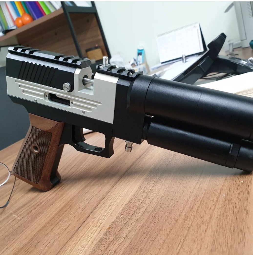

Here is the Most Accurate Pistol you can buy: the 2023 Evanix AR6-P

This new Evanix semy auto pistol .. got my attention ...177 - 22 - 25..

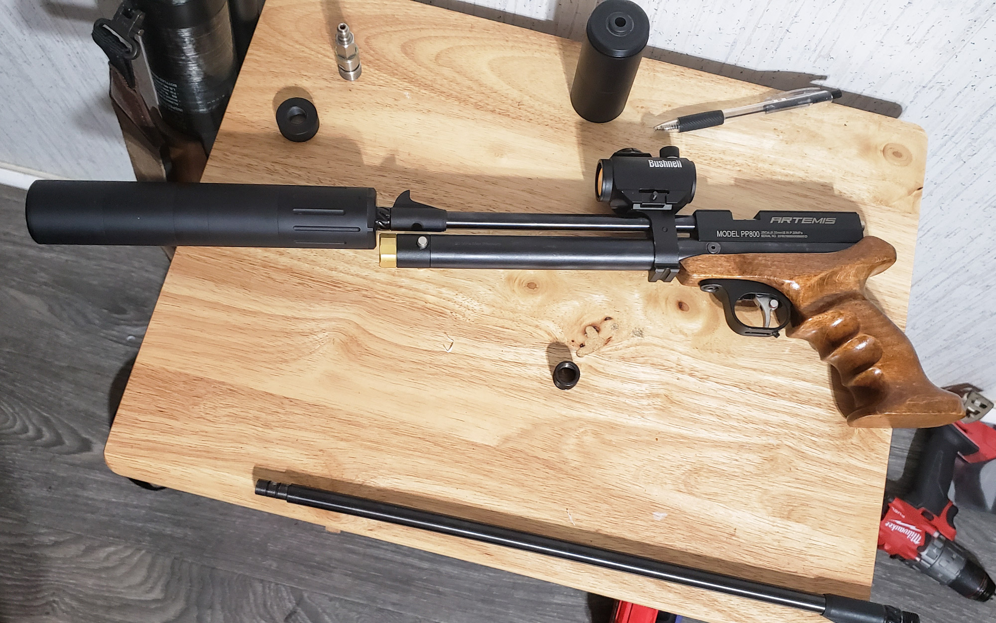

Guns, depending on what they're equipped with will have different balancing points. As well as different reciprocating masses (hammer). The less hammer mass, the less the gun is affect by its start and stop travel. Which is why real target pistols employ lightweight hammers and lightweight hammer springs. As well as heavier barrels sometimes. (and for other reasons) Position of the hammer in the gun (forward, rearward, height) all affect how the gun acts when fired. This is a relatively small affect. But the worst gun I have regarding this is my 2 pp800's. They have heavy rifle hammers, and where they are positioned in the gun seems to be rather disruptive. This can be compensated by balancing the gun out. Different weight optics positioned forward or rearward or different weight/length moderators. Here is what my 177 pp800 looks like in its most balanced config (also has a lightened hammer). The moderator is from huma and can be configured at various lengths. In 20mm or 40mm incriments. More or less weight on the end of the gun. Hold will also affect how a gun behaves when fired, and hold can compensate for any imbanace as well. But it's better to balance a gun first, and just use a normal hold.View attachment 321132

The pp800 below has a hammer system similar to what you are shooting. Heavy, with an even heavier spring. The positioning of the hammer in the gun doesn't seem to be well though out, because it does disturb the gun quite a bit when fired. To help stabilize and hold the muzzle down during shot cycle I have a rather large moderator on it. Some of this can be compensated for with hold as well. It also doesn't help the gun is very light by its self.

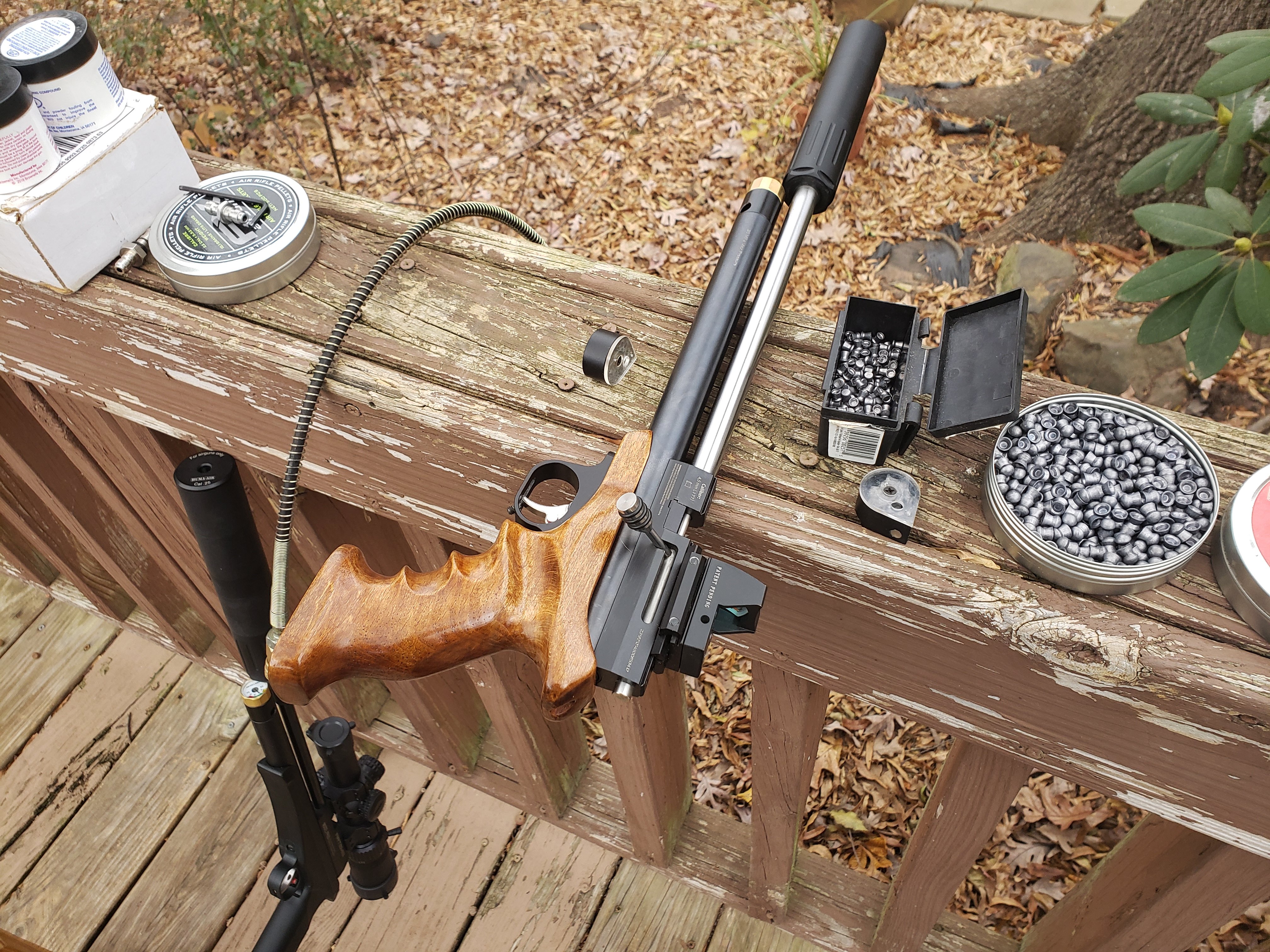

This one tends to get muzzle drop when fired if equipped with a lighter optic and lighter grips. I have very dense ebony wood grips, and a heavier optic that adds weight toward the rear of the gun. Extremely stable off-hand, and also very heavy.
