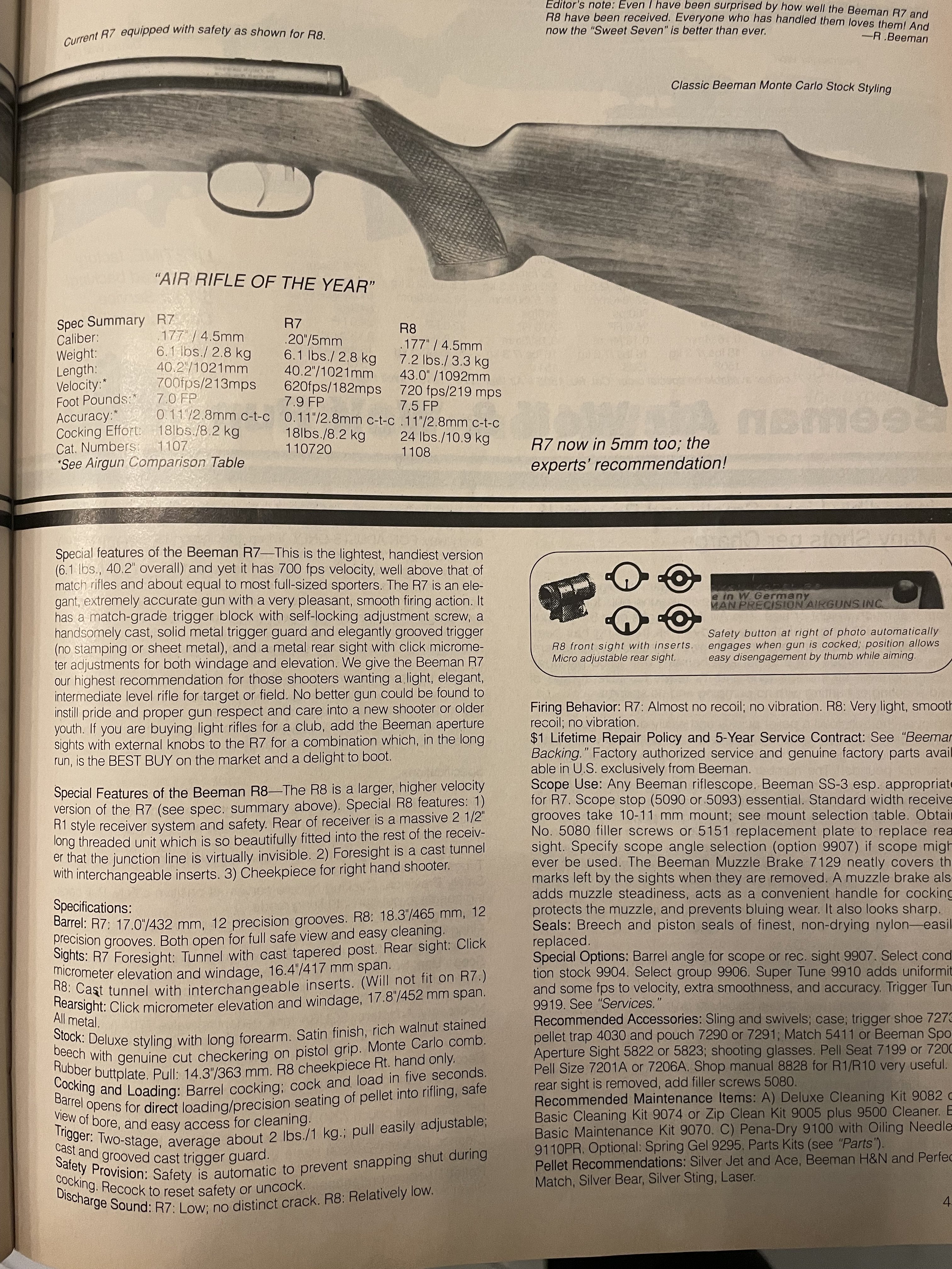

HW/Weihrauch Here it is. My last airgun came today.
Yes the R8 is quite a bit heavier than the R7. If your only concern is velocity/ft lbs. the R8 is not the gun for you. As I mentioned a while back, the R8 is a ~700 fps gun. If that is not enough power for you, you should get rid of it and move on.

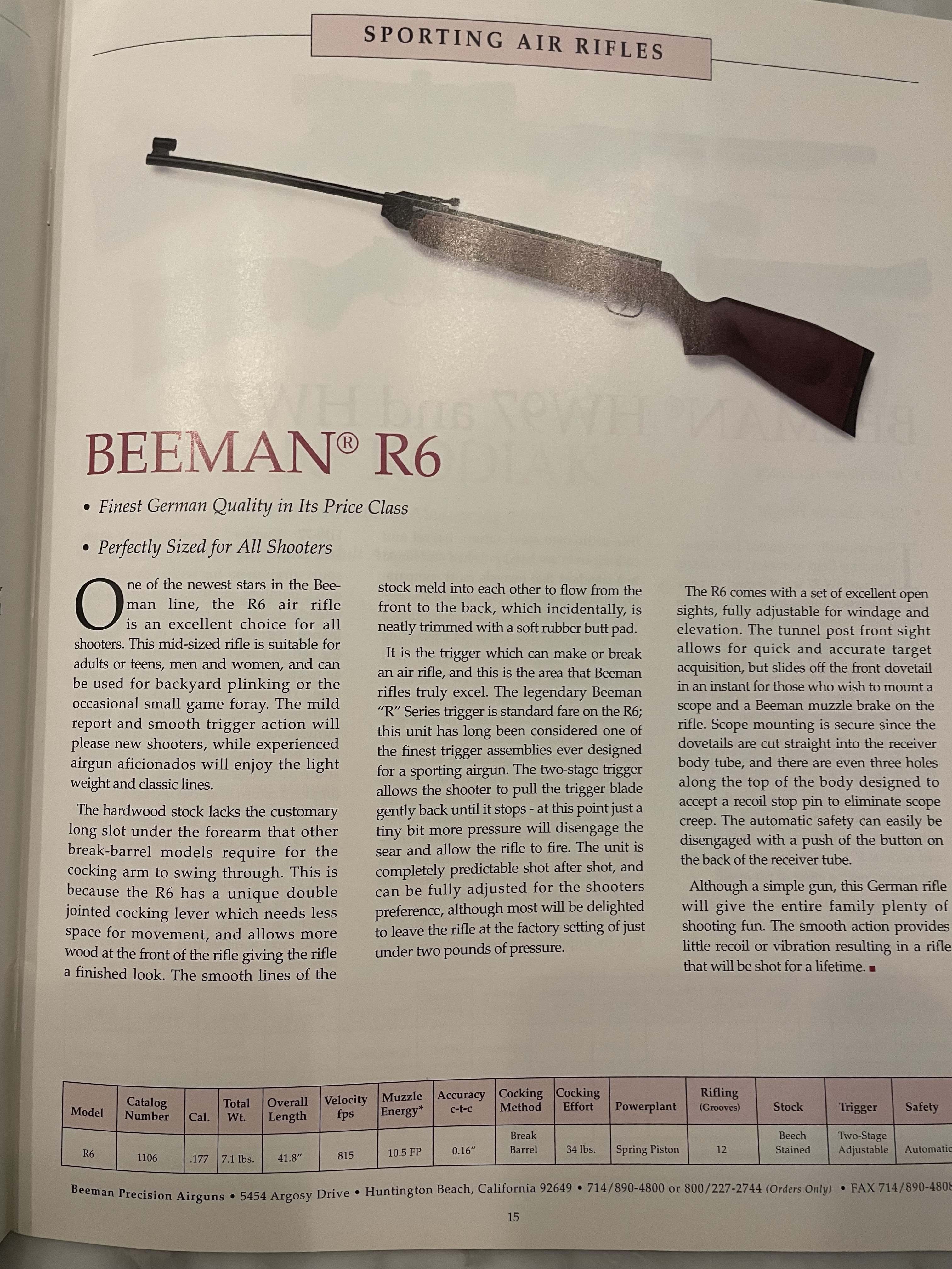

I should have dug this out a while back which should give you all the information you need. The R6 is the new HW50S and has 3 ft/lbs more power than the R8. Sounds like you need 9ft lbs. Can you get the R8 to this level? Yes. But you need to put in the work.
