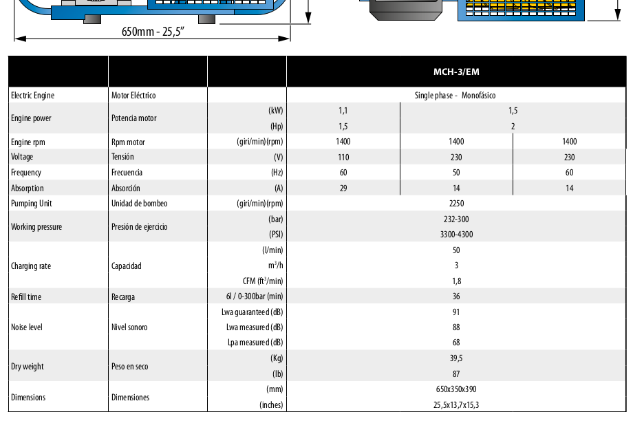

LMNOP, I followed your link above and own an LC-110 3 stage Daystate as you do. The Coltri MCH-3 specifications indicate that it might have a 220 volt motor or a larger 110V motor turning 40% more rpms than the LC-110. The decibel rating on the MCH-3 is higher at 91db reflecting higher rpms and higher noise level. Also, the fill rating on the MCH-3 is 50 liters / 1.7 cubic feet per minute whereas the LC-110 is running at 78 db with a fill rating of 30 liters / 1.1 cubic feet per minute. It would be nice if the LC-110 had an hour meter like it's MCH-3 cousin. I wouldn't want a faster fill speed unless the MCH-3 has a different motor than the LC-110's 1 horsepower rating. In many respects I prefer the slower fill rate and lower decibel rating of the LC-110. It means that the LC-110 runs at a lower rpm and at a lower operating temperature which usually means better longevity. One of the best attributes of an LC-110 is it's relatively low noise level compared to most compressors.
Looking at the motor plate on the site, looks like a euro motor for 50Hz ~220V. I think the RPM still says 1680 RPM... hard to tell, the PDF manual says 1400 RPM for the MCH 3 EM LC that I uploaded. Matches the pictures in that link too. LOL who knows, Coltri and their manuals. The data bits always trip them up like with Oil levels. Site says 330 bar PDF says 300 bar, lol.
Either way I think the LC-110 is pretty much a Coltri MCH-3 3-stage low consumption variant that's been scaled down for air gun use... such as no breathable air filter, etc. If I had a valve plate break I'd hit up Nuvair for parts and wouldn't have concerns I couldn't fix it due to lack of parts.

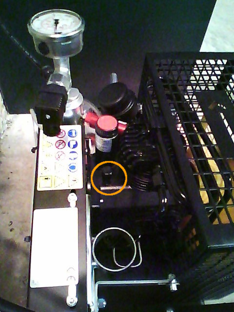

Yes -- I removed the crank case nut when draining and filling, even though the manual mentioned nothing about removal during draining. It just makes sense to avoid vacuum lock. Equiv to removing the oil fill cap from an automobile before you loosen the oil drain bolt from the oil pan.
See the orange circle. It must/should be removed prior to re-filling with oil, this is in the Coltri manual:
The LC-110 reads at the top of my fill level on the dipstick fully seated in the cap holder using 300ml of compressor oil. If I added 330ml it would be well above the dipstick upper fill level. Mine was built before the sight glass version was being sold but it is a 3 cylinder version. I'll recheck my manual but am fairly certain it said to fill with 300ml not 330ml of oil.
