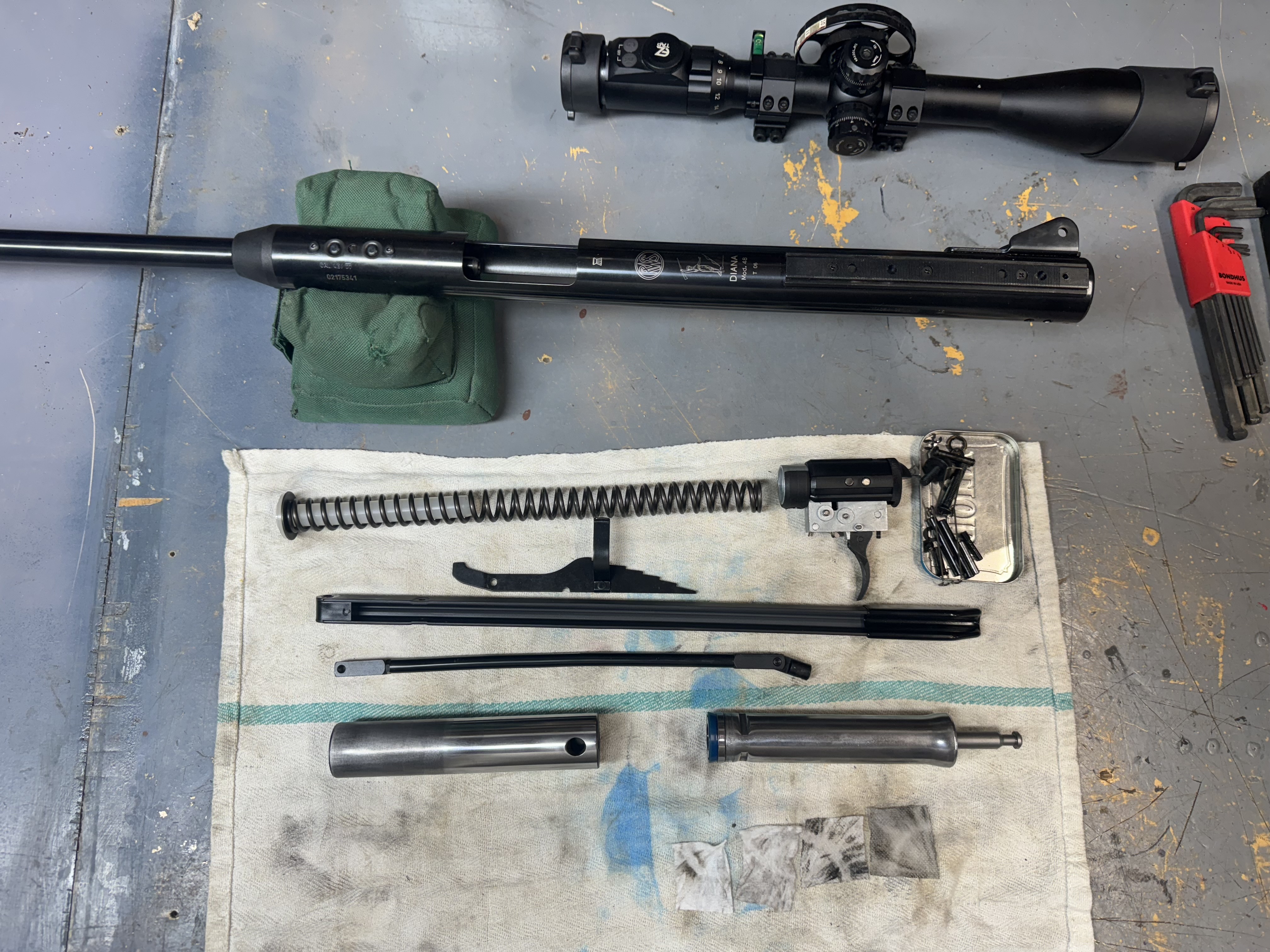

So I took everything apart. I took a little more than necessary because of my spring compressor. I’ll make some changes to that later.
But this rifle is brand new. I cleaned and inspected everything. I ordered new seals but I’m not going to put them in . I’ll have them for later.
I don’t normally clean an air rifle barrel much. But since it was new I ran a patch with alcohol then three dry ones and it’s nice.

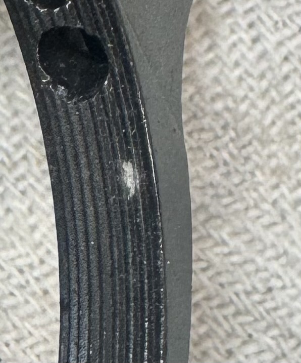

Except there is a chip in the front of the blade.
How do you suppose that happen? I got it out but had to reblue the trigger face.
Everything else looks good.
