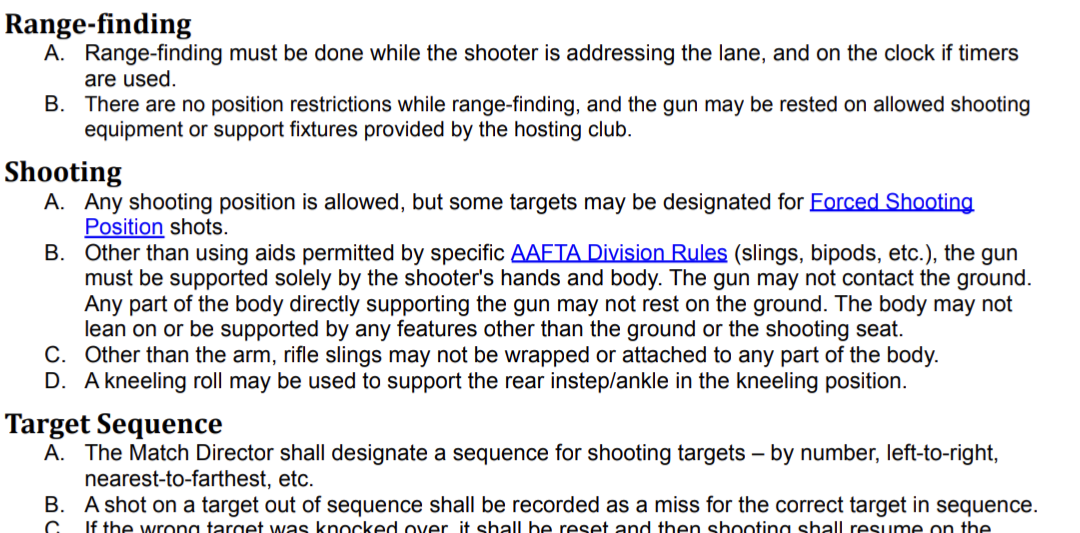

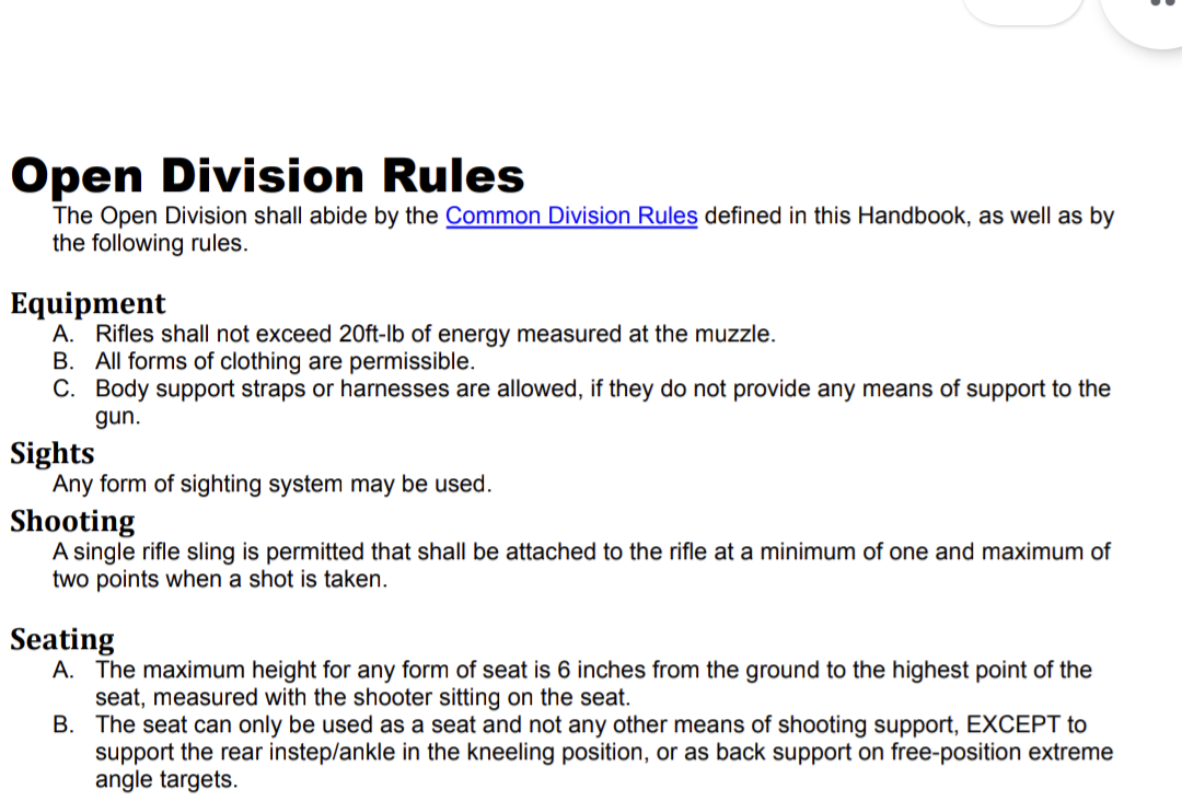

OPEN CLASS in AAFTA events .. CAN NOT shoot from an elevated seat such as a bucket or stool, and Can Not use shooting sticks
Yes, I was wrong. Sticks not allowed in Open. I just read through the rules again.
The section of the rules that covers Open does not address sticks, so I assumed they were allowed and just nobody chose to do it out of field target culture. Only when looking at general rules does it specify that unless otherwise stated, the person shooting actually has to hold up the gun. And in the Hunter rules it allows sticks.
So, it is not addressed in Open rules (where it really should be), but is addressed in the general rules. Bassackwards way to have a rule for Open (ie not in the "Open" section).
Sorry Michael and anybody else I lead astray.
And @Motorhead, thanks for setting me straight.
Here are the rules for Open, where logic and common sense would dictate a rule governing Open should be...
And here are some of the general rules, section B under "Shooting"
