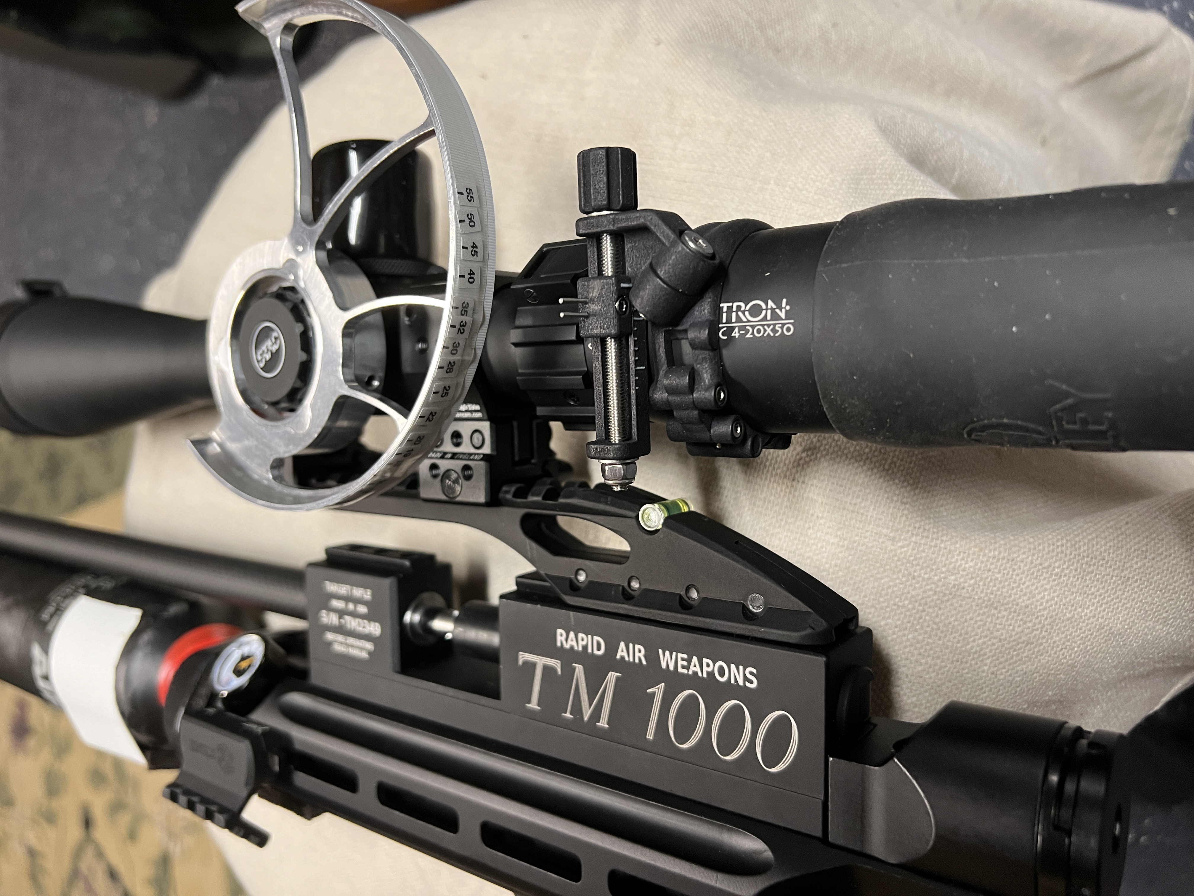

@cavedweller, what is that pointer mechanism on your scope?
@cavedweller can I ask why you aren’t using the long end of your wheel to give the most separation on your yardage marks?
On my HFT pistol I only need 10-35 yards for ranging markers as that’s the minimum and maximum distance for target placement.
Those distances spread out very well even on the smaller radius of the parallax wheel and this allows me to do a taco hold / grab the top of the scope for standing and kneeling lanes.
