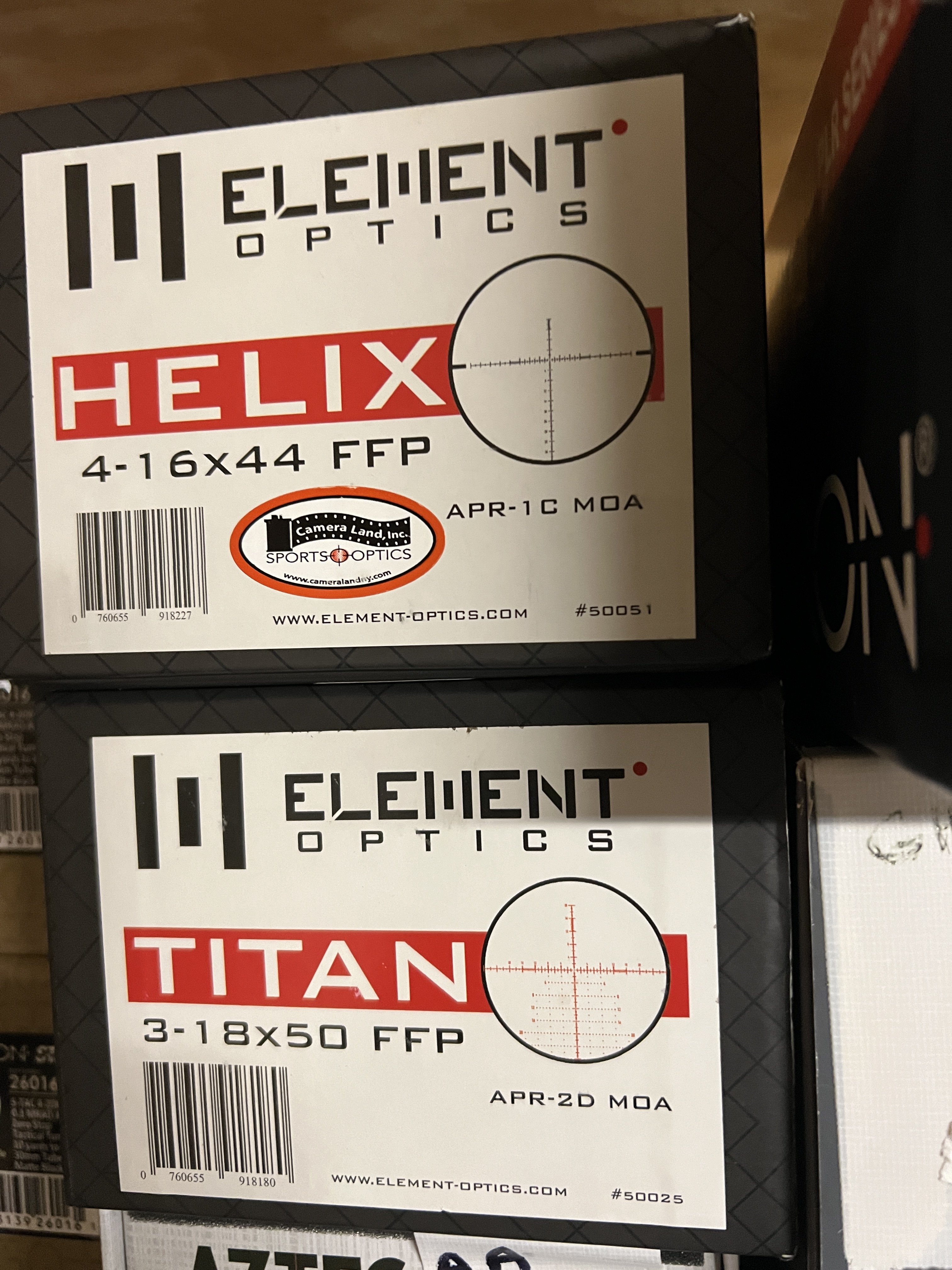

Of recent, i have been pleased with Athlons Heras SPR 6-24x56 with the APRS9 FFP reticle. a good 5-6" parallax wheel will do a good job helping spread the numbers out from 40-55 yards. It's not perfect but it wont break the bank.
The Element Titan 3-18x50 (similar price point to Athlon above) does a fabulous job spreading the numbers out!
But sometimes me ol eyes have trouble with thinner FFP reticles in dark lanes esp against darkly painted targets.
