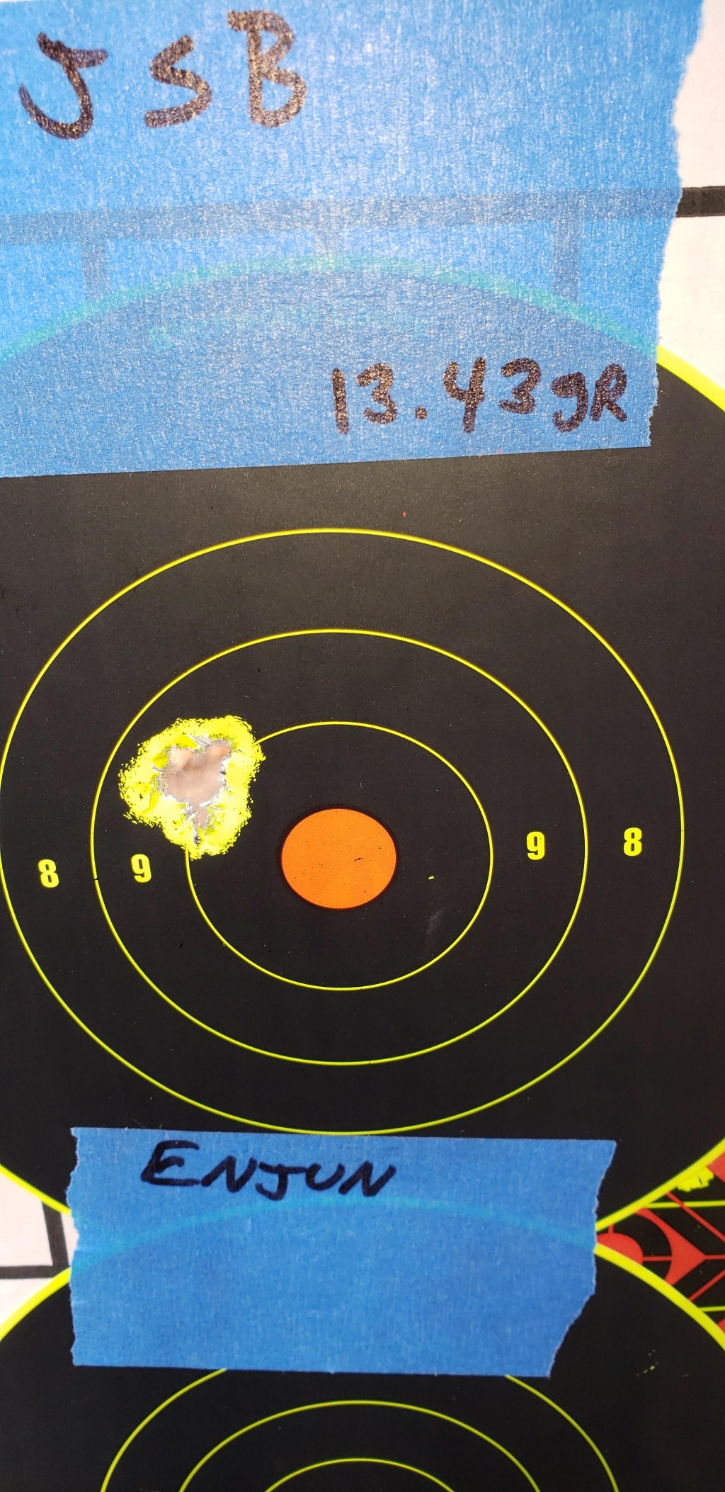

hitting my target is not the issue. heres a 50 yd
Shooting targets and hunting or pesting are not the same, similar maybe. Shooting live critters is not the same as groups on a target. At the ranges you describe. And at the energy level your Flashpup is producing those should be dead squirrels. Lethal shot placement is key. That said, I like my Bantam Sniper HR and love my Compatto. Both are 30 FPE .22s, and can take squirrels or chucks out to 50 yards if I do my part. A good scope will definitely up your kill ratio.
