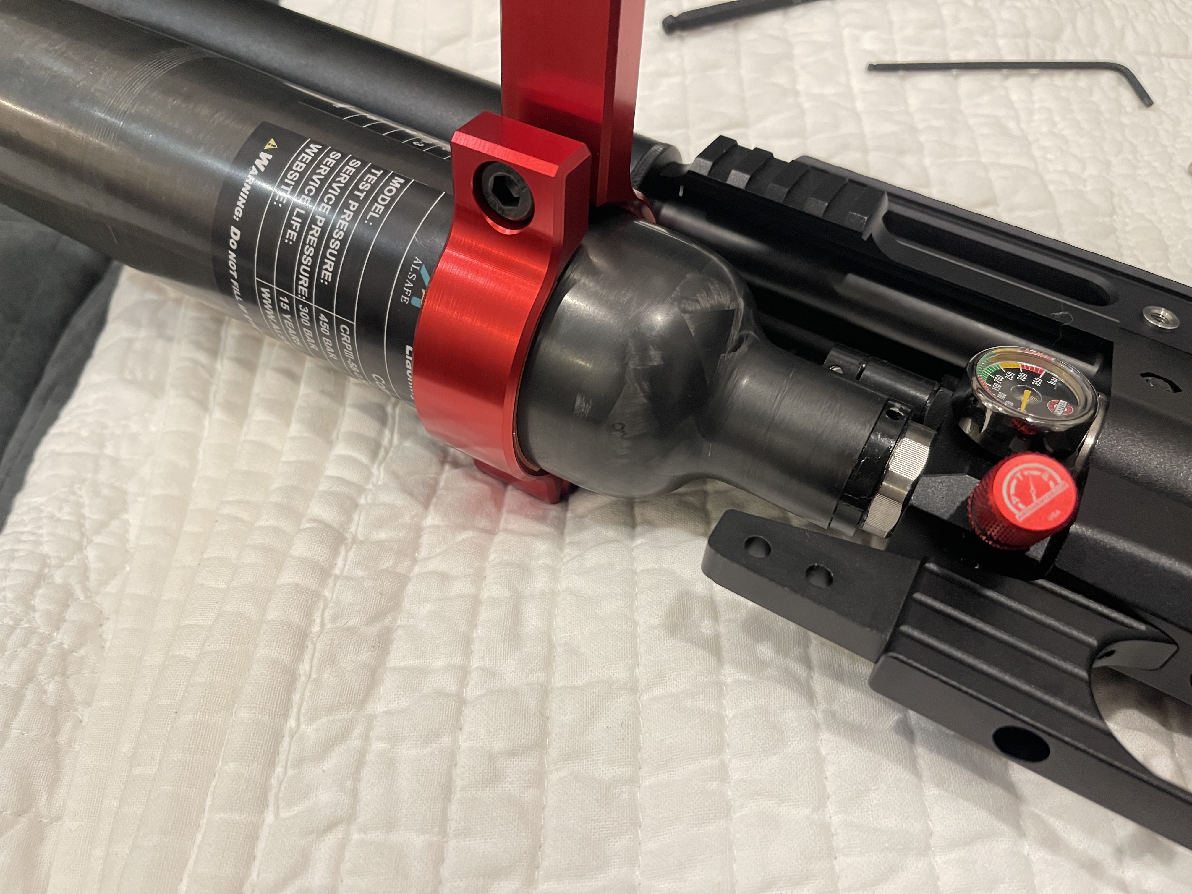

Anyone else still get freaked out dealing with the high pressure air in PCPs? Sometimes I wonder if I picked the wrong hobby or this is something that goes away over time. I just finished a barrel polish on my Rattler. Reassembled the whole thing, screwed the valve back in the CF 580cc tank, applied fresh silicone grease and then screwed the tank back onto the gun. Hooked up a 9L tank and turned on the gas, heart rate jumped a bit when I heard the “click” even though I knew it was coming 😅. Heard a hiss, knew it had a leak and noticed it looked like the silicone grease was blown out from one spot where the bottle valve connects with the gun. Tried hand tightening a bit more and it reduced the sound but it was definitely still there. Dropped from 200 bar to empty in an hour. Okay, used my saber tactical degassing kit to clamp around the tank so I could tighten it even more. Also tightened (with my hand), the second regulator gauge as there was a super slow leak from that prior to performing any work.
While doing so, I can’t help but be concerned about-
  1. Damaging the tank by applying a ‘crushing’ force from clamping around the CF tank.
  2. Over tightening the tank to the gun and causing an issue from the torque.
  3. Damaging the threading on the gauge to the point it turns into a projectile.
In order of the points above, I know these tanks are designed to be really strong but is there any good documentation on what type of external compressing force, or torque they can safely take? #2 Similar thing, we always just say, “hand tight”. What is hand tight, I like having numbers, how many ft/lbs of torque is considered hand tight? #3 again, what are the numbers? I asked AoA a year ago when I had the original leak from the plenum gauge and they said that information wasn’t available.
How do I know I’m not damaging anything or reducing the structural integrity of the device(s)?

The order of failure, I'd think, is this:
1) O-ring(s) - via extrusion
2) Threads
3) Actual wall of HPA container
1 is safe to fail - it would just hiss.
2 would create a projectile out of a tank or a pressure gauge or a bolt or a connector. It is relatively manageable by never pointing threaded things in an unsafe direction.
3 would practically never happen.
Having said all this - pumpers are much safer than PCPs because the volume of air is small (for one shot), and because the valve is often double contained in the pump tube.

The only comment regarding your leak, and this for the most part refers to anything high pressure, you tightened the assembly while under pressure. Big no no. Always de-pressurize, look for root cause and then try again. It’s unlikely anything would blow up but a chard or something could launch into you or something else.
As far as silicone on tank threads and tank O rings, there are two definite schools there. Grease, and no grease. I serviced literally thousands of scuba tanks for a dive shops tanks and customer tanks and every single one had silicone grease on the threads and the O ring had just enough grease to make it shiny. The grease on the O ring was just to prevent the O ring from wrinkling at final seating. Grease on threads was to prevent galvanic corrosion because the valve and aluminum tanks were dissimilar metals. SCBA’s and there valves are typically both aluminum and that’s where galling can occur. As I was posting I contacted a major high pressure air vendor here in Ohio that heavily services the fire service. I asked to speak to their SCBA technician. They typically do not lubricate SCBA cylinders and valve threads. To be clear, this is the threaded portion of valve that screws into the carbon fiber tank, NOT the outlet threads.
Bare aluminum on bare aluminum can cause galling. The best way to prevent that is to loosen or tighten the valve very slowly until it is completely loose. Which should occur within a half turn or so. And that pertains to straight threads which is all I ever saw on SCBA’s. The technician added that IF they do use a lubricant it is typically Krytox or equivalent. And it is used very sparingly.
Tapered threads on the other are a completely different matter. Galling on stainless to stainless can be a challenge. I worked with assemblies for the oil patch industry and assembled and disassembled thousands of assemblies and SS on SS disassembly sucked. But we typically do not see that on airguns.
So how you choose to lubricate or not lubricate will depend on the school you ascribe to. I have never had any issues with either process. YMMV.
