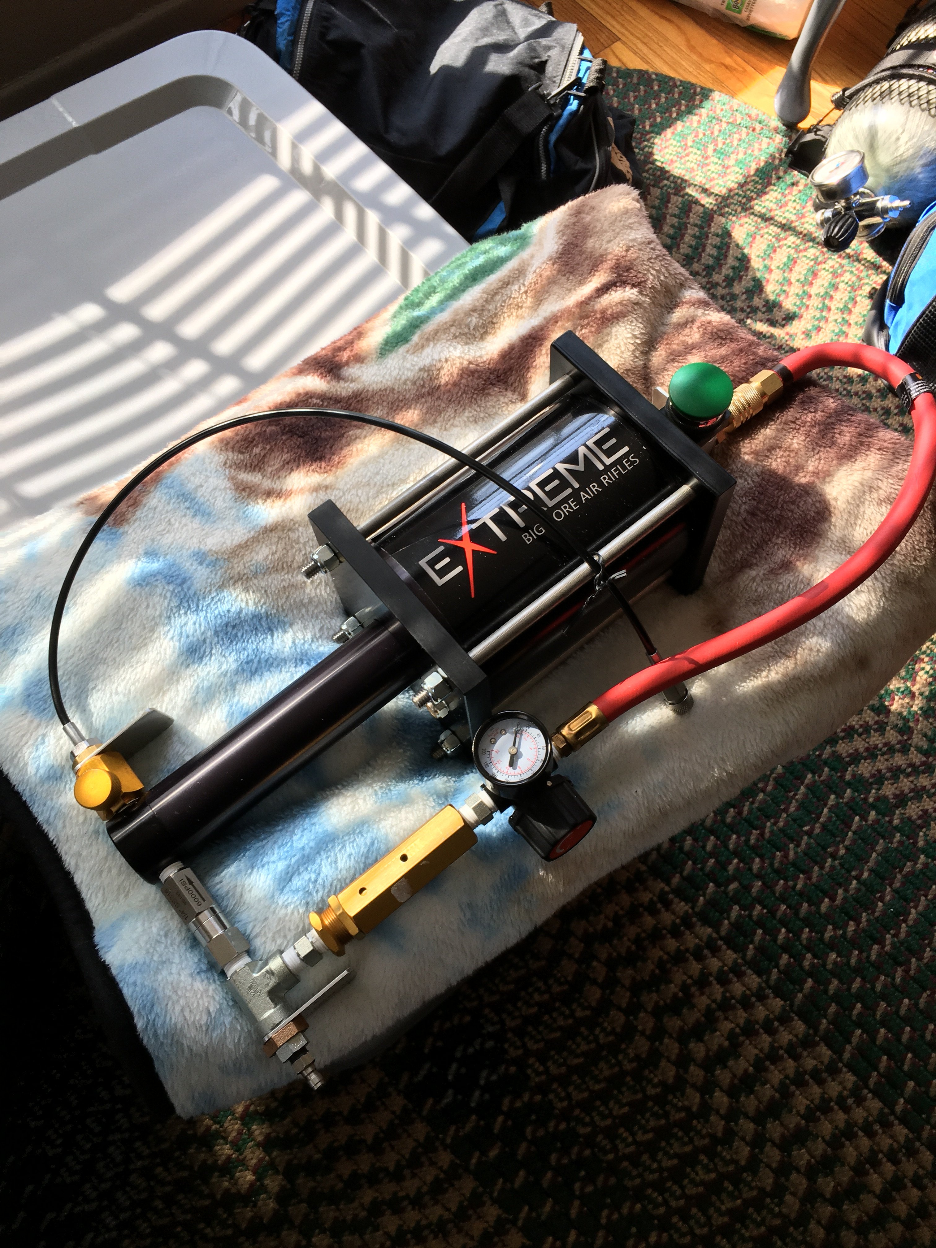

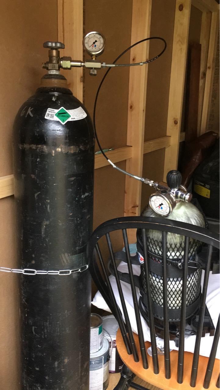

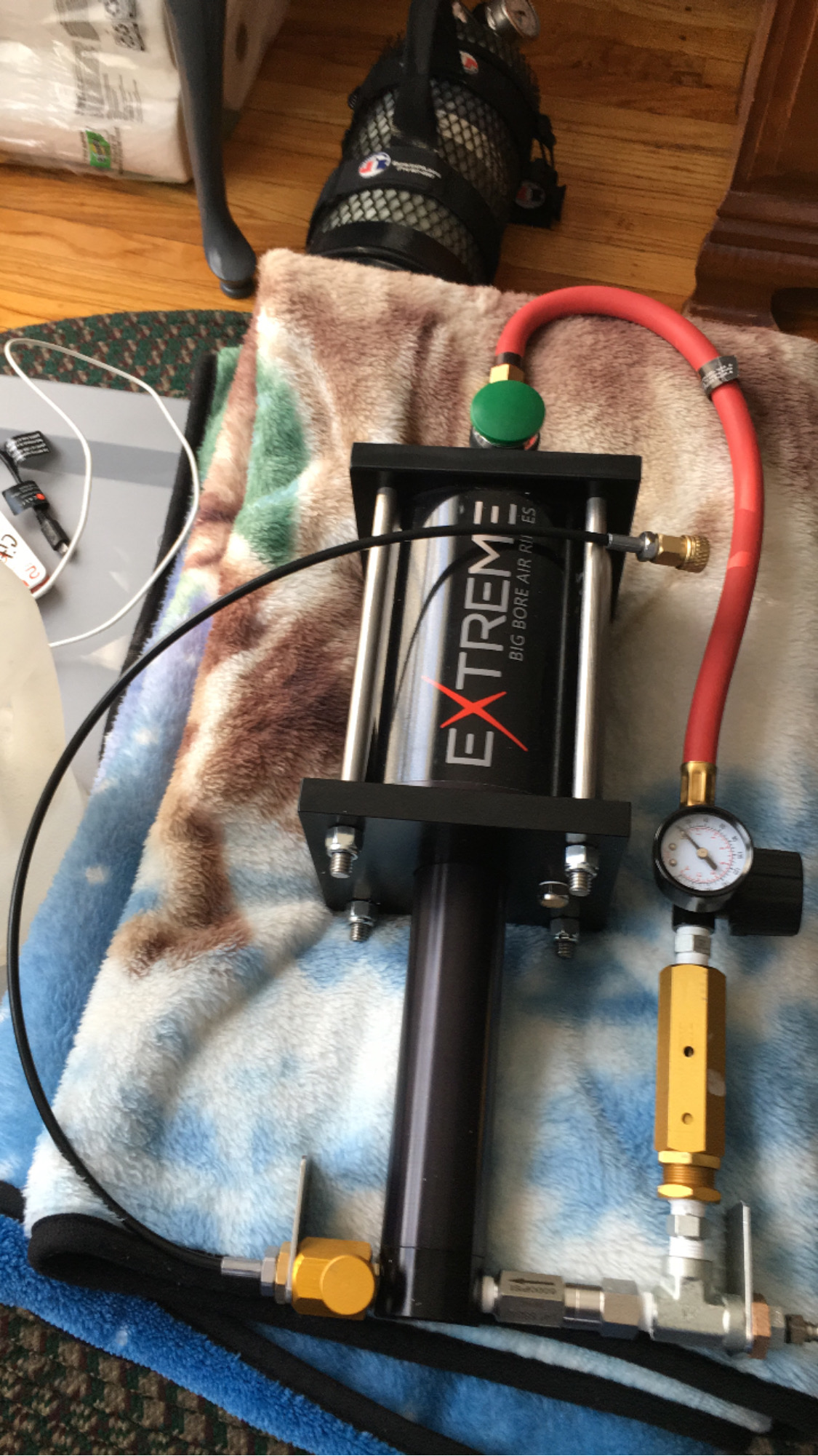

I use an Extreme Booster Pump from Extreme Big Bore in combination with a couple Great White 97 cu ft carbon fibers to help drain my steel N2 cylinder down low.I lease a 494 cu ft steel Nitrogen cylinder from Airgas.The tank lease costs me bout $127 per year and then fresh tanks are about $137.Given the fact that I am mostly hunting and pest controlling the steel tank lasts me YEARS in between swaps now that I have that booster pump.I can drain the steel down to 1500 psi or so ,instead of having to swap it out at 3000 psi, like I used to before the booster pump.
