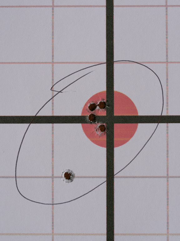

Right now back at the original 120 Bar tune, I'm having trouble with that one consistent flier that lands from 1/2" to an inch or more from a very tight 4 shot group. It could be me but it is very consistent...almost every group. It's driving me nuts.
50 yards/ no wind/ 38.9 gr NSA@ 880fps
Curious if anyone has any opinion on all of this.

This picture is the most frustrating part of trying to shoot bullets out of a pellet gun. This picture is also better than what most guys see when they decide to jump on the bandwagon. The best slug advice I can give is don’t trust anything you see a guy post online. Video or words. When it comes to slugs, the guy who appears to be walking on water today will more than likely be swimming for his life next week when his gun won’t do what it did 5 days ago. Shooting slugs is a hobby within a hobby. Chasing them almost never ends. My goal is to have a grab and go slug gun. The Impact has all the tools to get you there but……all those tools are the fly in the ointment for a rock solid consistent gun. The guns ultra adjustability is what hurts it. One thing is for sure. Every Impact owner should have bloodwork done after 6 months to check the level of lead in his blood.
