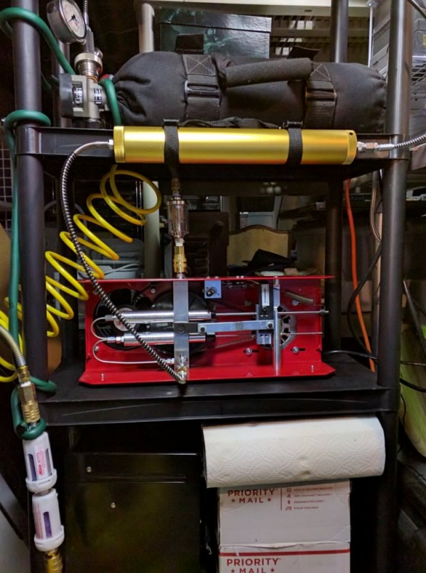

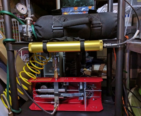

Here it is in place.
rnabholz where did you get that nice bag you have your tank in. I have searched everywhere and can not find one. You have a nice setup there shouldn't the filter be up and down though and not sideways for best filtering.
"rnabholz"Thanks Josparky.
I made the bag myself. The handle is a slightly modified Scuba tank carrying handle.
As far as the position of the filter goes, using it with a Shoebox, and the accompanying slow fill rate, I haven't seen any issues with moisture pooling or channeling.
If your compressor moves air faster you might want it mounted differently.
