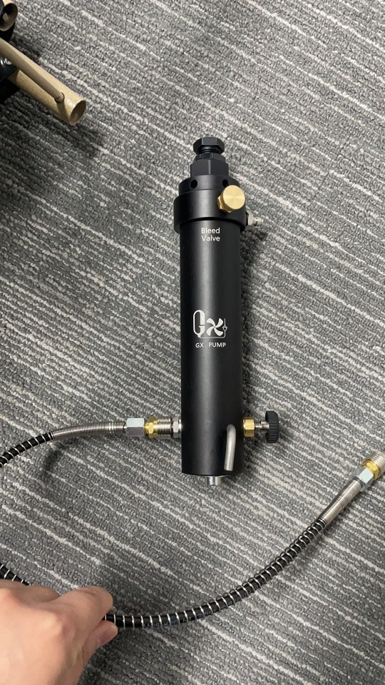

Do you have any info on what this is?
It is a 40mpa filter that GX has coming out soon.
I'll chat with them tonight to get a better ETA on them. But they have been heavily tested by GX
It has dual bleed valves and beads inside that can be replaced. Magnetic to stick to the side of your compressor and other features.
OK, sounds good. If they are all that I’ll be picking up one of those.
