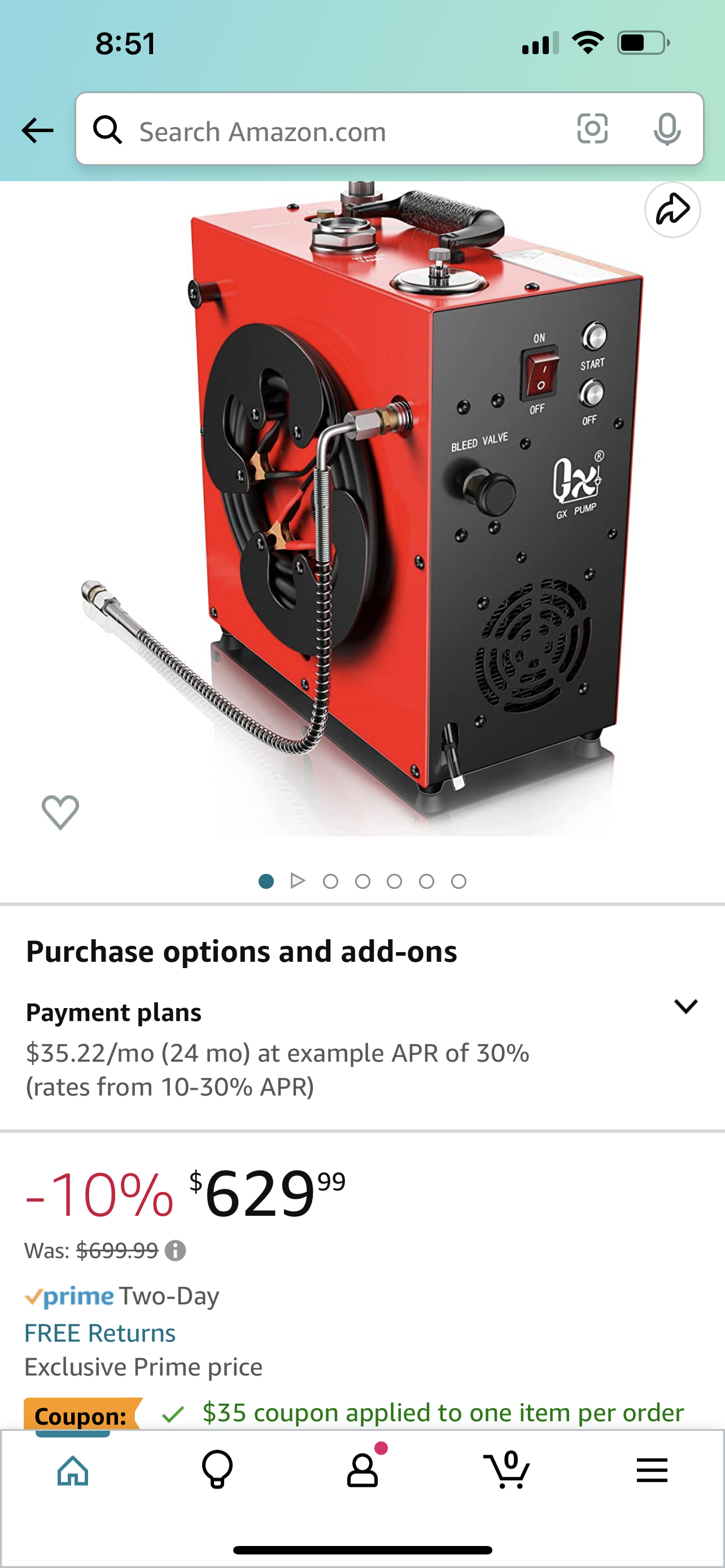

I swear the price discriminate based off some made-up algorithms. $629 plus $35 off coupon
