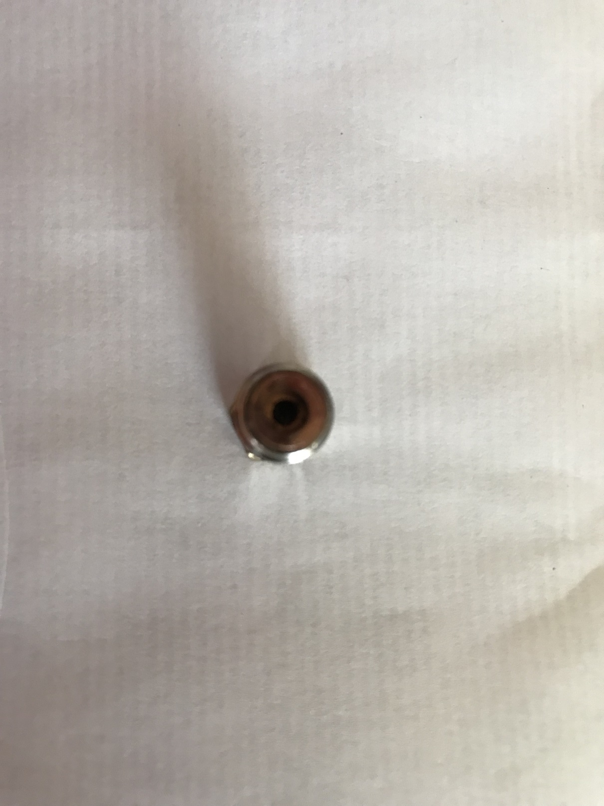

I bought mine from Pyramyd Air and it was the "Air Venturi" branded model. I was filling my guns the other day and heard this loud bang and the compressor lost all its pressure. I emailed Hill (no response yet) but called PA and then Air Venturi. I got a support person at AV and we walked through the problem and it appears that one of the 5k burst disks blew out. My compressor has 11 hours on it. I went from filling my EVOL to then my Huben - which I set at the max 310. It blew out on the Huben fill. AV is sending me 2 burst disks and I order a couple more from Amazon (no one had one available locally at all). Very happy with AVs support. The support person stayed on the line while we took the burst disks out and looked at them. Here's what it looks like when it blows:

@Ca_Varminter - that's exactly how I sent them the information. Still waiting, but since AV seems to have taken the 1st level of support, no harm - no foul!

Mine goes to 310 on the version of software I have. But my alpha filter lost a gasket and I took it out of the fill chain waiting for the repair kit from Joe B and I did notice that my guns filled a lot quicker (didn't have to pressure up the 2nd filter) and the 5k burst disk went after I filled my EVOL to 260 and then went to the Huben at 310. It blew while filling the Huben. I will get the specialized grease on Monday and will rebuild the alpha filter and I will also get the 5K burst disks from Amazon - the another pad from Air Venturi later next week (spares now).
