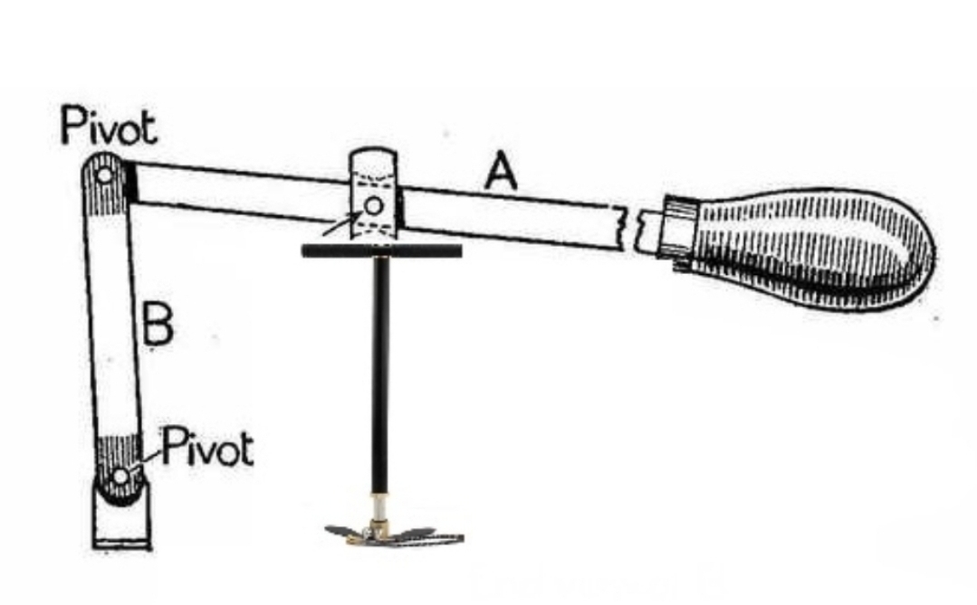

Next step, a lever for leverage on each stroke, mount the base of the pump and then decrease your work needed ten fold!
-Matt
Where would the lever mount? Maybe foot pump it?
The pump would need to be stationary/mounted or heavily weighed down to remove your body weight from the equation, then the lever would attach to the handle and ideally a fixed position above probably some where in the middle of the stroke, I am not a lever expert, maybe 1/4 or 1/3 from bottom may be more favorable for leverage on the down stroke as that is where the leverage is needed, opposed to in the middle of the stroke which would be best for both assistance in both directions.
Wherever the lever is fixed to, it would have to be able to handle the load this leverage creates, as well as the lever, which is beyond my guess without fully diving in with schematics ect.
-Matt
Here is a simple picture of a lever pump, just be aware that you will have a significantly longer stroke.
Bottom B pivot bolted to ground as well as the bottom of pump feet. Top of pump handle bolted to pivot at A. Depending on how long the lever arm is will determine how hard or easily it pumps. However it will most likely be a lever up over your head with your arms extended fully.
Allen
Allen
Thanks for the diagram
