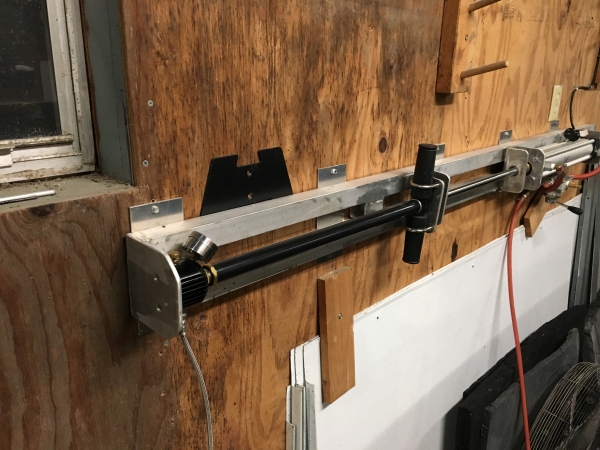

I have a bad ass wildcat 22cal and shot about 40 to 60 pellets a week a clip each day. I have a shop compressor and right now have a Benjamin pump with a pneumatic cylinder that makes pumping easy but I don't think the Benjamin pump will last the distance so I have 2 options buy a hill pump or the booster. But which give me the most longjevity with out problems? I am leaning towards the booster so that the benajmin will be a back up. I don't know about ether can the hill pump be used in the horizontal position ? We have a bunch of overtime coming up so the wife wont get cranky spending money. Hill or booster owners any bad points or anyone for that matter thanks

Just a thought, in that picture , turn the pump over so the bleeder is on the bottom side as that's where the water exits.
