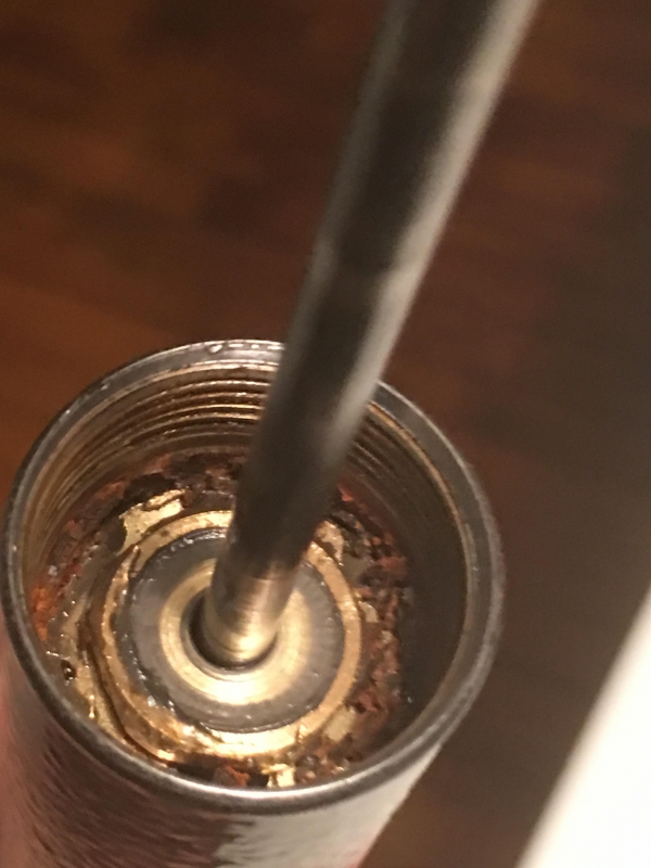

Yes, I already ordered a 74 omega tank .. because my hand pump needs maintenance, I just opened and didn't like what I found
Not a problem, it is super easy to do I just recently had to rebuild my Mk4 when it stopped working so any questions just ask. I do have one tip for you. Make sure to lubricate the small (green) high pressure o ring with silicone oil NOT silicone grease. I used the Hill grease on every other o ring and it worked fine but not on the high pressure o ring. It made the pump VERY hard to operate but after cleaning and re lubing the green o ring with silicone oil it works like new. It took me a while to figure this out and had me scratching my head. I think the grease is just too heavy for that area and causes too much friction. Good luck!
