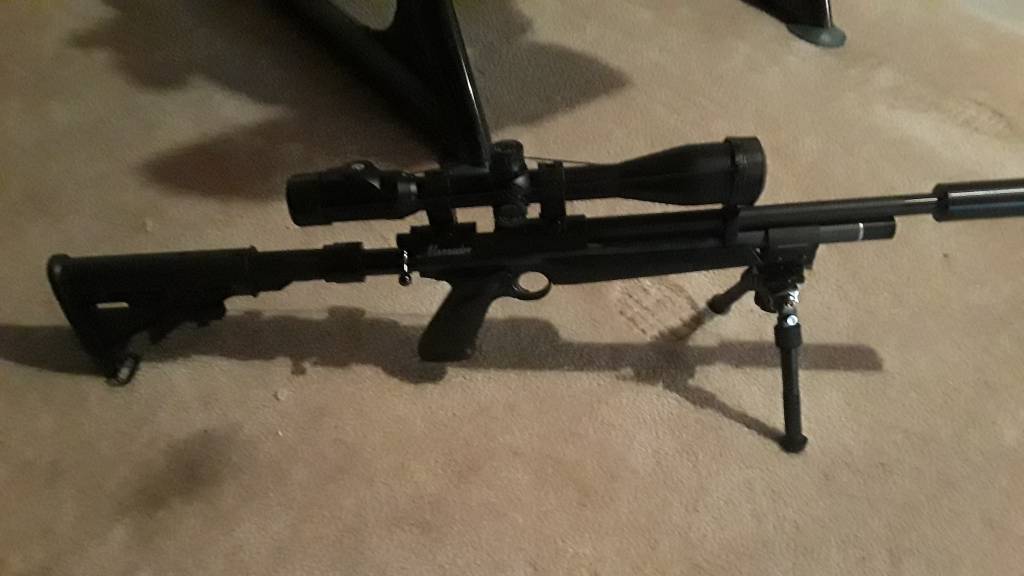

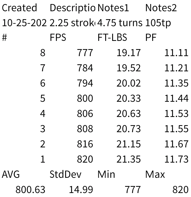

This is my Prod after 105 TP
Im a huge fan of Hill parts. I put the full kit into one p-rod with a huma reg. Here is the first time shooting it. 18.59 gr hunter extremes. Still some more tuning to do but with Tim’s kit and peek striker its easy to get what you want, be it higher power or shot count.
