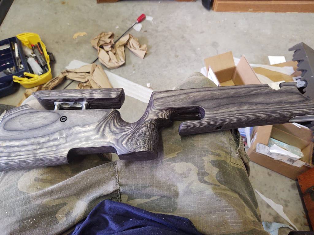

Did you use a hole saw or free hand it I'd like to get my stock fitted one day also
I sought the services of my machinist and a carpenter.
The machinist made a mandrel of a bit less dia than the plenum. The carpenter initially made a hole of the dia of mandrel. Then enlarged the straight hole very gradually.
It took time and patience but the end result is great.
In fact I had to be extremely conscious as in case I ruin the stock I could not import one more.
