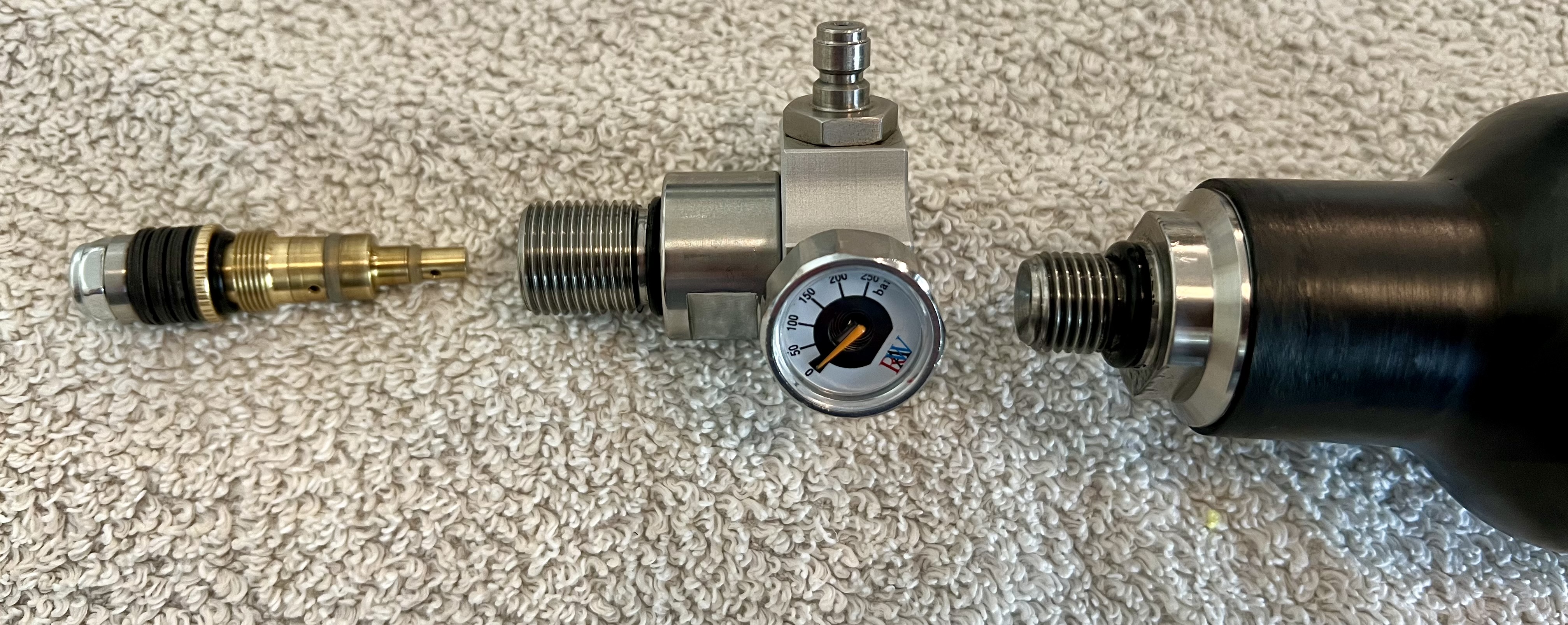

Problem is the bottle will fill and hold air but the air is NOT making it into the regulator or to the valve. The gauge shows pressure.

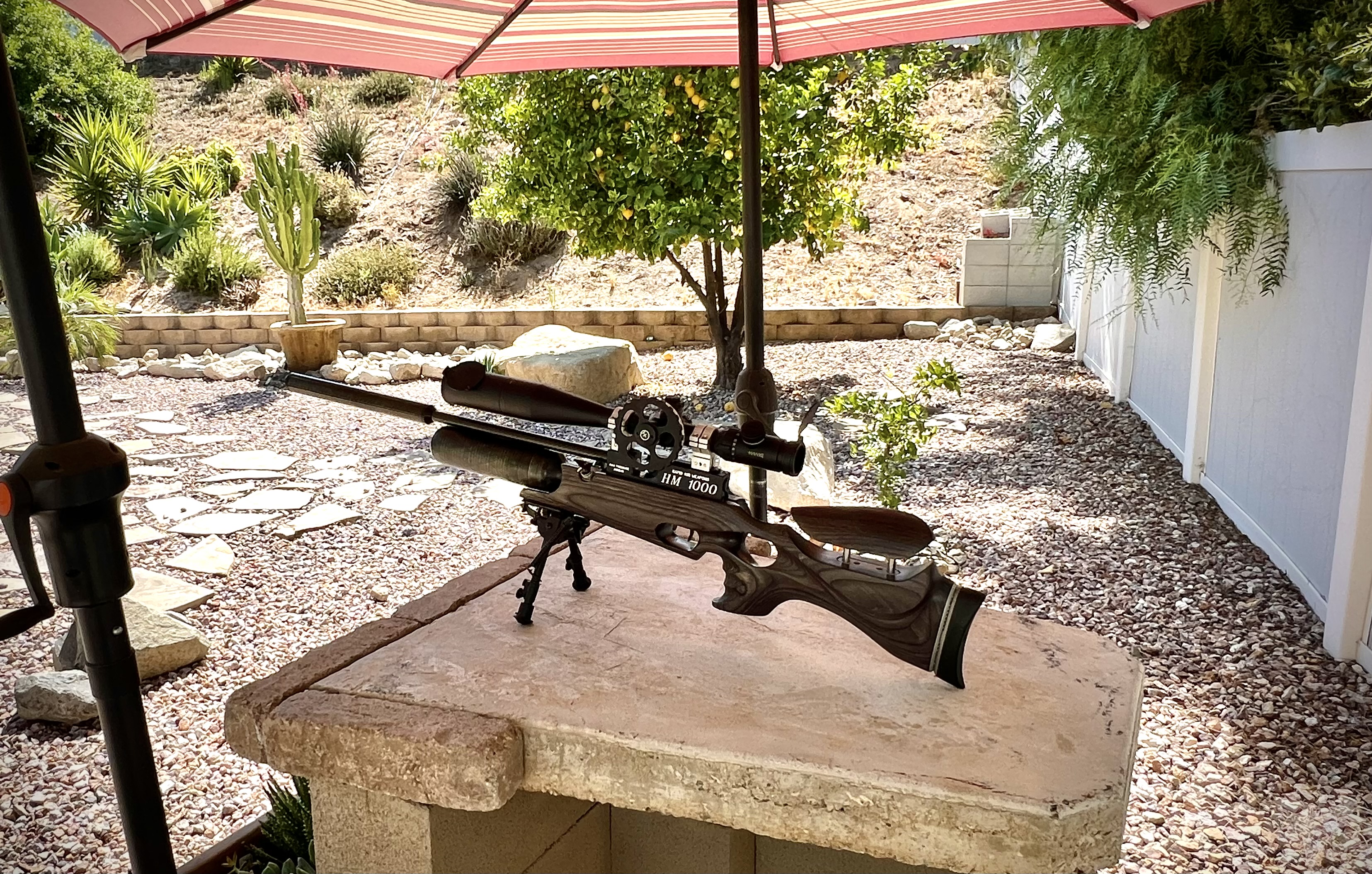

It held over night and got a chance to do some shooting this afternoon. I have a nice selection of accurate field target rifles and this thing is right there with them. The trigger is awesome.
I don’t know if the carbon fiber shroud does anything for the accuracy but if I had one knock it would be the noise. It has much more of a pop than my other rifles of similar power. It’s not loud per say, still easily backyard friendly just not mouse quite like my others.
The stock is incredibly comfortable. I can not wait to get this out on the ft course.
