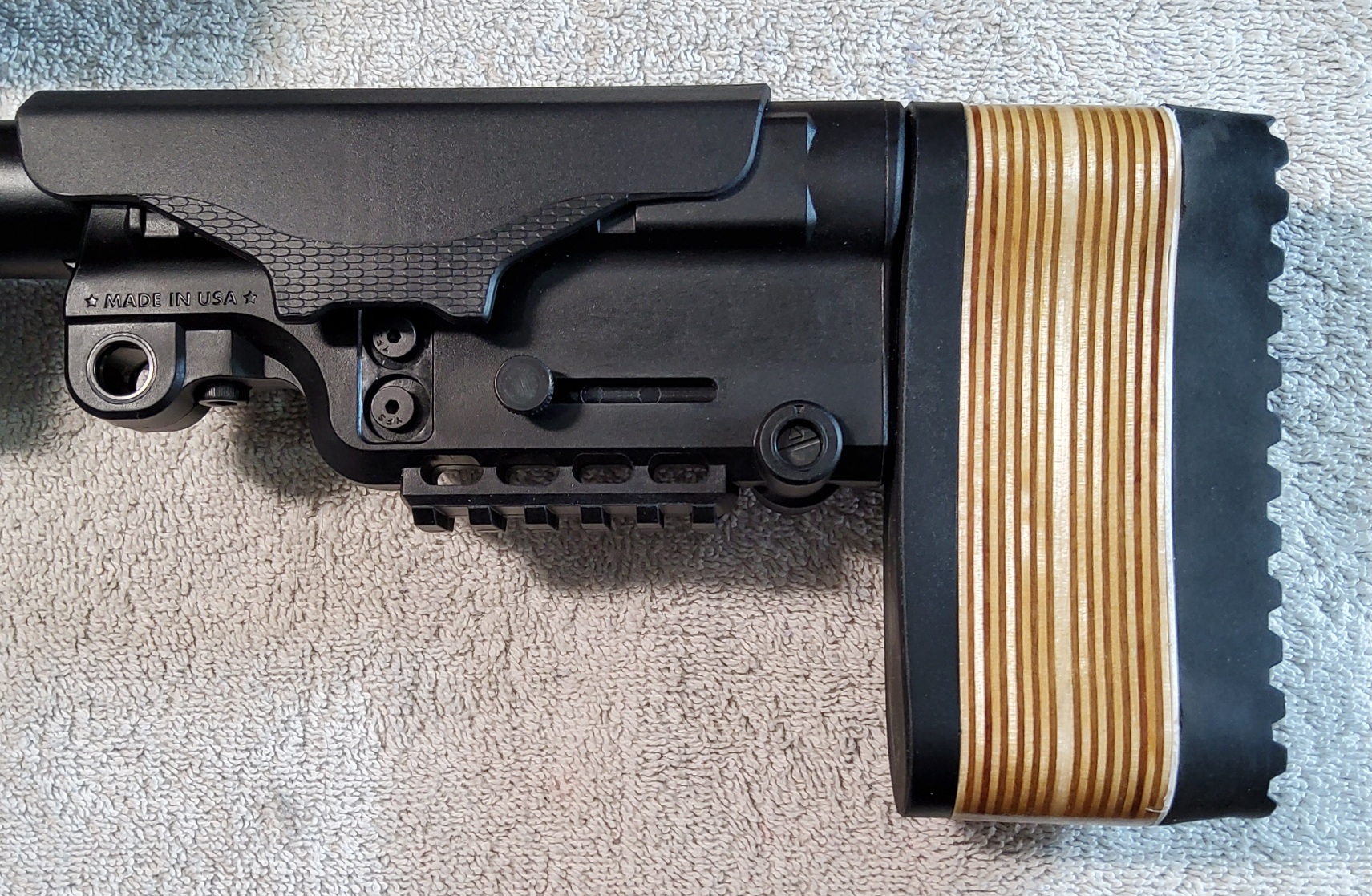

The spacer I made (picture attached) gives me a 13.5 to 15 inch adjustment range for the LOP.

I have a .25 and a .30 HM1000X and consider them to be among the best air rifles on the market! I replaced the tactical stock on the .25 with a Masterpiece Arms rig and love it. I agree that the grip is too small on the stock rig. I bought the .30 with the laminated stock thinking I just might not like it but actually do like it very much. Welcome to R.A.W. - you're going to love being here!

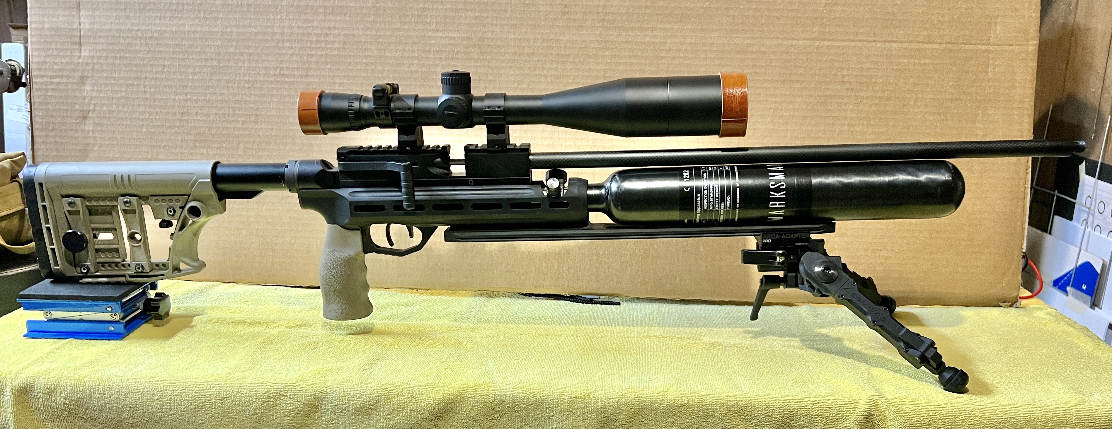

Have you tried filling to 250 bar if it's newer raw id fill to 3500 psi would gain you few more as long as the bottle pressure is 250 working bar pressure
So far I agree with everything but the trigger. Mine was set to 4-5 ounces and is just the way I like it for bench target shooting. I went with the 700cc bottle and a few other additions. I also use a March High Master target scope.
I have the same Marksman 700cc, 300 bar bottle.
What pressure are you running your HM1000x at rsfrid?
My Users Manuel says 230 bar for the 480cc bottle.
Congratulations! Enjoy shooting it! Like Airgunman said above...I fill mine to 250 bar. I detuned mine to shoot 18gr pellets @ 970fps and NSA 17.5gr slugs @ 950fps and get 70-80 shots, mine is a .22 also.
I'm planing on trying slugs as an experiment.
I've a couple of PCPs tuned to 16 & 18 grain pellets for sub-60 yard work.
Was thinking of keeping the HM1000x tuned for heavier projectiles and try some 100 yards bench shooting.
