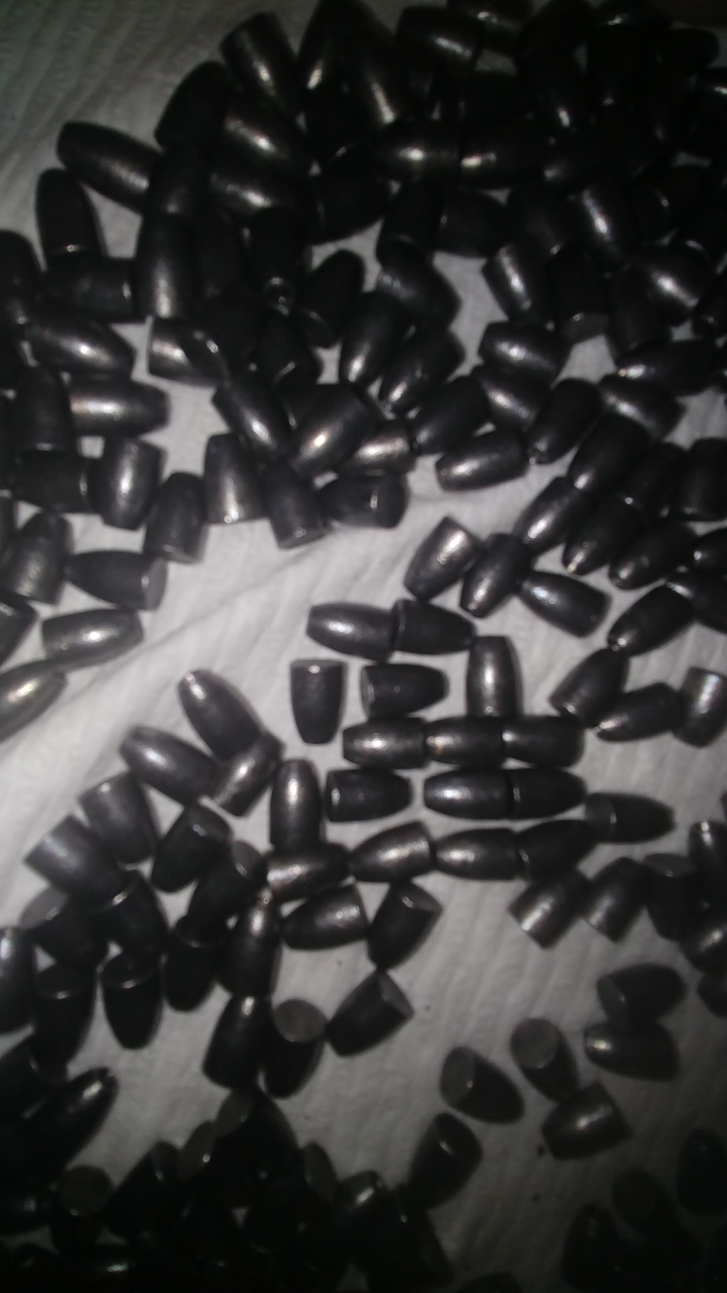

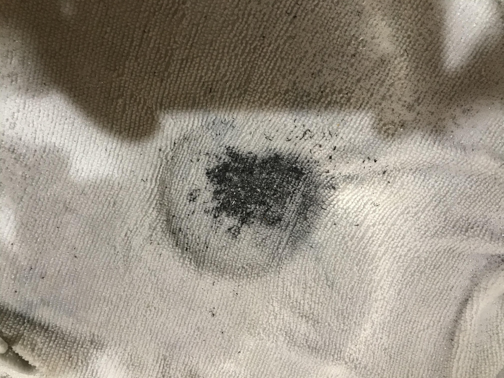

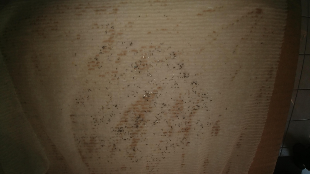

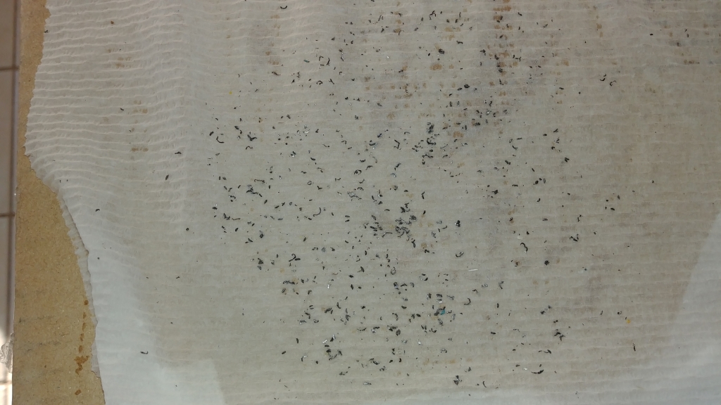

So I grabbed a Tin , I noticed they had black foam instead of white , I eagerly removed foam , and saw the slugs with a ton of lube on them , They were also very dark , My thought was maybe the oil they used ? or pure lead ? , I then grabbed a few they felt extremely gritty , I looked at my fingers and saw lead , I then decided to dump out 2 small tins so like 600 slugs , I grabbed some hot water and dawn and washed and rinsed , I saw a ton of lead , I was like ??? . I then poured a bit of the blackish water and filings on a few paper towels , I then put them out to air dry then I want to weigh and check constantly of sizes and weight , But I want to show people here what came out of mine geeze this isnt all of it probably 1 tin worth most went down drain ,
These were dirtiest slugs I ever bought so far , I am glad I caught it , I have good guns and dont want this stuff inside my PCP actions or bolts or in my transfer port and entering

unwashed
rinsed
lead flakes pellets were coated in oil and this , I dont want this in my guns
and like dirty oil
maybe HN will respond and send me new ones and swap these to see just how bad mine are , I will test the 27 gr but I wont touch other grains yet 😥
Not for nothing I can cast 1000 slugs and resize them here and no flakes I do not have to clean ammo I make , Imagine with hollowpoints all shavings causing all to fly different and yes little things add up at long range ,

That dark color, combined with a "gritty" nature, makes me think they may have tumbled them in molly lube. It is not uncommon in the firearms industry for bullets to be coated molybdenum disulfide, and some people swear by it for that application, however I believe it is quite rare in the airgun industry. Maybe someone more seasoned than I could comment on this?
The oil is most likely a remnant of the bulk manufacturing process... lead is sticky, so they use oil to keep it from sticking in the presses. JSB does also... BUT, they are supposed to clean it up as best as possible by rolling the pellets/slugs in thin towels. That amount of free lead shavings means they most likely rushed em out the door. Not pretty.
I believe same it is oil to lube dies it should be cleaned , it was dark , and it is not Moly , I know about this I am a long range shooter it is a bulk oil and yes cleaning must have been skipped they showed rows of woman hand picking , they were not handling these their hands were not like black and with shards of lead in their hands I going to show HN and see what they say
Update I did show HN this thread in an email and sent pics and asked if they wanted to swap my ammo out with others back to them to see what we getting here in USA , No answer yet , In video he did tell AEAC they inspect all and they do track my lot so if any bad ones they can fix issues , NO answer yet from them , it has been 24 hrs
How do the back of them look up close? Did the lead pieces come off the base of the slugs, leaving small imperfections in the bases possibly? Just a thought.
Does look like they were never cleaned in the photos and your description of what you cleaned off them.

I spoke to a man from H&N and I gave him info from the tins and the Production manager and the QC manager said that amount of shavings is totally normal and the advise up not to clean off the special accuracy lube , Thank you H&N for checking into this and clearing it up for us . and thank you for getting back to me so quickly HN .

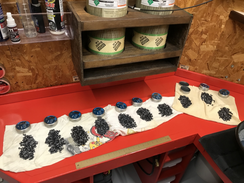

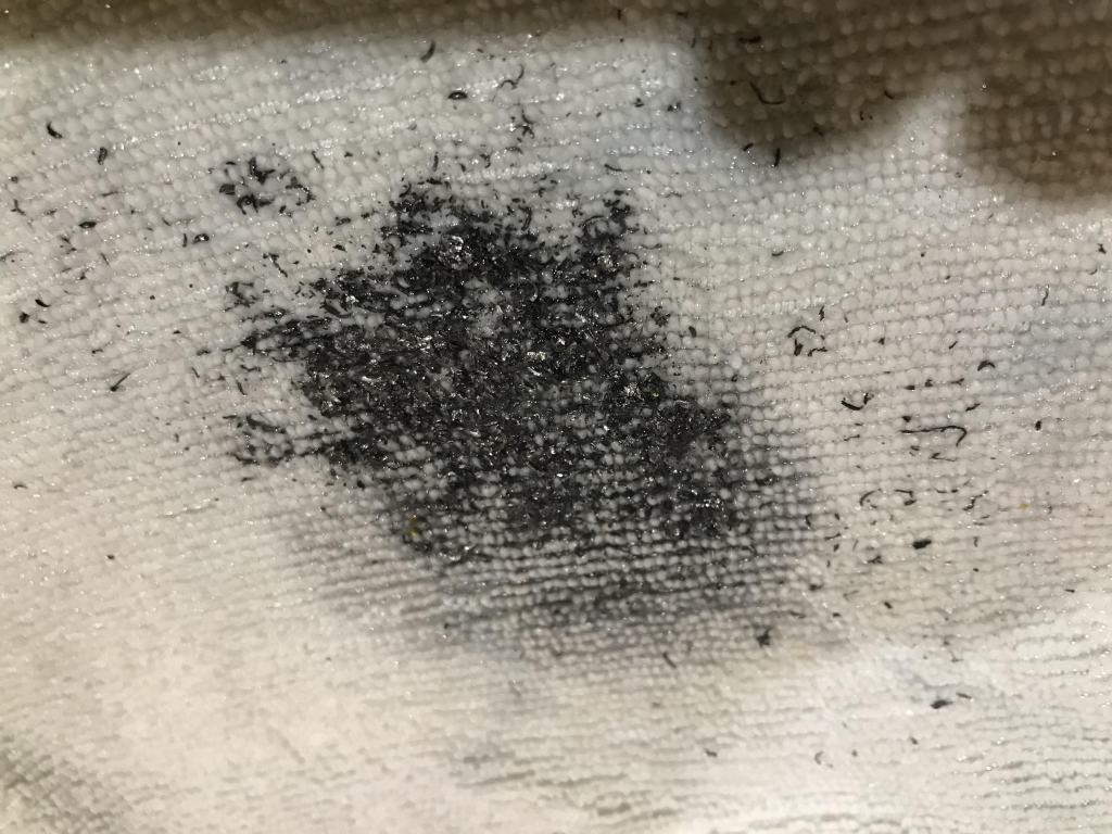

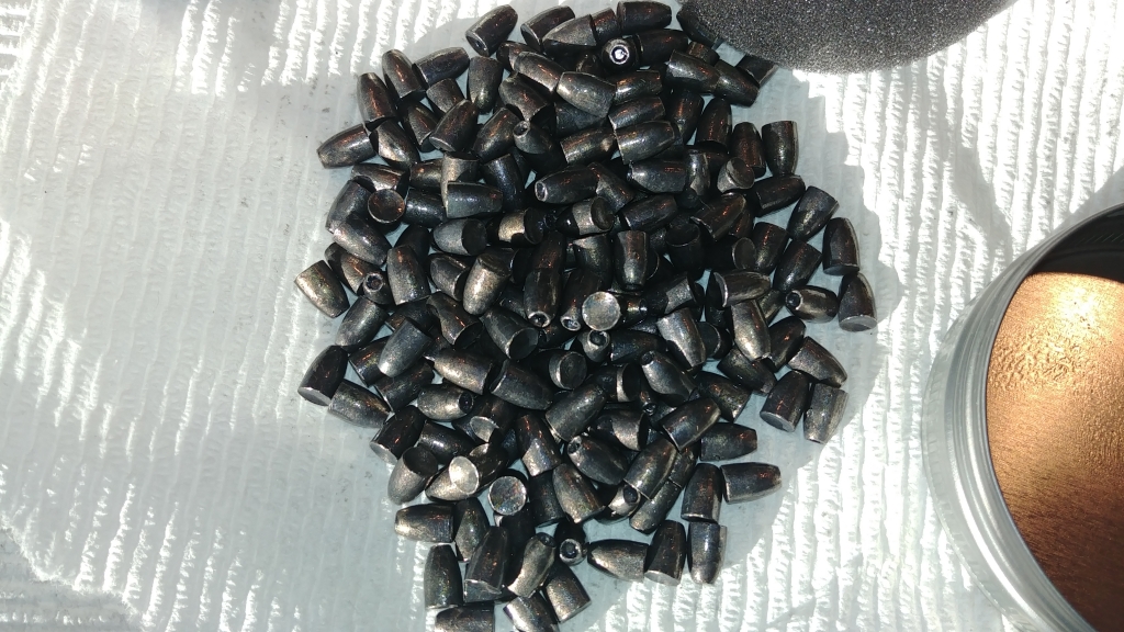

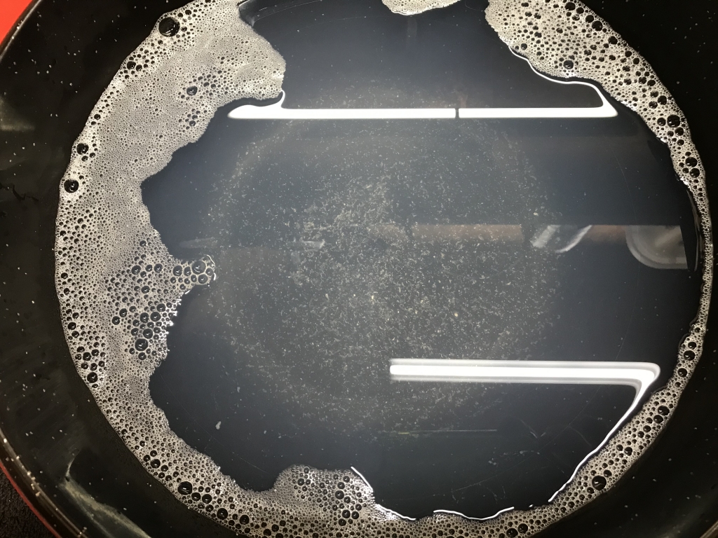

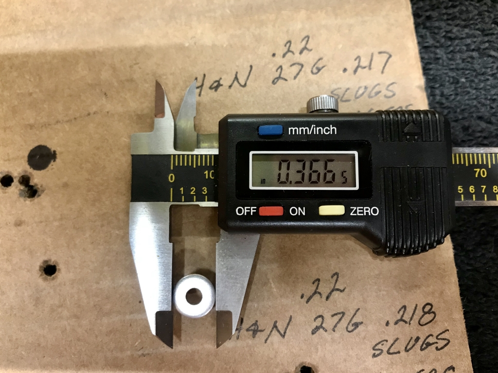

I had 2000 of these slugs ordered when I read this, 27g in .217, 27g in .218, and 30g in .217. Mine looked the same way. I washed all 10 tins in dawn and hot water and re-lubed them in slick 50 supercharged. I have not shot any yet but I took a few picks. I personally hope these work good for me because the price is so much better. You can buy 3 and get the 4th free from PA and there are 200 per instead of 100. I did use calipers on them and they were very consistent. .217’s were .217 and .218’s were .218. I can wash them if the price is right, lol. If anyone is interested I can post results later but might be a while. Gun is tuned for NSA 23g right now at 122 bar, need to shoot them 1st. Also I lube all my pellets and slugs with same stuff just to keep cleaning down, in my opinion it helps for that. The pics are of the cleaning bowl and strained through a towel after all 10 tins.

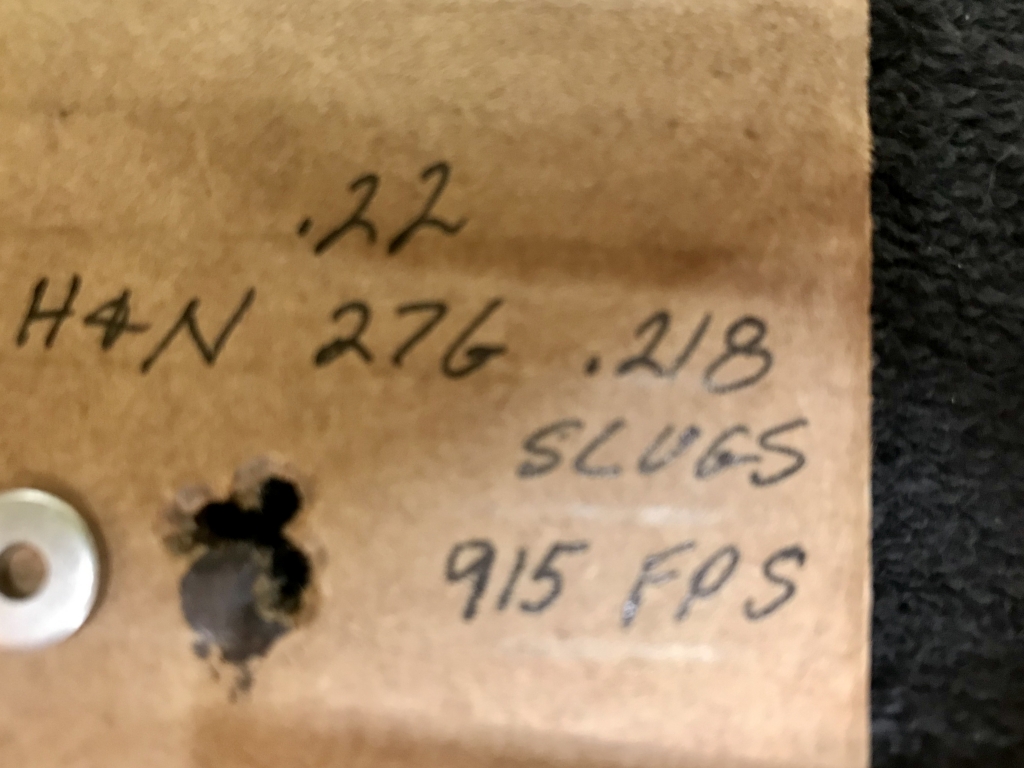

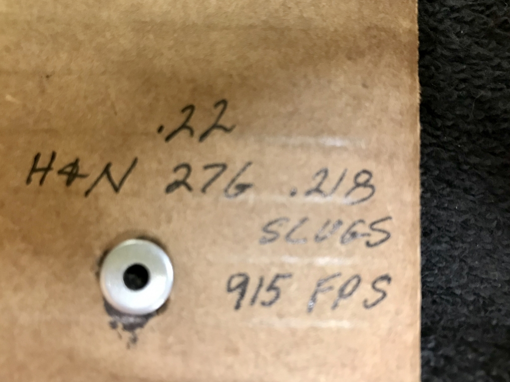

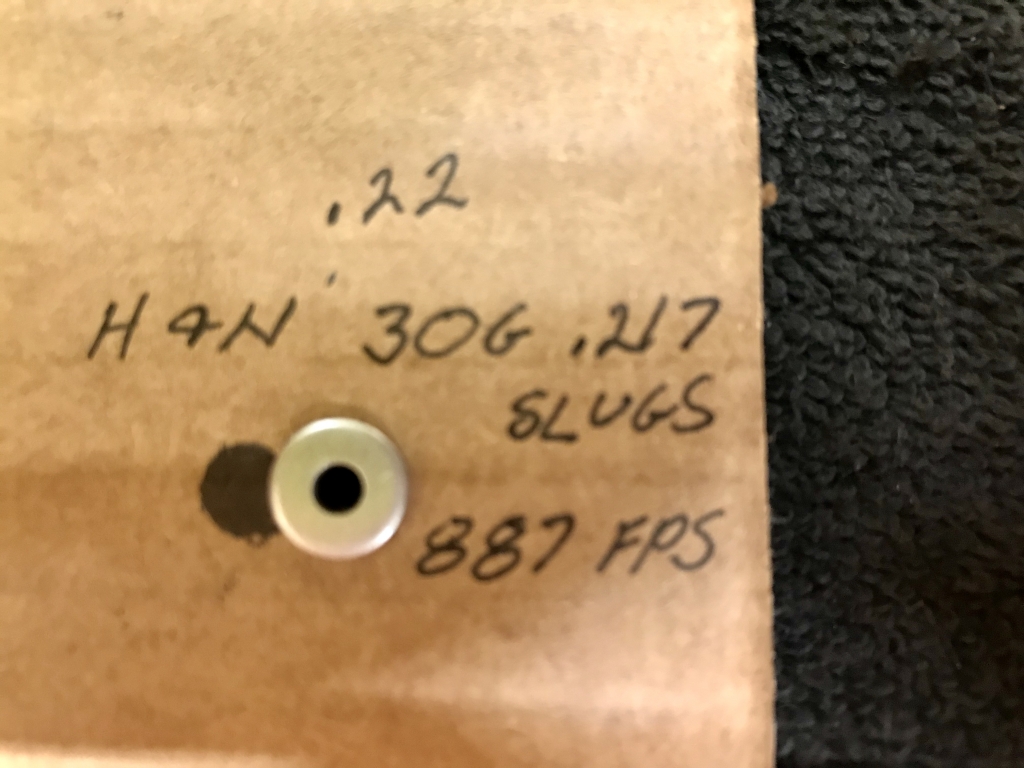

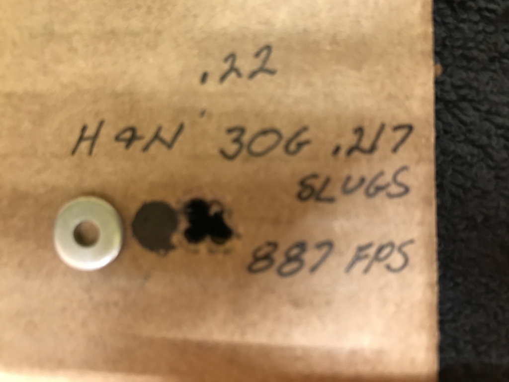

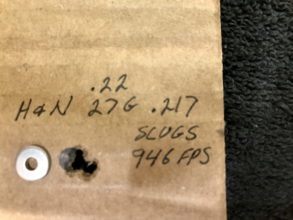

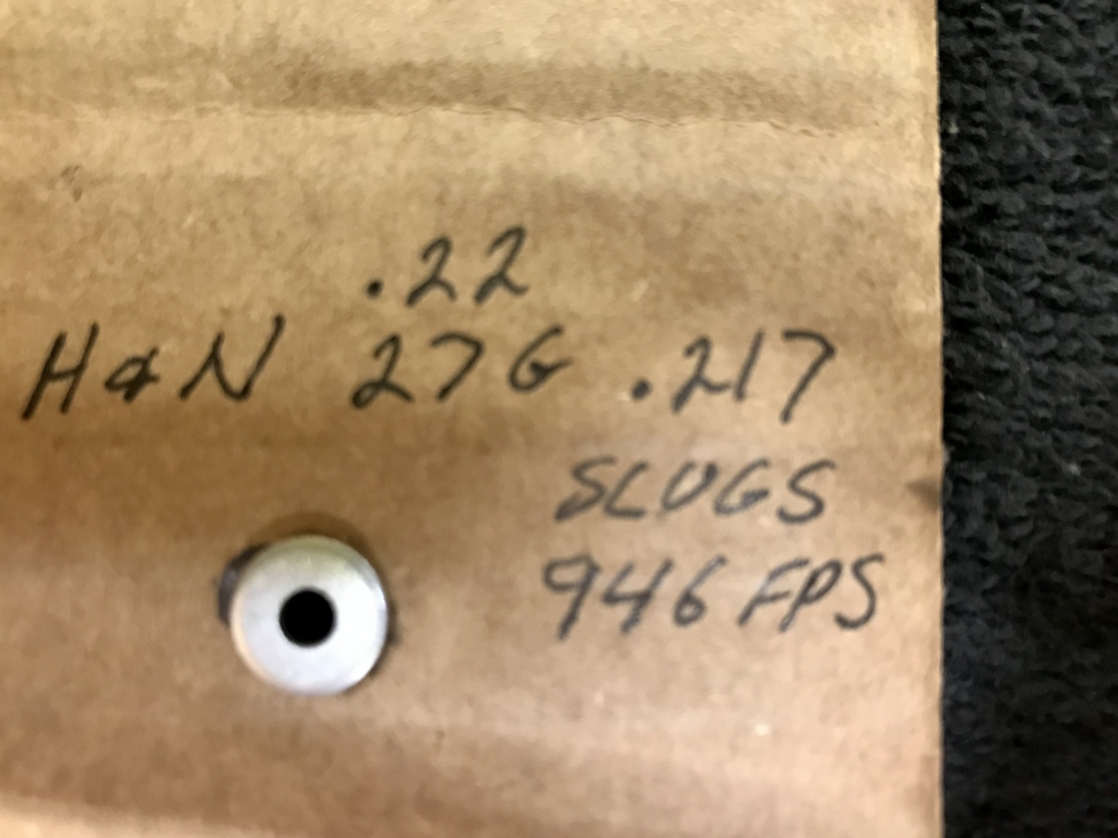

So I wanted to update. I will also start another thread since there is so little info out there on the H&N slugs. Look for H&N 27g & 30g testing. I started out today by going out to the farm and shooting starlings and to use up my supply of 23g slugs. It got so windy the 23g were unreliable 18mph with 33mph gusts. They dont shoot all that great out of my gun anyway, good enough to shoot starlings if it is fairly calm but not ethical in that wind. Anyway since I had used up all my heavier slugs it was time to break out the new H&Ns. A recap 27g .217, 27g .218, 30g .217. I used the 27g .217`s at my work bench to set my starting point. I went to 963 fps then used the valve stop to back it down to 946. I set up at 30 yds. I then shot 5 or 6 shots to get the scope close. Next I shot a 5-shot group for all 3 sizes. I never touched any adjustments just shot the 3 groups. To say the least I will be washing more of these slugs! Here are the pics of my results.
