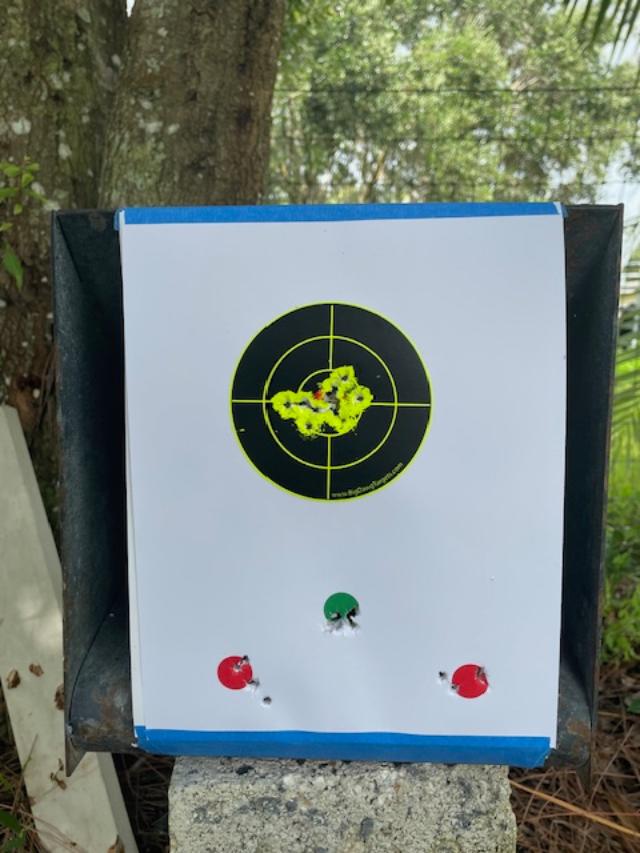

Got a tropical depression in the area and the wild was blowing pretty good today. I got bored and wanted to shoot so I grabbed my M3 Impact .22 and sent a couple mag down range 65yards. Wind was mostly at my back and to the left about 15-20mph.
Those are great groups for 65 yards in a high wind. I'm guessing the center of your reticle was not on the paper.

Thanks, the hold wasn't that extreme I'm thinking because of the wind direction (mostly behind me) and a little from my left.

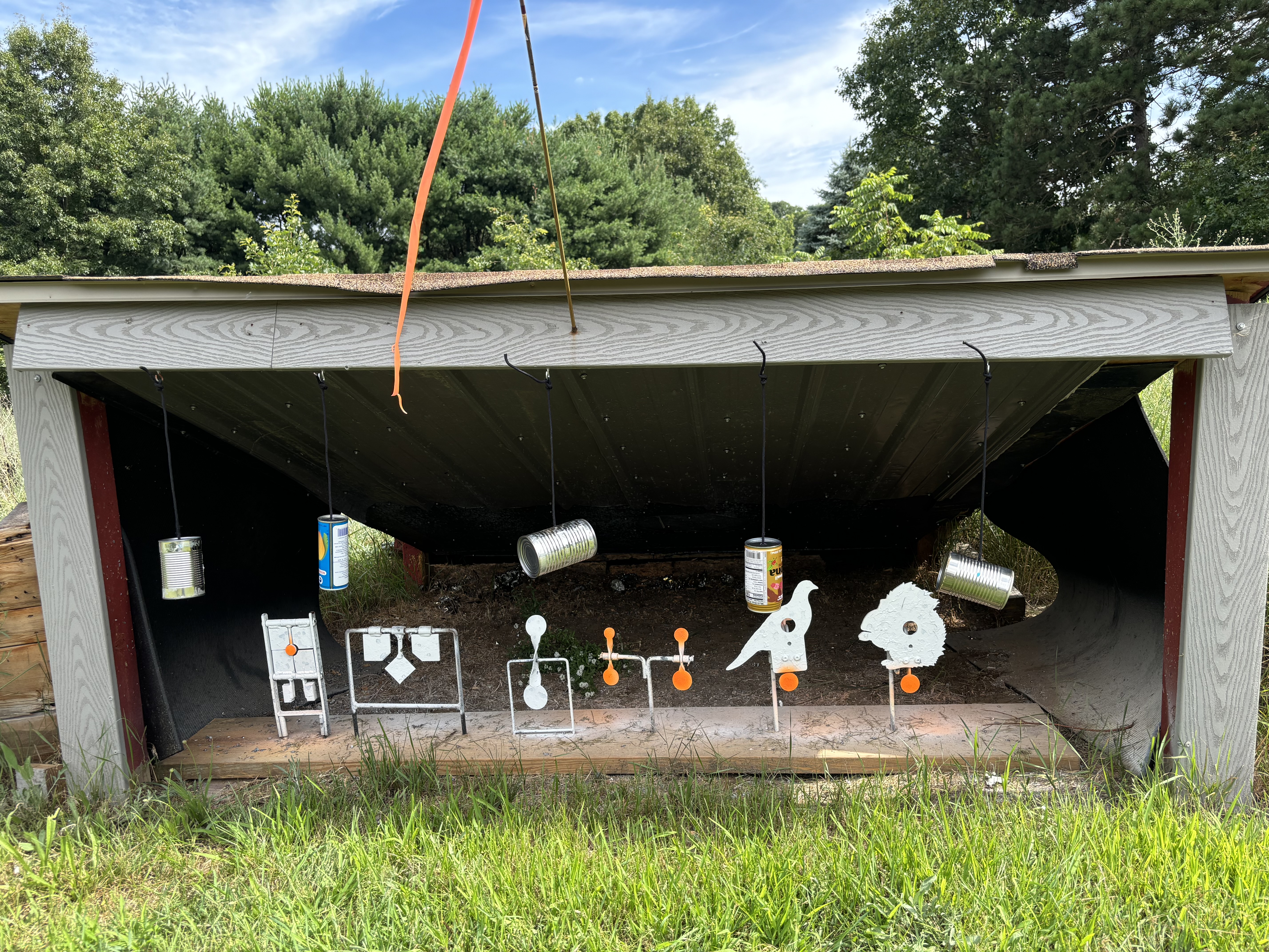

Today i was sitting and hitting the corrugated metal plates at 130 and some yards, and it looked pretty damn good, so i figured i put up a few of my 2" targets down there and my camera.
Needless to say that recording will not get shared, CUZ aside for 1 lucky #1 shot on target number 3 it was generally just a mess and nothing like i saw a few minutes earlier.
Changed to 100 yards and suddenly hitting the 2" targets was much easier, it is incredible how much a measly 30 yards in the long end can mess things up.
