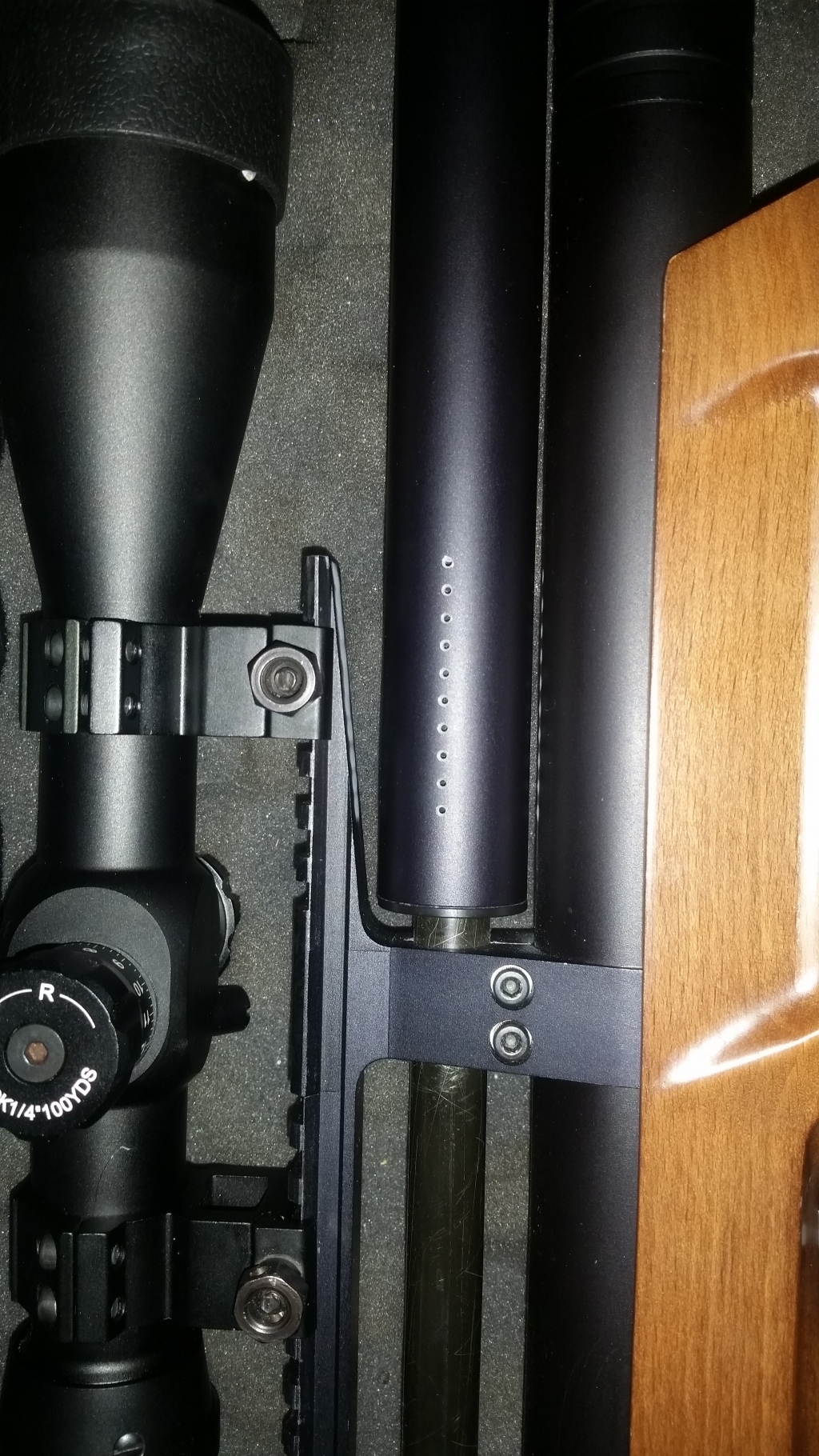

This is the shroud on my cricket compact. Unscrewed for photo. Holes are top and bottom. Thanks Ernest Rowe.

There are a couple of things the hole can do...reduce internal pressure...change to tone of the muzzle report ...improve accuracy.
Hole in the rear vent air out giving a deeper tone, holes just forwards of the muzzle jet the air out sideways stabilising the barrel (just like a muzzle flip compensator), hole near the front seem to me to of no benefit.
