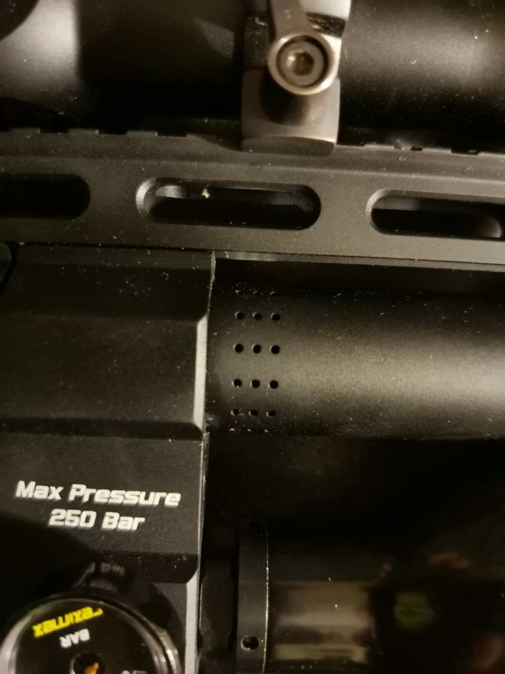

Hi I have reximex throne gen 2. On the shrouded barrel I have holes all around. It's very loud. Can I make blind these holes?
Make blind the holes? I am guessing you mean fill the holes or plug them up? Best way would be welding. If that is not an aluminum Shroud if it is you could try the cold welding for aluminum from the inside of the Shroud and use a marker to touch up the holes after filling.
There is more pressure in the Shroud when you fire a round then you would think. So much so that on my Wildcat MK1 I have dense foam in my shroud with 4 3mm holes, it blows the foam out of the holes after a few shots.
Yes, yes sorry me bad English. Yes aluminium.
Holes plug the? I can?
But what happens to the excess air?
If you remove the shroud and put a strong tape wrapped sticky side outward covering the holes, that should stop the air from escaping. The pressure pushes the same direction as the tape is pressed so the tape should stay put. The air pressure escaping is far less than at the muzzle, so this should work. Silver aluminum heat duct (3M brand is what I'm used to) tape should do the trick as it's very sticky and durable. Did the Throne come with these vent holes?
