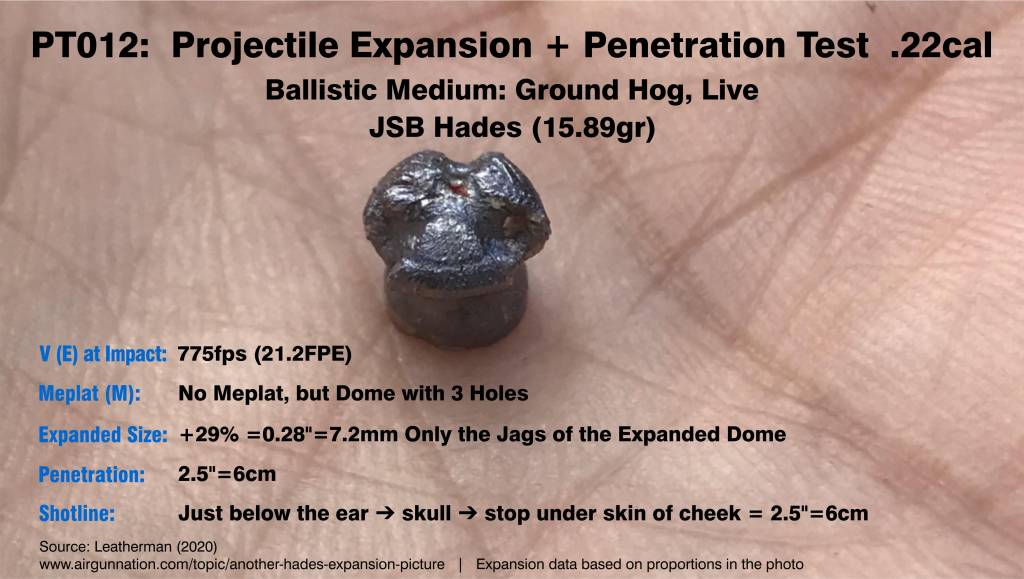

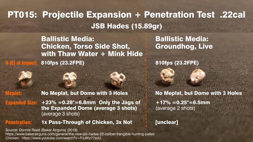

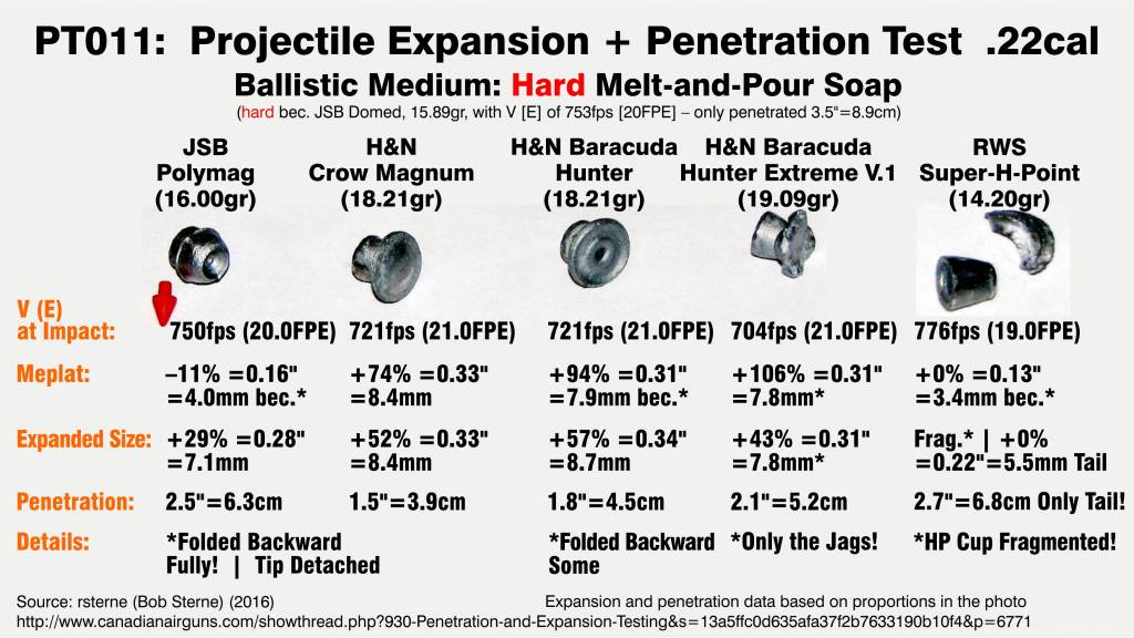

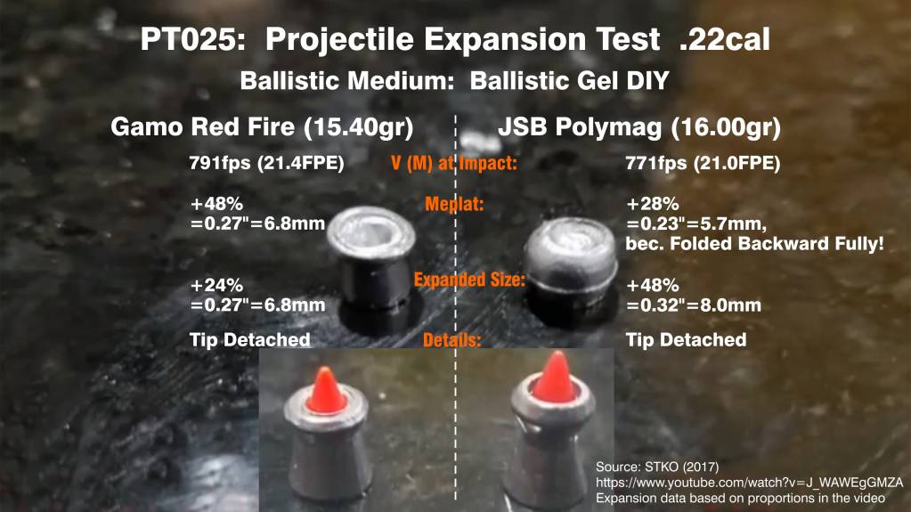

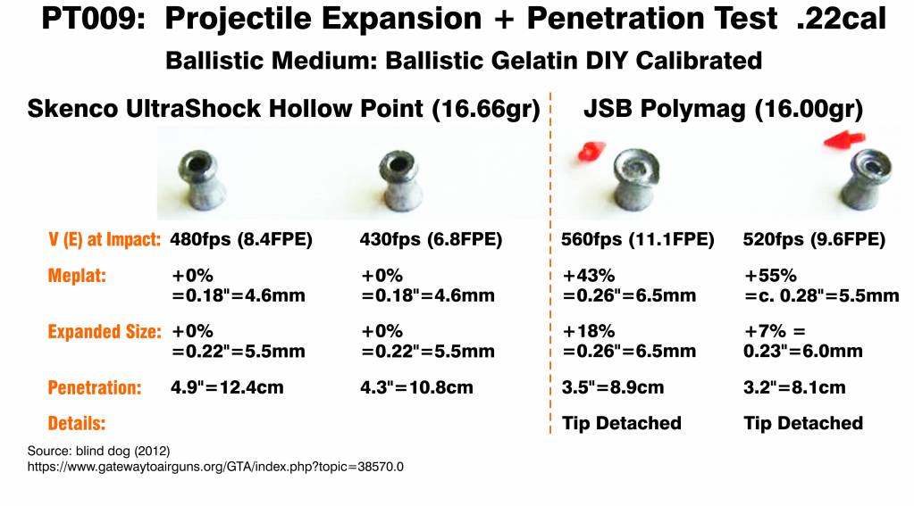

The testers most often do not give the specific details of their test protocol (impact velocity, type of ballistic gel), so we are left to reconstruct those. Similarly, many testers do not give specific details of their test results – which requires reconstructing them. I used the ChairGun ballistic calculator, the BC values from my Pellet BC Table and my Slug Table, and I measured proportions in the photos/videos to arrive at the data as presented in the Projectile Tests (PT).
HP Expansion Data
The purpose of a hollow point projectile is the expand and increase in diameter when it hits the quarry. The larger its diameter – the larger the impact area – the larger the permanent wound cavity (the HOLE) – the larger the amount of flesh being crushed – the larger the chance that the wound cavity includes heart/lungs, brain/spine, and/or a larger amount of blood vessels to cause hemorrhaging.
For example, a .22 cal projectile that expands to .295 increases its impact area by 85%, resulting in 85% more tissue crushed! (in metric measurements: A 5.5mm projectile that expands by only 2mm to 7.5mm causes 85% more crushed tissue.)
Meplat Expansion Data
The larger the flat part of the projectile’s nose – the meplat – the more tissue will actually be crushed when making the HOLE. The hollow point cup is also part of the meplat. At lower impact velocities a HP might not expand much in its diameter, but it might expand its HP cup – its meplat – and thus crush more tissue.
Penetration Data
The animals that are appropriate to hunt with airguns are typically small. Therefore a hunter usually does not worry if the projectile will penetrate far enough, as shots often penetrate so far that they will simply exit the quarry (assuming typical calibers of .177, .22, and .25, and typical muzzle energies of 12, 20 to 30, and 40FPE). Penetration becomes an issue on head shots of larger animals as the skull is usually difficult to penetrate. The tests presented here, however, use a soft ballistic mediums to simulate flesh rather than skull bone. For skull penetration tests different ballistic mediums are necessary. However, the penetration numbers will indicate which projectile/velocity combinations are especially effective at applying their kinetic energy to the quarry instead of passing through it like an icepick. This is to show that as the diameter of the projectile increases its penetration decreases.
All the PT include the following data:
• Test designator, PTXXX (where XXX is a counter; PT = projectile test)
• Ballistic medium
• Projectiles (brand, model, weight)
• Impact velocity, and impact energy
• Meplat (expanded flat part of the nose – the larger the more crushed tissue)
• Expansion (total diameter)
• Penetration
• Notes (ballistic tip behavior, shotline, etc.)
• Source (and notes)
Measurements in imperial and metric.
Red writing indicates details that likely skewed the test results to be too optimistic (e.g., a harder then flesh ballistic medium).
