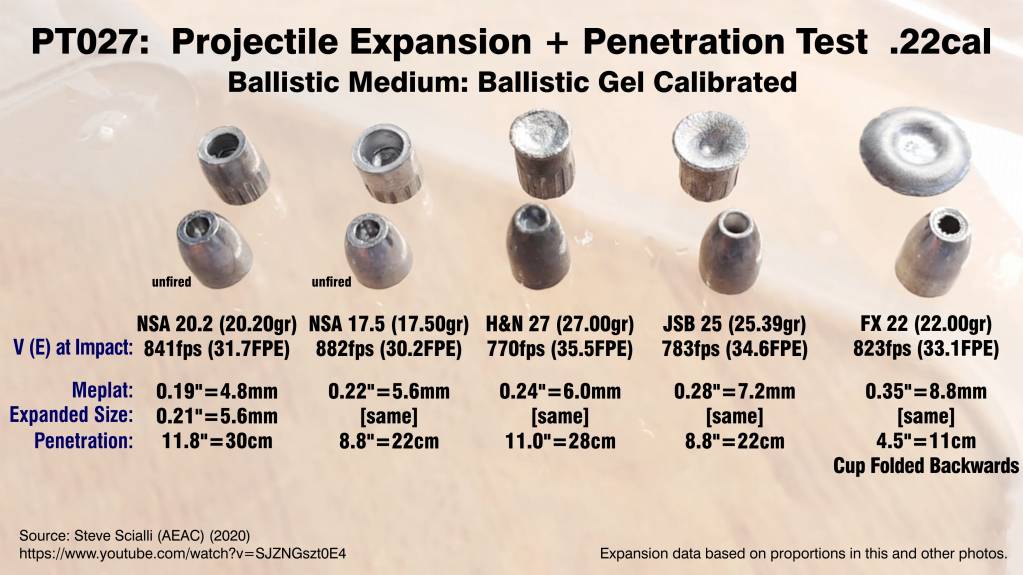

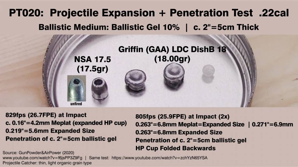

The .22cal FX 22 seem to really expand well. I'm glad that the expansion goes together with the loudest POP! 😄
Now, I'd love to hear more about the .22cal NSA 17.5. Because the expansion tests I have seen so far are not that amazing. (⭐ Though the NSA 17.5 is great in reducing wind drift, energy retention to targets way out there, and increasing my point blank range by flattening the trajectory!! 😊).
I'll attach two test results below.
Anyboy else having NSA 17.5 expansion test results on game or ballistic gel?
Matthias

I believe Steve's results to be absolutely valid, but all the 17.5 NSA slugs I have retrieved from critters (squirrels mostly, one chipmunk) are very flat. I don't think I have saved any pictures, if I happen to see one I definitely will post it for you.
I don't know how flat they are after exiting a bird, but the two times I have gotten doubles had a huge entrance wound on the second bird. Big enough to put a finger through. I have experienced the same wound when I hit the wing bone, it seems these expand greatly when you hit the bone because the entrance and exit wounds are of the same size and very large. I don't have any pictures because there really isn't a place to share them when they are that graphic. On scope cam you can see them being very disformed when exiting a bird, I dont have a good enough camera to zoom in and actually see the shape of it, you can tell it is tumbling and not projectile shaped like in Steve's picture.

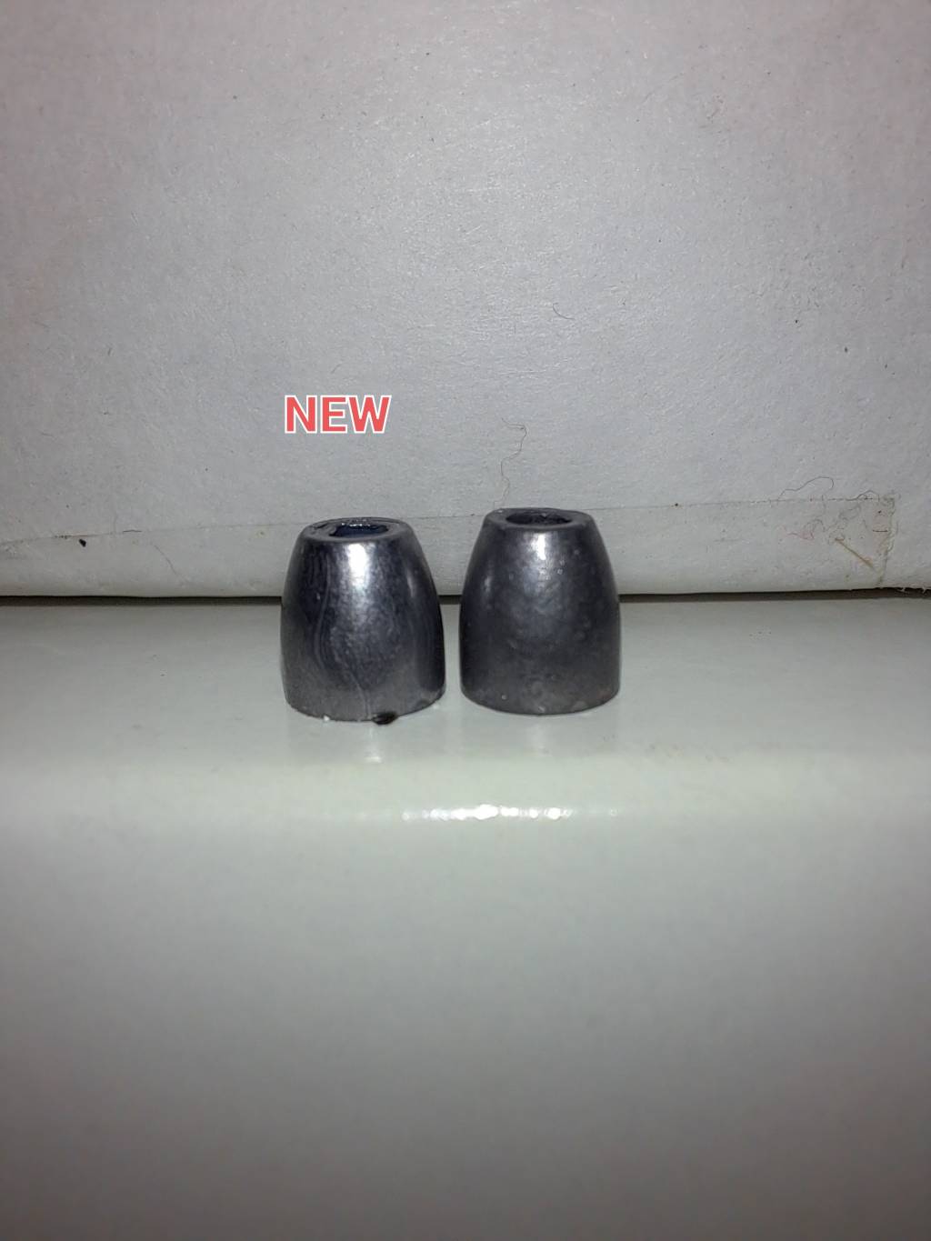

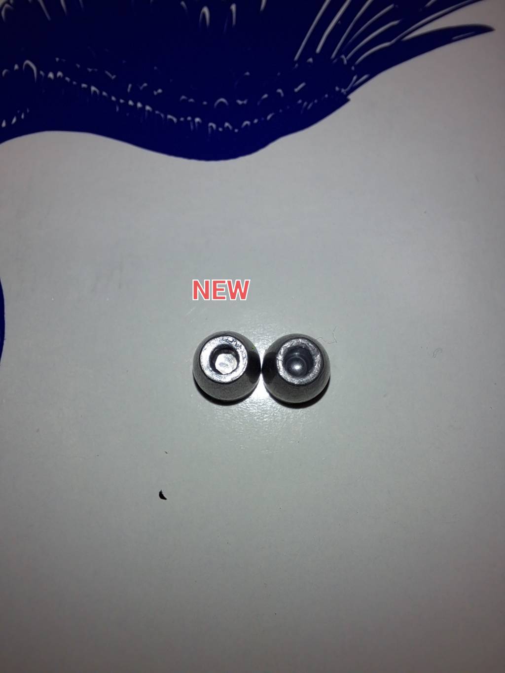

I just realized I need to clarify something, I shoot the OLD NSA slugs. Before he went to the mass production machines! My slugs are longer, have a deeper hollow point, and thinner hollow point walls than the current ones. I have some of the newer ones also, just havent had a chance to test them yet. i will dig up a photo I took showing the difference.

thanks for your pointers about concret/gravel ricochets and tin roofs — yeah, that's important, and easy to forget! 👍🏼
Matthias
