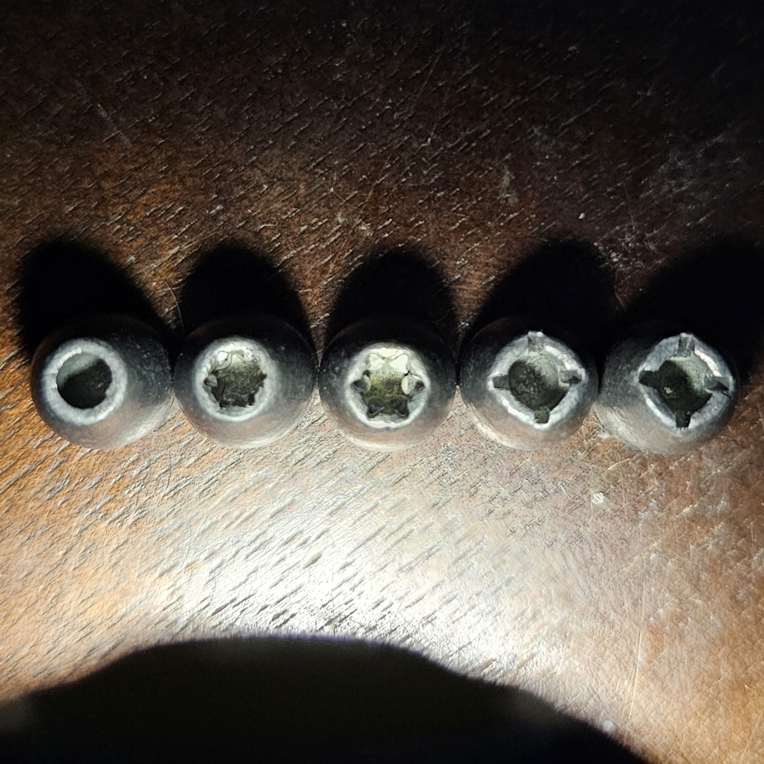

So I contacted Corbin at Corbins . com asking about having a custom die made to skive custom slugs in the name of science, consistency & repeatability as well as terminal performance. But in the meantime, I had to do some expirementation. I don't have a lathe or a mill to make my own dies (hence contacting Corbin) but I do have Torx bits and screwdrivers lol.
I tapped (left to right starting with a bare factory slug) a T15, a T25, a Pozidrive (didn't seem to make a difference over a traditional Phillips), and a Phillips screwdriver bit into the nose or meplat of some Javelin Gen2 56g .30 slugs.

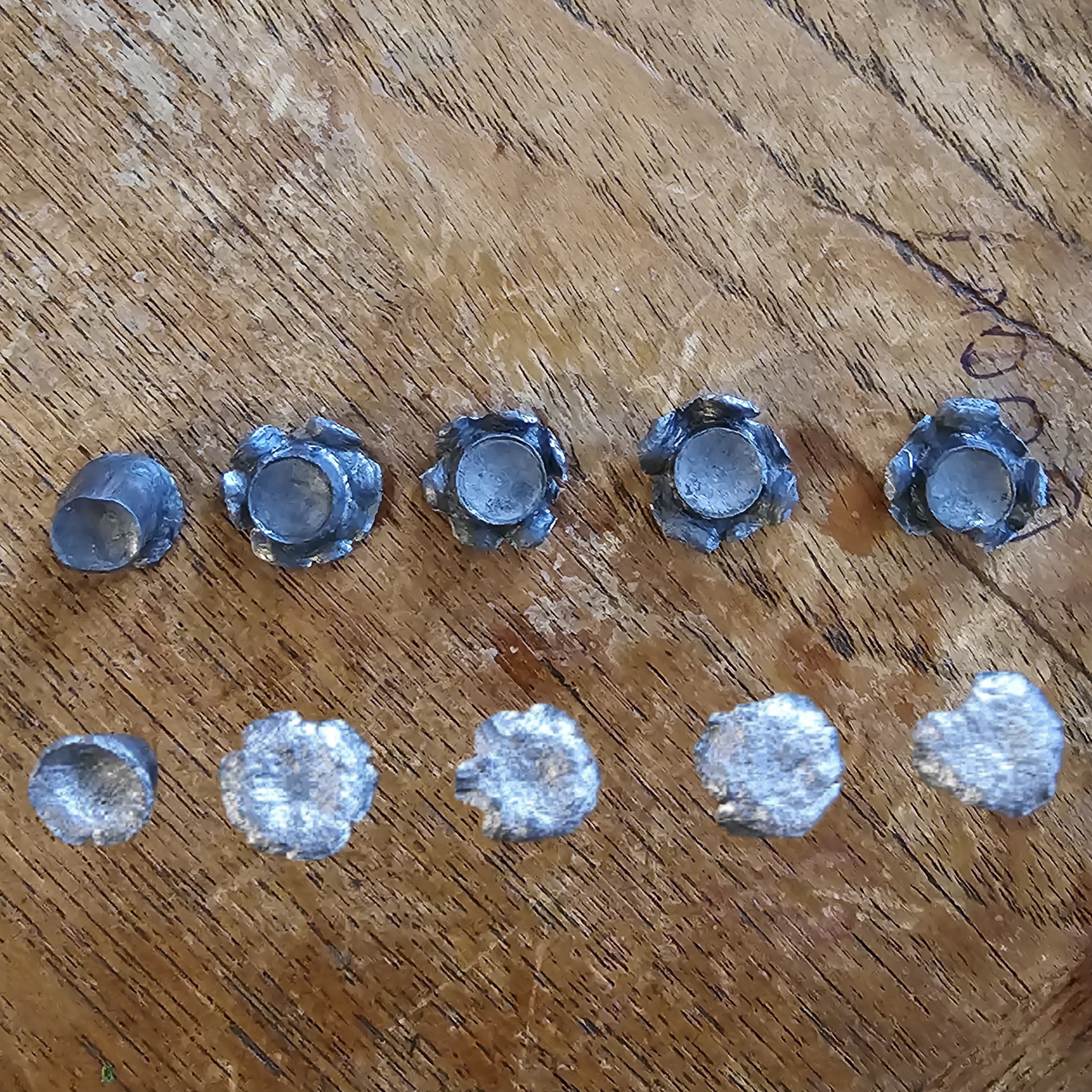

Photo of the 5 slugs I posted previously after being shot into a tub of water.
(Edited to show both sides of the slug)
Left to right, Factory slug, T15, T25, Pozidrive, Phillips.
I just tapped the bits into the nose or meplat. The T15 & T25 would actually bottom out and touch the base of the slug, which lead to more controlled and wider expansion. I think I'm going to try sharpening a torx bit to a point (while I wait on a response from Corbin) and see if making a star shaped divot in the slugs interior base will allow for MORE expansion and hopefully end with a slug that splits apart completely, dumping it's energy without over penetrating on a pigeon/squirrel sized target.
