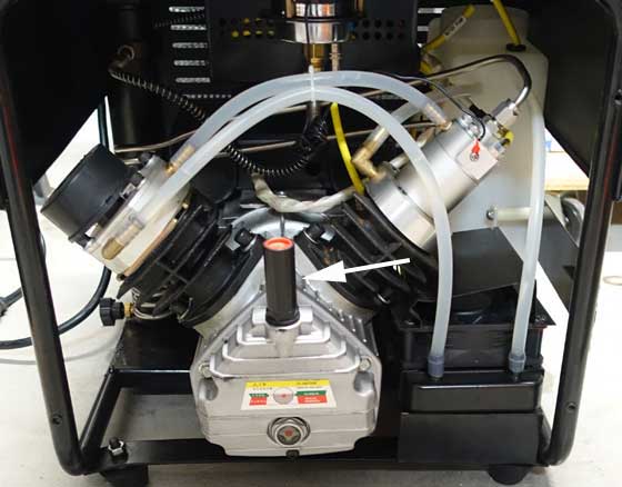

Does anyone know who makes these compressors for AV? They appear to be very much like the two cylinder compressors from Tuxing and others. I will give it to AV that they install the water tank, cooling coils and air filter, so they come complete vice having to have a bucket of water and use external filters... I'm assuming the actual compressors are Chinese made? Or am I way off base here? Not saying that they aren't good machines, I see nothing but praise for them... Inquiring minds want to know. ;)
Air Venturi Compressor (AV) $1300:
Chinese Tuxing Compressor $560:
"DuncanHynes"I want a quality compressor that isnt $2,000. I want auto shut off and water filter all included. But I keep hearing bad about one or the other that are floating around.
I wish there was a cheaper alternative that I would consider quality, in one of my previous posts I mentioned the 3 decent units that list from $1299 to as high as $2200. The nice USA made ones or the European ones are $3000 or more. The ones I mentioned the Air Venturi , Omega and the Carette are what I consider to be medium quality Chinese pumps there are plenty of write ups on them in the various air rifle blogs. The main reason I recommend these is they are all sold through US distributors who do offer support and I have not read anything bad about any of them other than minor quirks. I chose the Carette and so far I’m happy. I think I paid $1699 and that included the Alpha filter which I believe is needed with whatever you buy. This is not the end of your expense you will still need an air tank that can cost from a few hundred to $895 unless you fill your rifle direct from compressor. The pressure boosters like the shoebox are a cheaper alternative to them you need a good standard oil less compressor. Again the Alpha filter or equivalent is needed with ever choice. If that’s too much then you need to find a place to fill up your tank. Before I got my compressor I would travel to paintball store and get 4300 psi none I tried gave more than that cost $10 a fill. I got tired of the 60 mile round trip to do it. If I had a few friends in my town I would of partnered on a purchase but my PCP friends are everywhere but in my town. I have heard that some air rifle stores also do fills. I know of one in CA that doesn’t charge but I don’t live in LA. Good luck in deciding what to do if I can be of more help to anyone PM me.
The previous post were you see the Air Venturi compared to the Tuxing. It does definitely look to me that Air Venturi is based on the same compressor if there is a difference I don’t know maybe it’s the same with a few bells and whistles add on. What I do know though the Air Venturi is supported by its vendors good luck sending an email to China when you have a problem or need a part.
