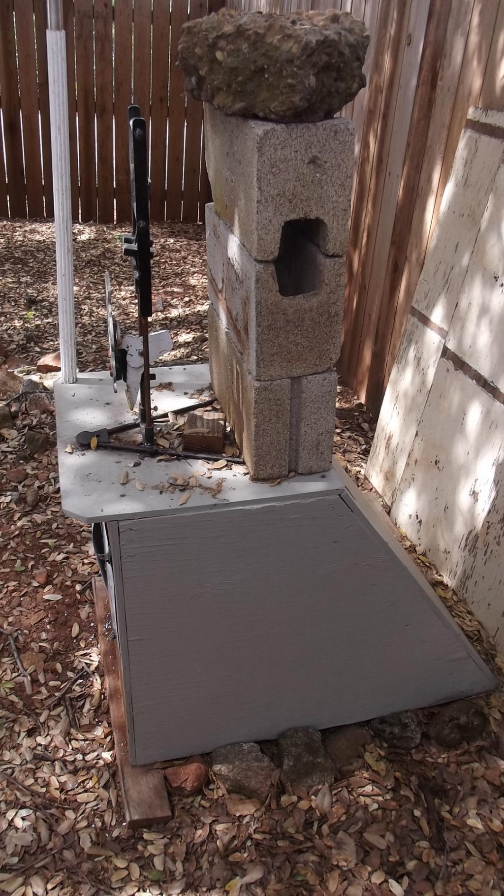

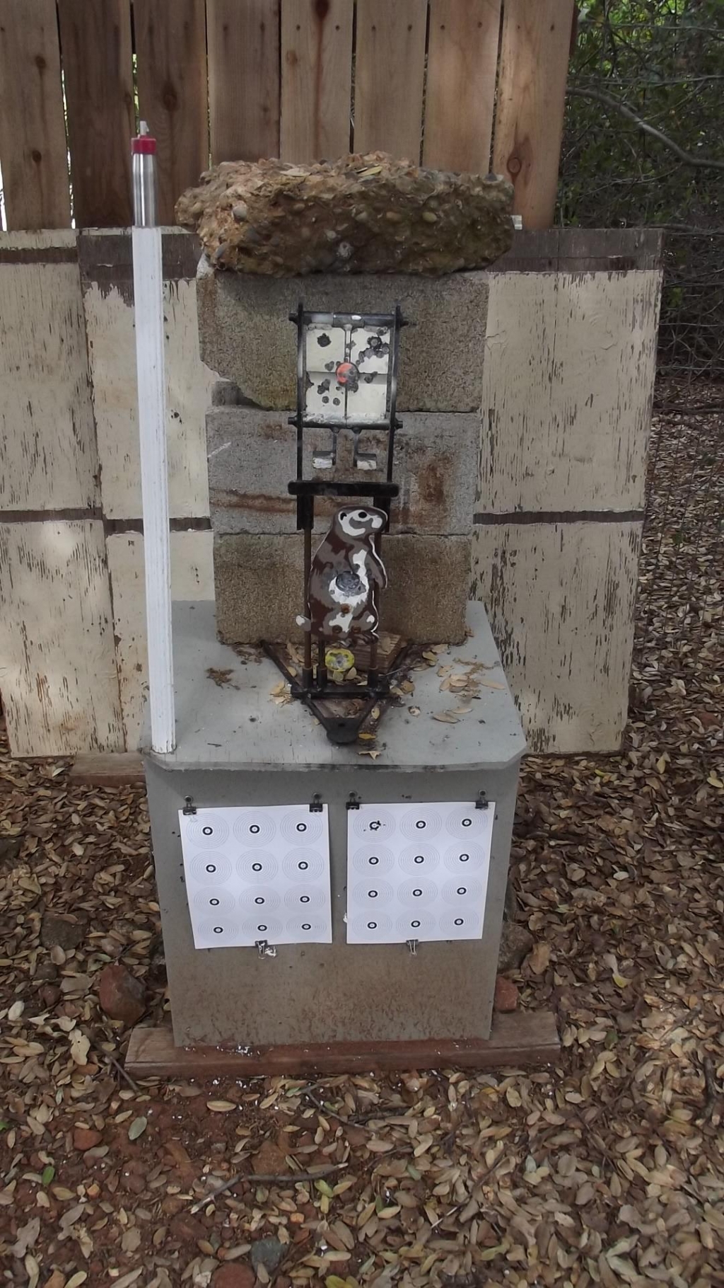

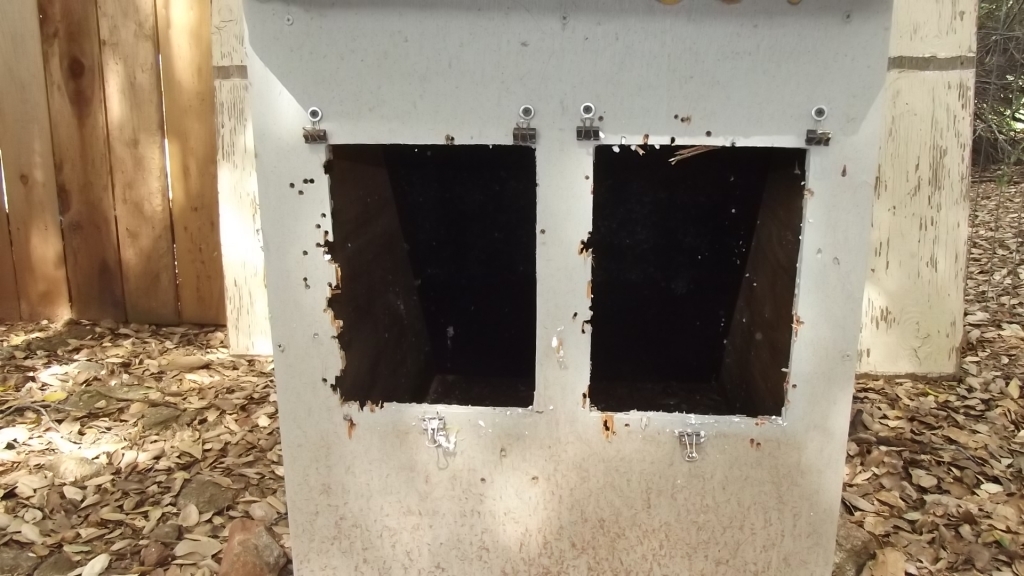

I built a wood box that has a 2 cut outs on face with binder clips top & bottom to hold 2 full size 8 1/2 x 11 multi target sheets.

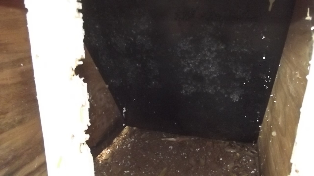

Inside the box is an angled board ( Cutting board plastic ) that sits at @ 45* angle. As shots come in they hit the board and get deflected down towards bottom of box.
This box has no bottom so all the lead lands in the dirt or a tray if one's there.
Low noise and easy to reclaim all the lead .... Works great !!
AKA: BOUNCE BOX
Have a much smaller version sitting behind my chrony in the shop ... Works equally well

Motorhead, can you give us a couple pictures of your bounce box? Sounds interesting and much lighter than mu box full of robber mulch.
A few random shots of the 10-55 yard FT practice backstop and last pic the box behind crrony
