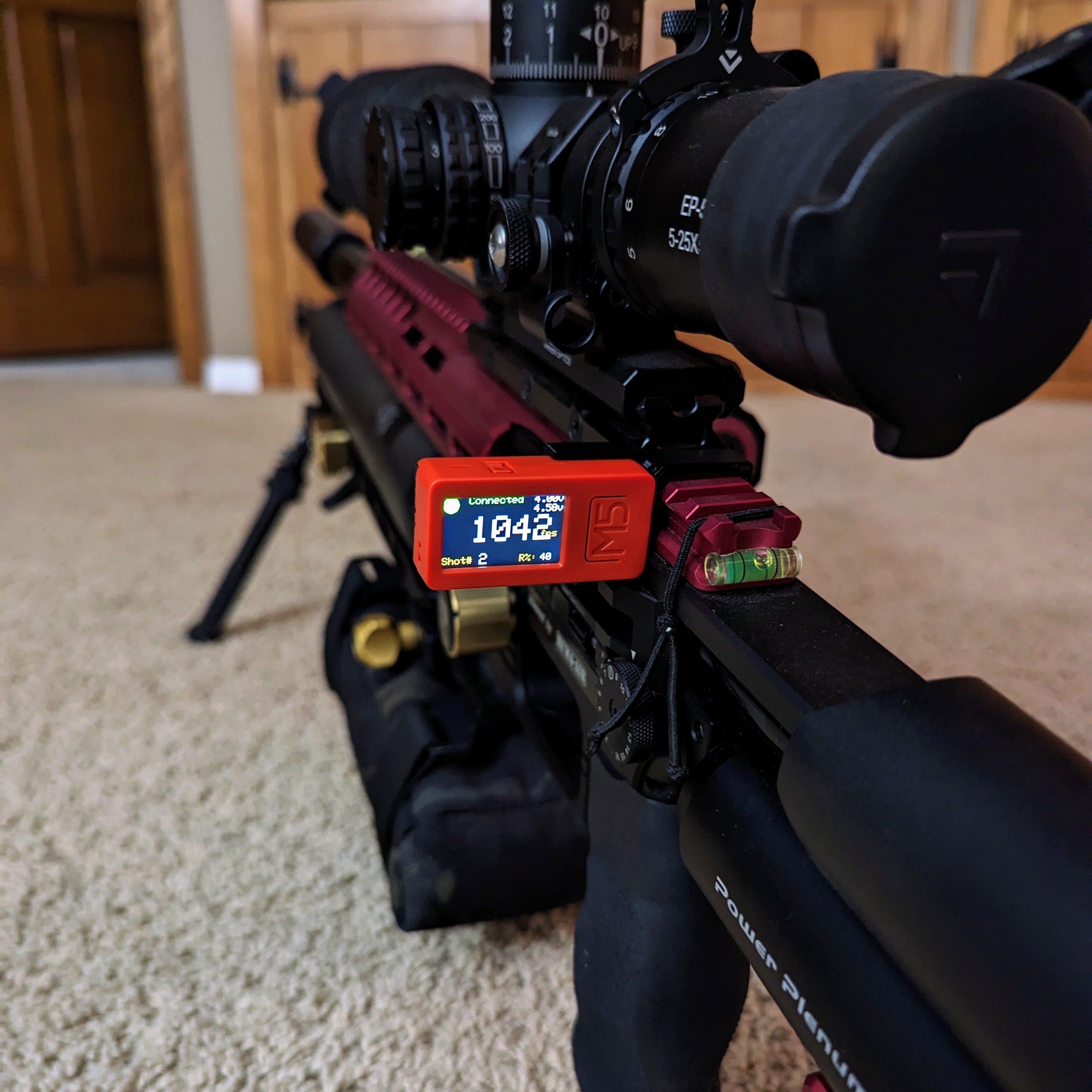

I got my Arduino environment all set up. I have compiled and verified that all code samples given thus far will work. all looks good. now to decide on what display to use. I also 3d designed a replacement fx chrono battery door and now need to find a power pack that will stay on to run the chrony from a larger battery source. not sure if I used the proper tie in points on the chrony and that is what is causing my pack to shutoff. I used the power and ground pins on the side of the board. I see others have tied into the battery terminals for external power supply and that may be why.

How does it shut down? The battery terminals on the side of the PCB work. You have to supply 5V though and not 4.2V (lipo) because there is a voltage regulator. Also, the FX Chrono times out and shuts itself down after 3 mins if not connected.

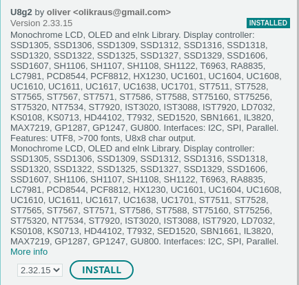

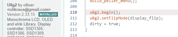

I was trying to compile and got this error
Users\FXChrony\FXChrony.ino: In function 'void setup()':
Users\FXChrony\FXChrony.ino:210:3: error: 'u8g2' was not declared in this scope

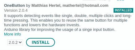

Install the libraries (Only do this the first time) Click Sketch | Include Library | Manage Libraries ... Use the "Filter your Search" to search for and install
1) u8g2
2) OneButton
