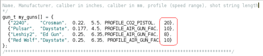

Update: Shot strings can now be defined per gun upto a maximum of 20. This is so you can set it to be the same as your magazine size. The shot string will reset on the next shot after it is full.
Note the additional number in the gun structure

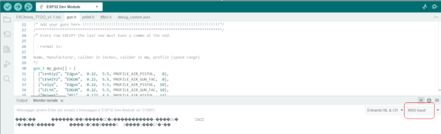

Yes, attach the display to your computer, start the Arduino application & select the Tools | serial monitor. In the display double click the "dump" option in the shot string menu.
Make sure you set the serial monitors Baud Rate to 115200 or you'll get garbage
Ok
Yes, attach the display to your computer, start the Arduino application & select the Tools | serial monitor. In the display double click the "dump" option in the menu.

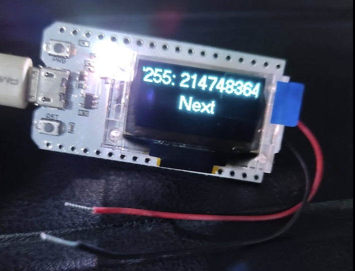

I compiled the latest version, which works,
I ran into an error in the menu for Shot strings
Steps
1. Click to Settings > Shot Strings
2. Single Click : Stats : Works
3. Single Click Go to : Review
- Double Click : Review
Error - unable to exit or move forward.

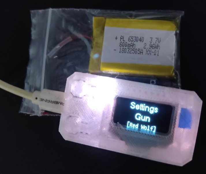

It might be a good idea to unplug the battery wires, if they touch each other you may damage the battery charger electronics, if they touch something on thge PCB it may damage something else
Thank you - I agree,
I had to wait a while to get a 1.25mm pitch JST connector, and I checked to see if it was a fit.
I've bought some heat shrink sleeves and a switch that I'll use the battery with, just need to measure things properly and 3D print them.
Appreciate everything you did here.
When picking a battery try to get a protected pack (see my post on page 1). The battery's size is specified in it part number.
You have a 653040 which is 6.5mm thick, 30mm wide and 40mm long. Ideally you want a xx2540
Yes, I wanted a smaller part, but it wasn't available from the shop I ordered from, also, this one said it had BMS protection.
I'll probably order another just for some more capacity and dimensions elsewhere.
