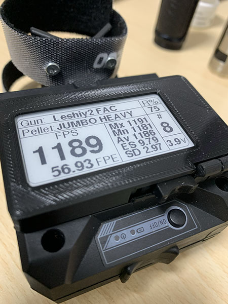

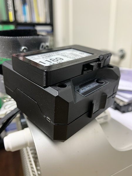

It uses BT connection. It is based on DaystateRebel code for the TTGO. Only the power lines are hooked to the FX board.My board is in the mail probably will need couple weeks to get it to my hands.
Oh yes, I will use it for sure, I like it very much.It uses BT connection. It is based on DaystateRebel code for the TTGO. Only the power lines are hooked to the FX board.
It has an ON/OFF switch so you can decide wether use it or not. eg. If you want to use the official app.
built in magnetic sensor? or flip it in a code?It is the TTGO software, you can flip the display. (never tried it)...![]()
