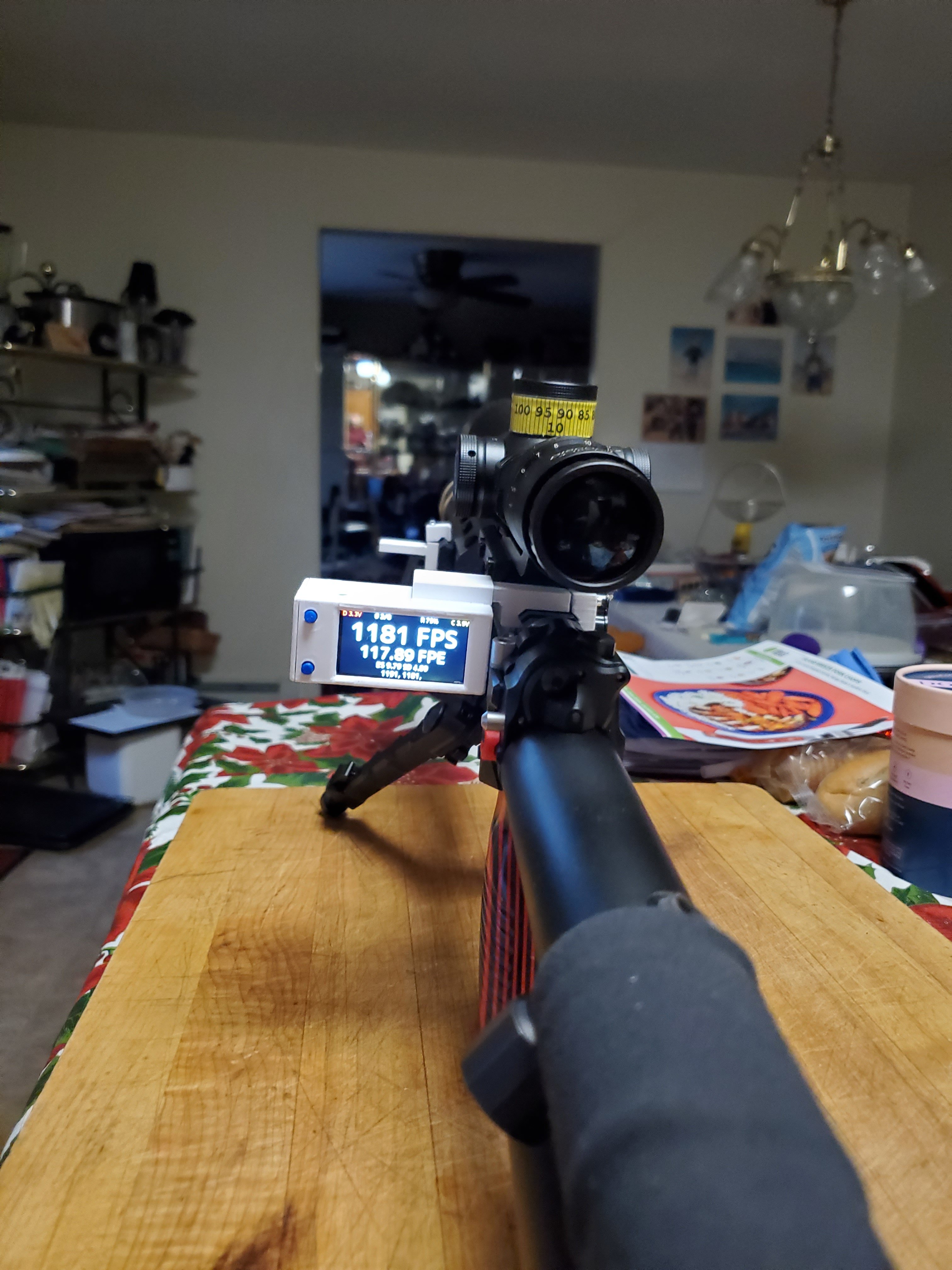

Homebrew FX Chrony display
You can choose to flip it in the settings menu.
I'll try it ASAP to be sure it works also on my E-Ink display.

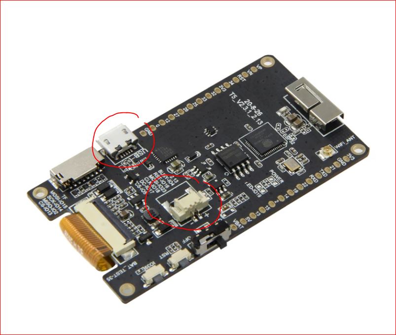

Currently I am powering my dopler radar from an external battery bank (with a usb cable permanently soldered to the FX board) and logically I would tap the Lilygo screen into those same pins.
I just noticed that the Lilygo have a permanent USB port, can this be used to power the unit? That way I could have a removable cable...
Or I need to connect to a second pin location (the usb port is for programming only)?

just set up my e-paper and yes it can be powered by the usb port.

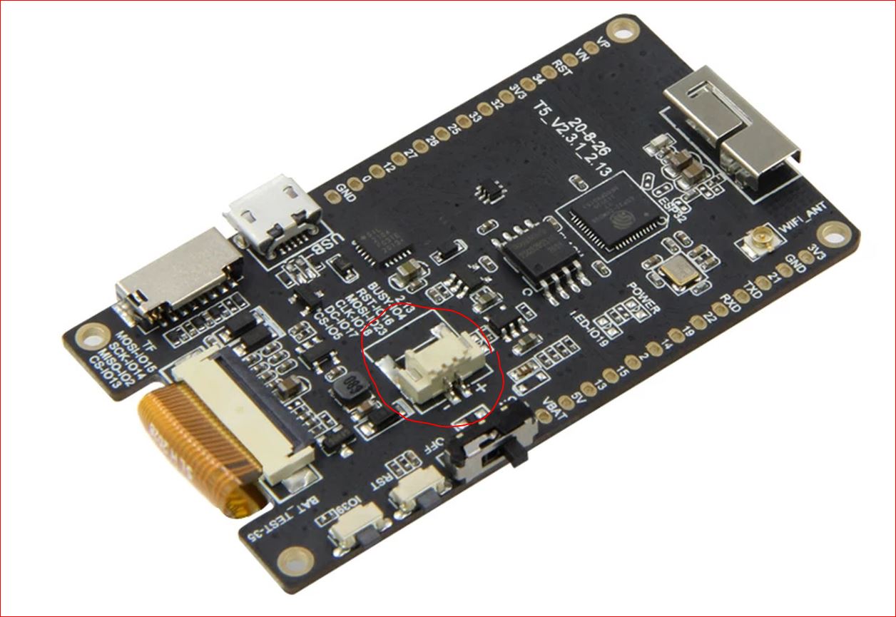

Excellent, the usb cable is removable. That second square connector, can I tap into to power the FX radar? Anybody have a name for that plug?
Wouldn't recommend that, i believe that plug runs a charging circuit for a lipo as well as Power in to board, its not a direct connection to usb port. if you already run chrono from a usb you should be able to work out powering board by that plug from chrono. ive put a 350mah lipo feeding both and charged via the board usb plug.
it does flip from the menu although inverted it is a little off centre (But not enough to bother you). Odd thing though, first time i flipped it nothing happened then returning setting to normal it flipped now it flips every time but for normal way up it is set Flip on.
I was tinkering about possibility how to remove the permanent cable from the FX board and just use the USB on Lilygo and tap them together
If your battery pack only has 1 output? You can get splitter USB cables. Thus power 2 units from 1 cable.
The battery pack has 2 outputs, but so far I was using one for radar and one for tablet-A (Strelok). If I could make the radar+Lilygo a single cable and removable that would be the ultimate goal. That way I could have both the radar and the Strelok wind direction working w/o interrupting the BT.
