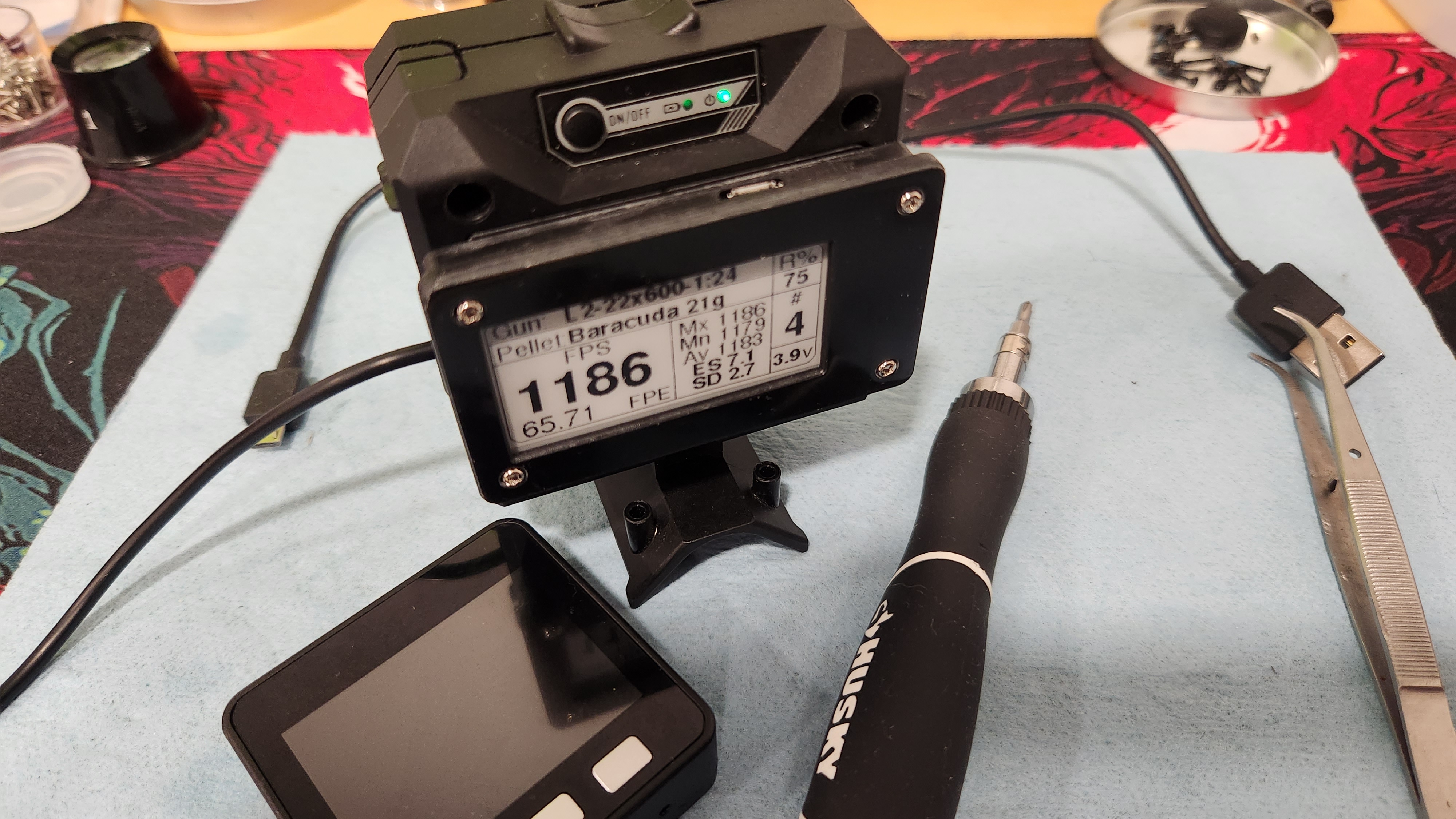

@bigHUN and anyone I am interested in programming the fake shot. Any help? Thanks.
I am not a coder I got this one as well, for my M5Stack Core, but there are other "fake shot servers" on discord for different units as well.
No display and unfortunately cannot see even the battery status, only a black screen, but I charge it before use and works just fine.
Push the button and creates the fake shot speed (fps or m/s is preset in the display).
View attachment FX_server.zip

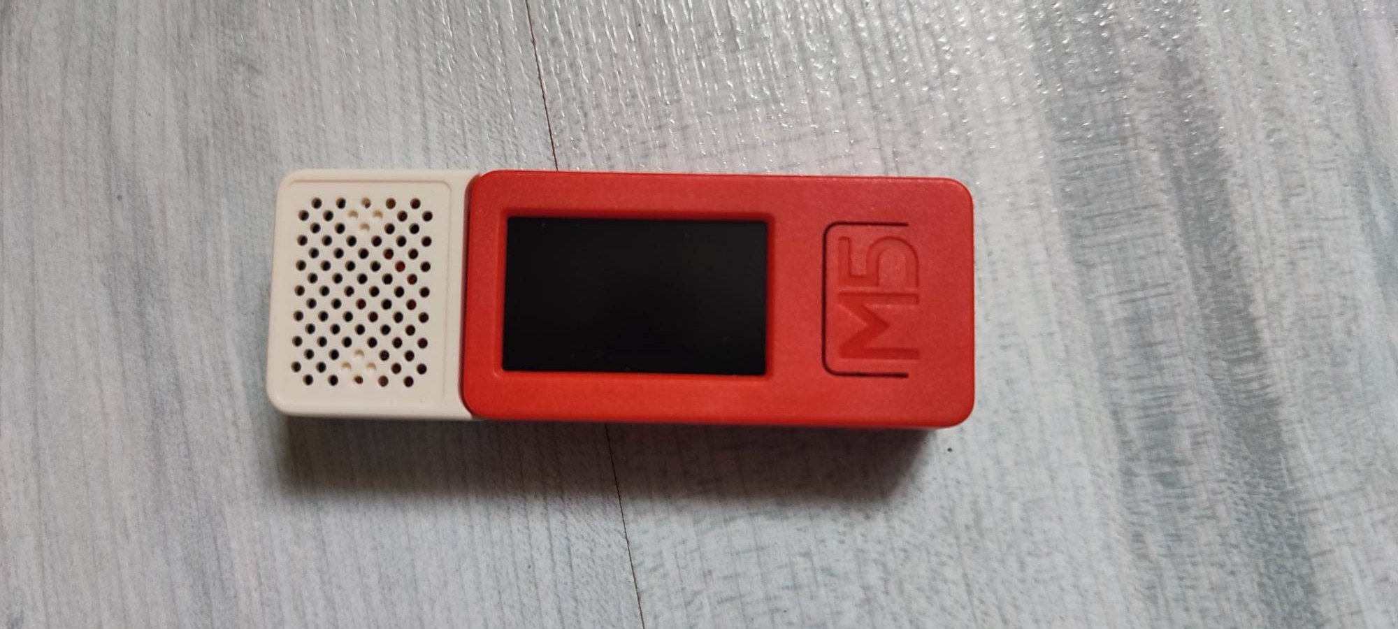

I'm an absolute noob to Arduino. I know less than nothing about it, but after 4 hours, I finally got my M5stick working, using the M5stick plus ino file. I was missing the OpenFontRender library. I couldn't find it on the Arduino library, but I found it in Github, so now it's all good!! Thanks for all who contributed to this project!!
Good to ear it was solved for you. Any clues please about the speaker hat ?
