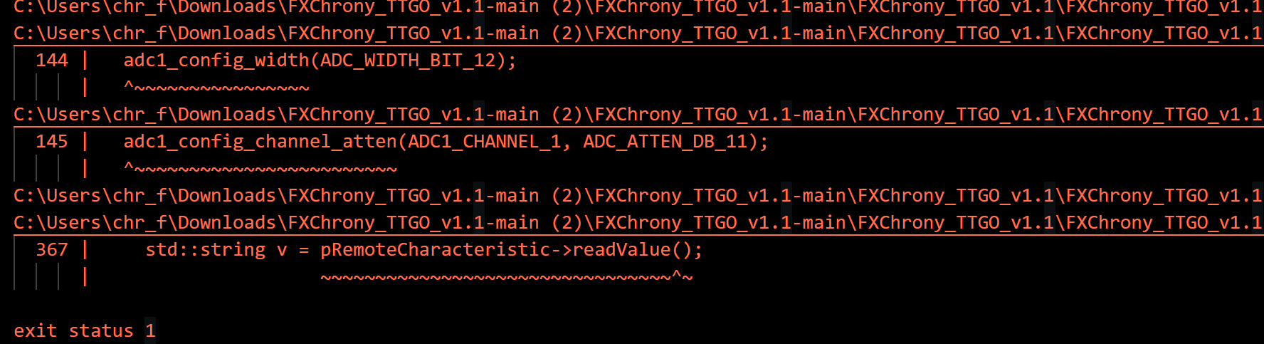

Hum..... Arduino got updated and I cannot find my TTGO board name .... just got a new batch of pellets wanted to upload ...
Anybody can help with e-paper display?
You can select "esp32 dev module" board name on Arduino and this wil work for lilygo t5.

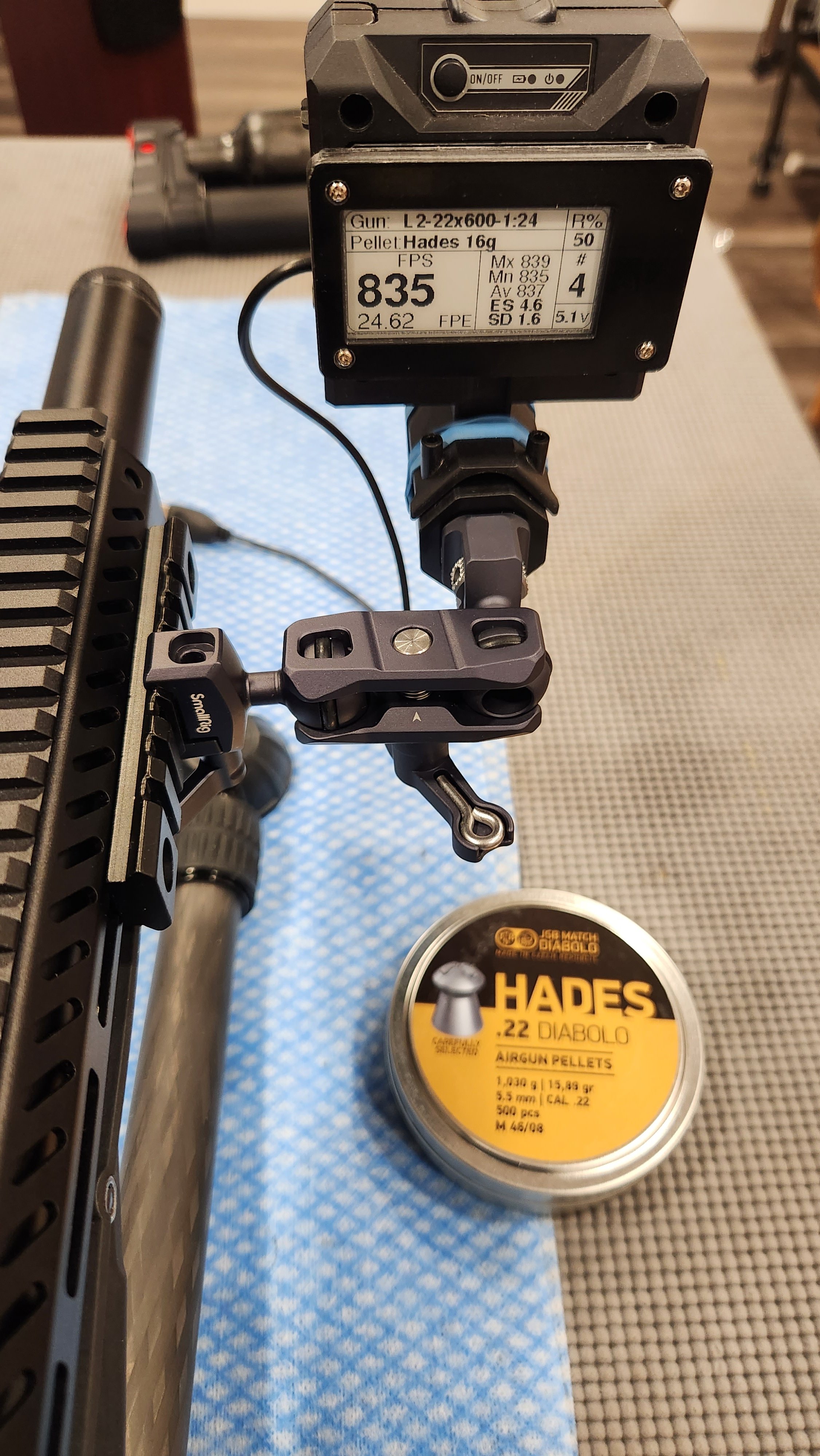

I like mine display. This how mounted on my L2.

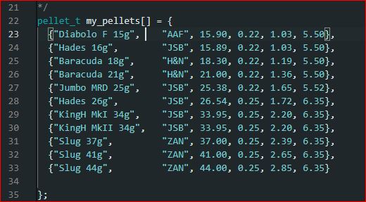

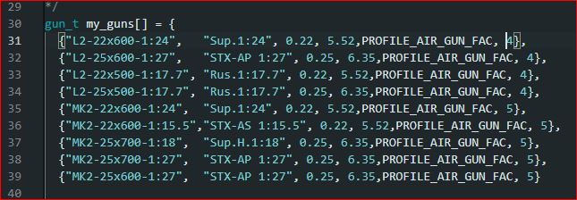

I have couple of liners and barrels, and I made the gun profiles in a way that the display will show which liner/twist rate was that in my testings different amo.
I have tested tons of pellets and slugs, and eliminated all from the list that I am not confident buying again.
