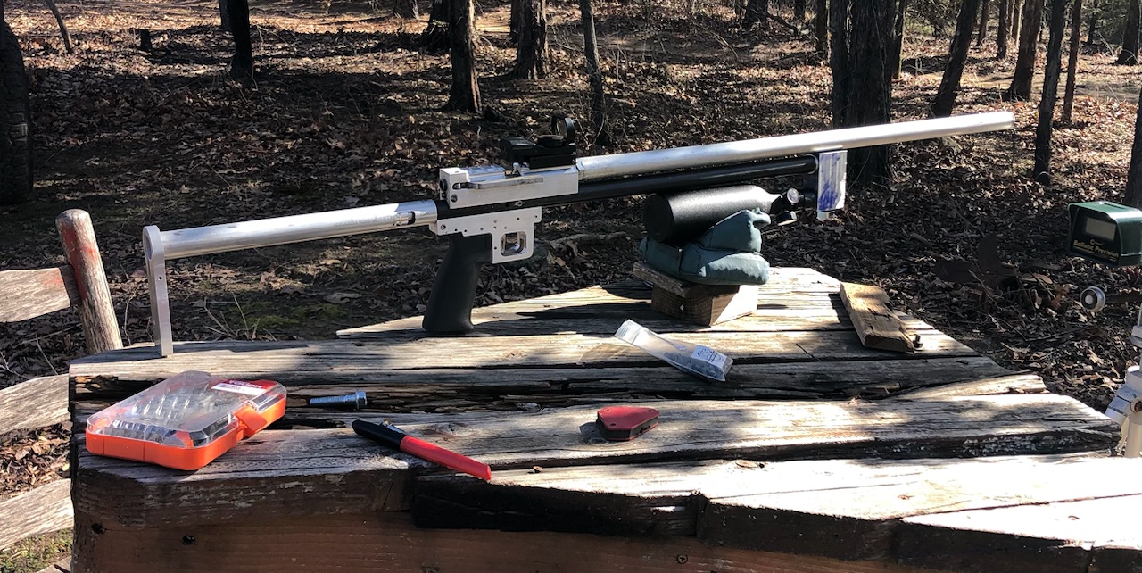

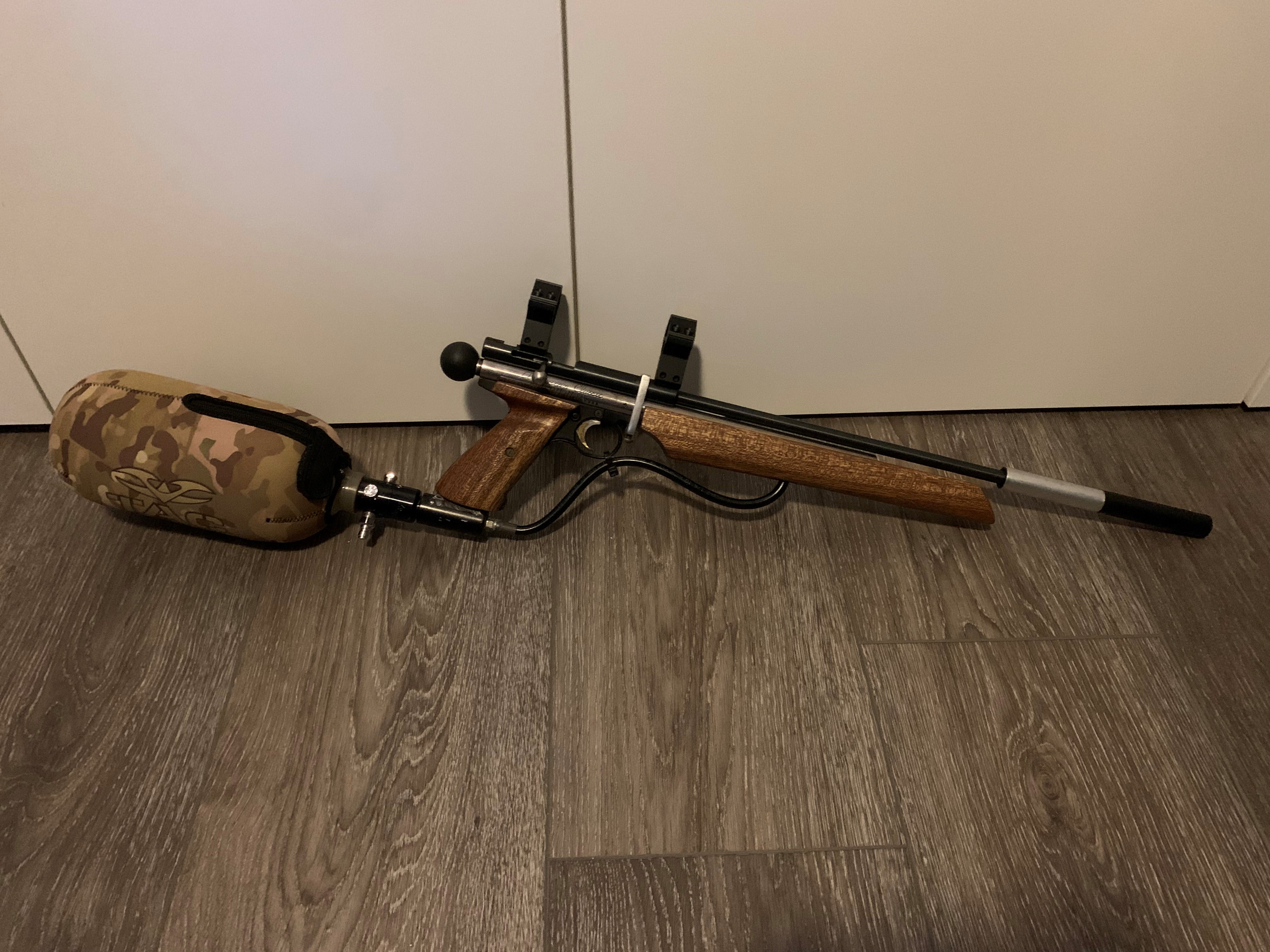

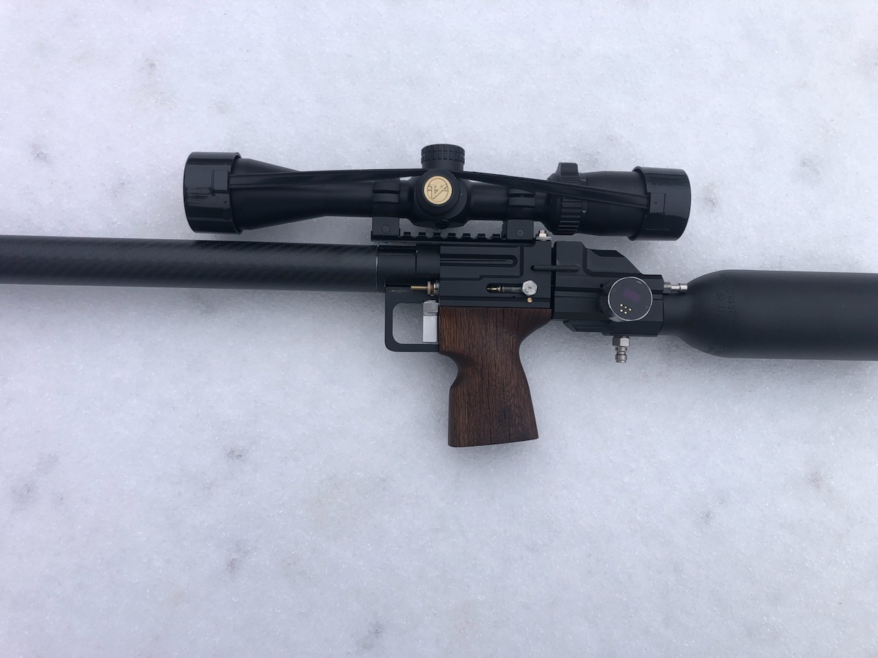

I’ve built quite a few trying different valve designs. My avatar is a home build where the main poppet sits directly behind the slug. The main poppet is controlled by a much smaller pilot poppet struck by a hammer that requires around 5lbs to cock. It has been tested (quite a bit) with 4500psi and functions as designed.
Obviously it is inspired by the L2 (in many ways).
And a couple others (not quite as finished).
