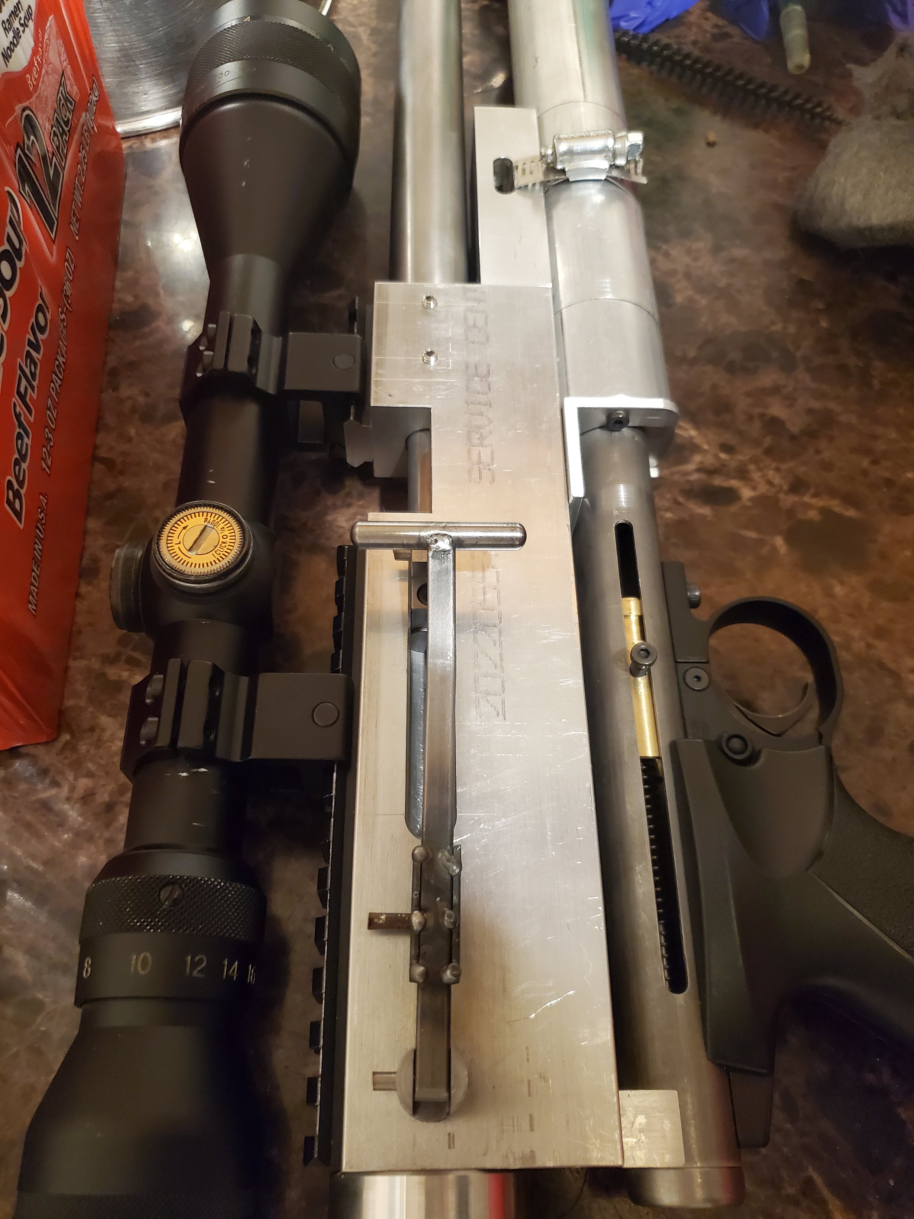

I do have some 388 grain Nielsens' that I've yet to put through the chronograph but they do have much more recoil than these 250's. I'm considering using sabots as well. I made it to take different caliber change barrels and I'm curious to see what I can push a smaller caliber at.
I couldn't find any info on the valve design of my hammer and didn't have the nerve to open up my brand new gun. I just did as much research as I could online of air valves that can dump large volumes of air quickly. The first valve that I designed wasn't a balance valve. It worked well but required way too much force to open it, and that's when I learned about the balance valves. It was the most difficult part to machine of everything.
Yea that isnā€™t a valve most would choose to make for their first airgun. I asked if you used the hammerā€™s valve because it is also a balanced valve. You should take a look at it, the hammer is a lot easier to take apart than you think.

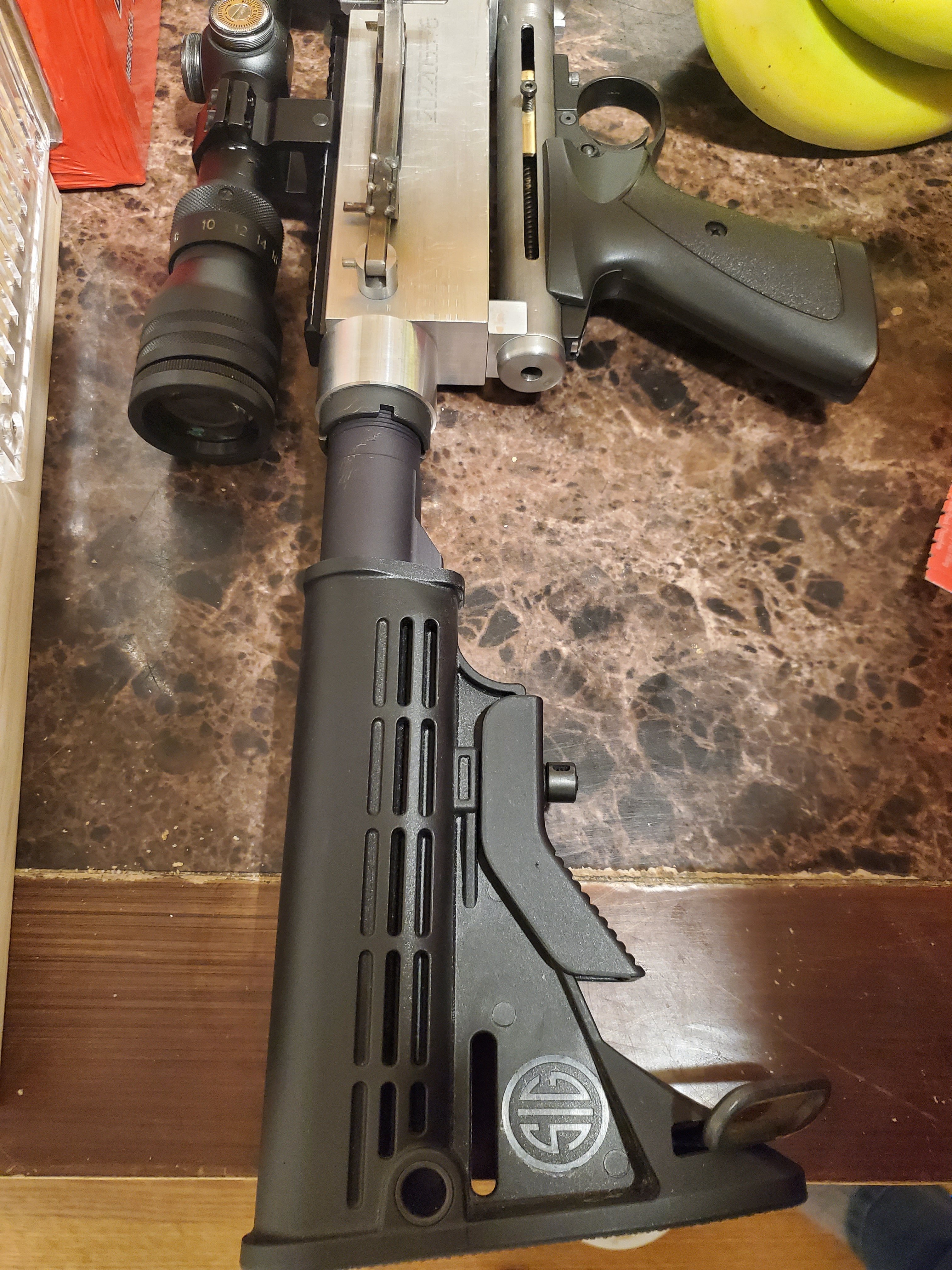

Yeah its definitely a proof of concept platform more than anything. The clamp is really the only thing mechanically hokey. It's difficult to build pretty guns.
Wasn't trying to put it down or your work, I apologize if it came off that way. I just know the kind of power it's putting out and I'd be a little nervous to handle it at first.
Maybe slip a bracket under the barrel that goes down around the tube and has a set screw on the bottom side so when it's tightened down, it'll pull that all together. That would eliminate the hose clamp and clean it up alot.
A nice powder coat in black would finish it off well.
Does the side lever breech also cock the hammer, or is that done via the side slot in the tube?

Yeah, that's awesome! I hope you didn't just shoot through your wall!
I see how you have the clamp setup now. Can you machine a bracket that attaches to the top of the breech and goes down around the tube and do the set screw tensioning deal like I mentioned? I think thats totally doable. Could even make it a picatinny side rail for lights or maybe an ammo holder?
I actually added a mount since I made that video. It's the mount that the hose clamp is going through but I have an idea for a permanent way to afix it that will look good.

Don't mind my temporary pins in my side lever
