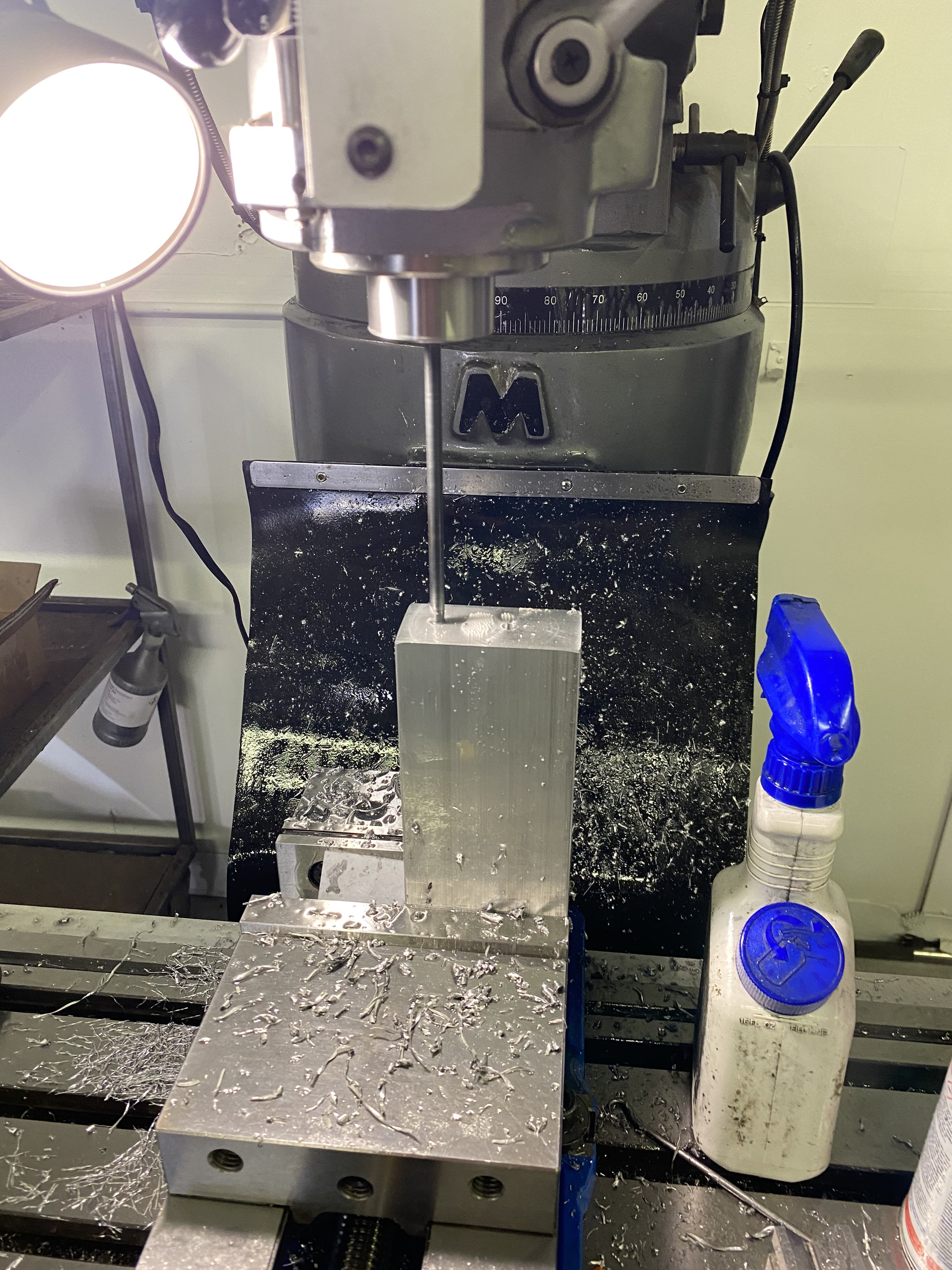

I grabbed a piece of 6061 billet & drilled two holes all the way through with a long 1/4" drill bit from the hardware store:

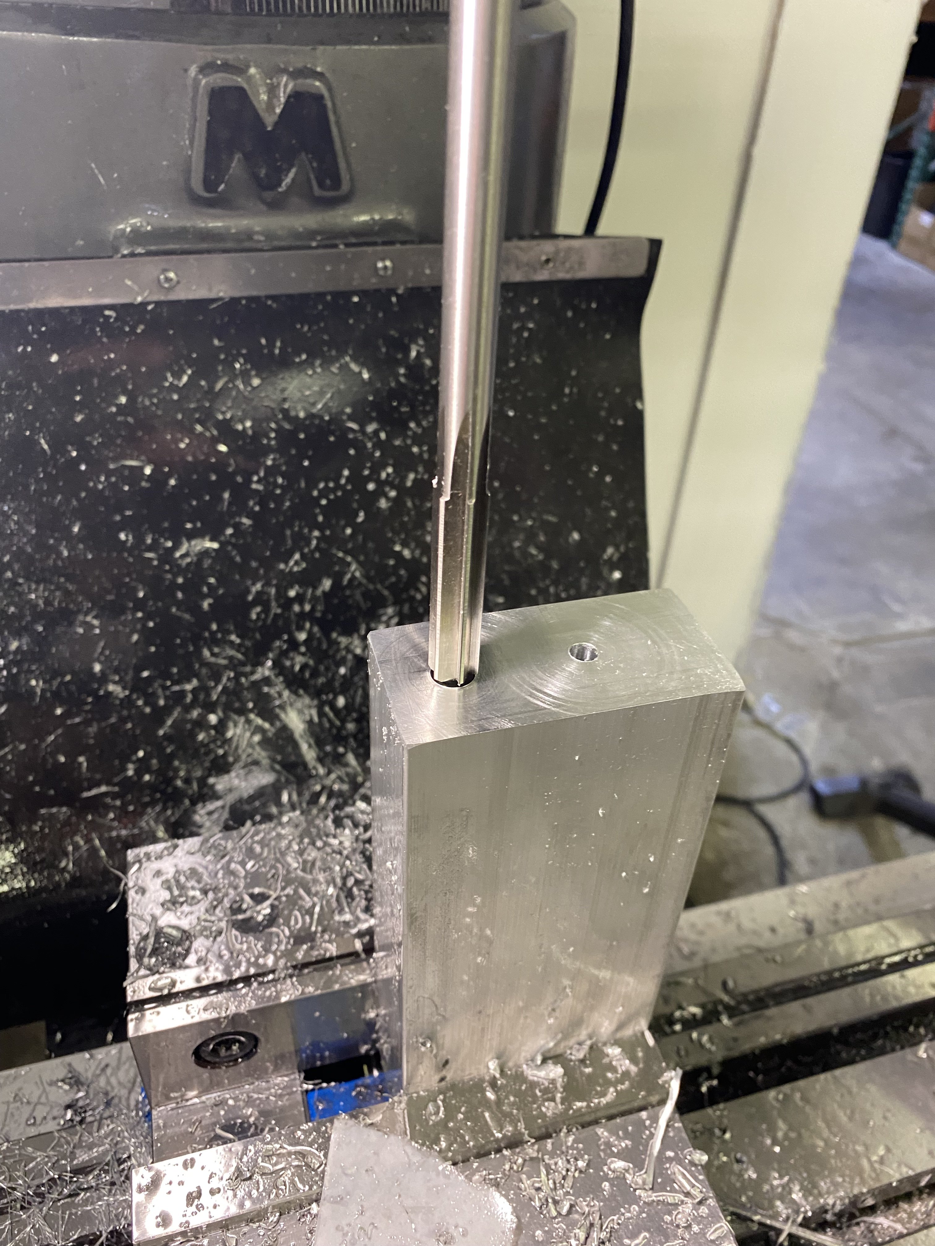

Enlarged & reamed top hole for an 18" Crossman barrel that I have lying around:

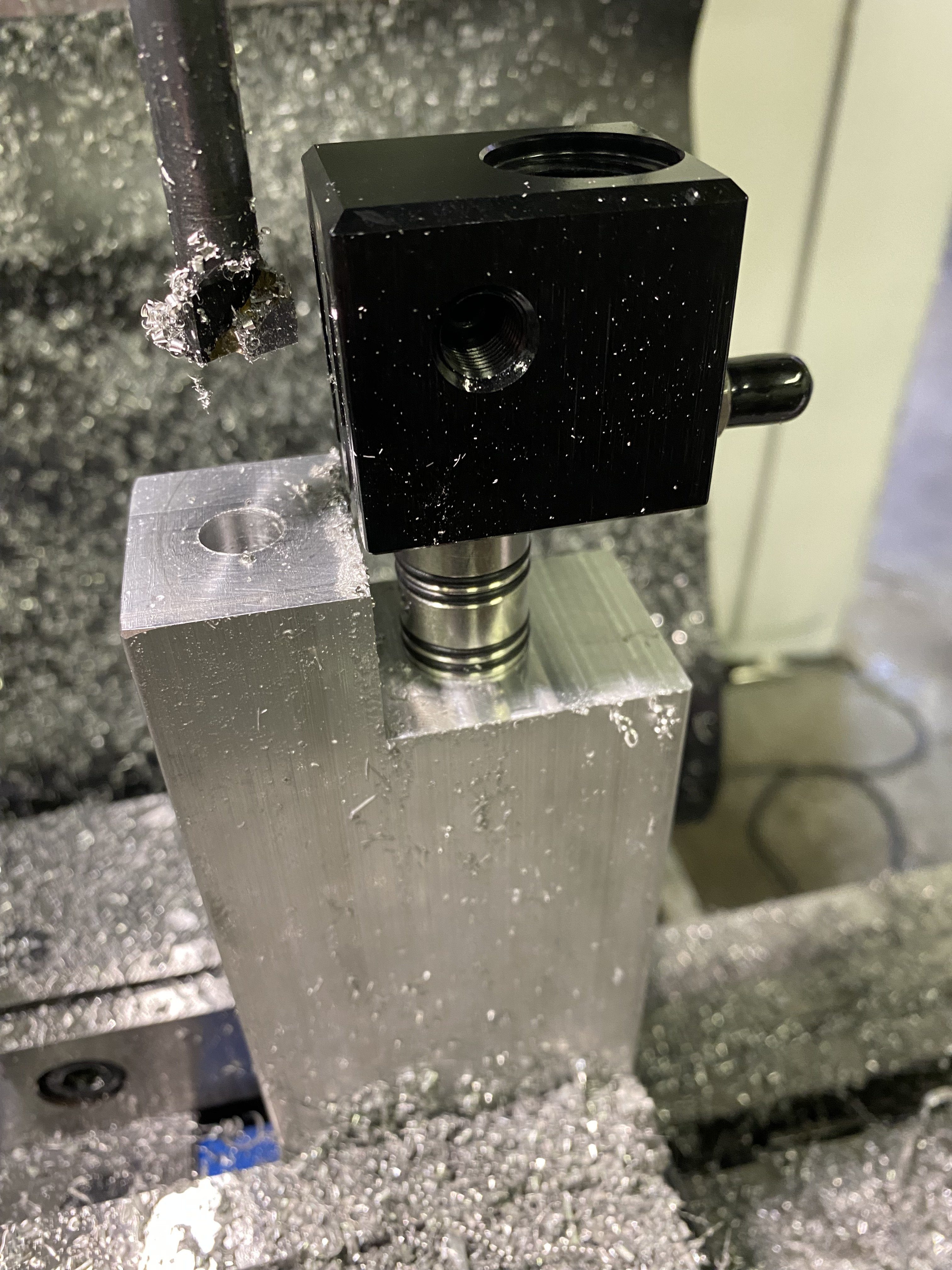

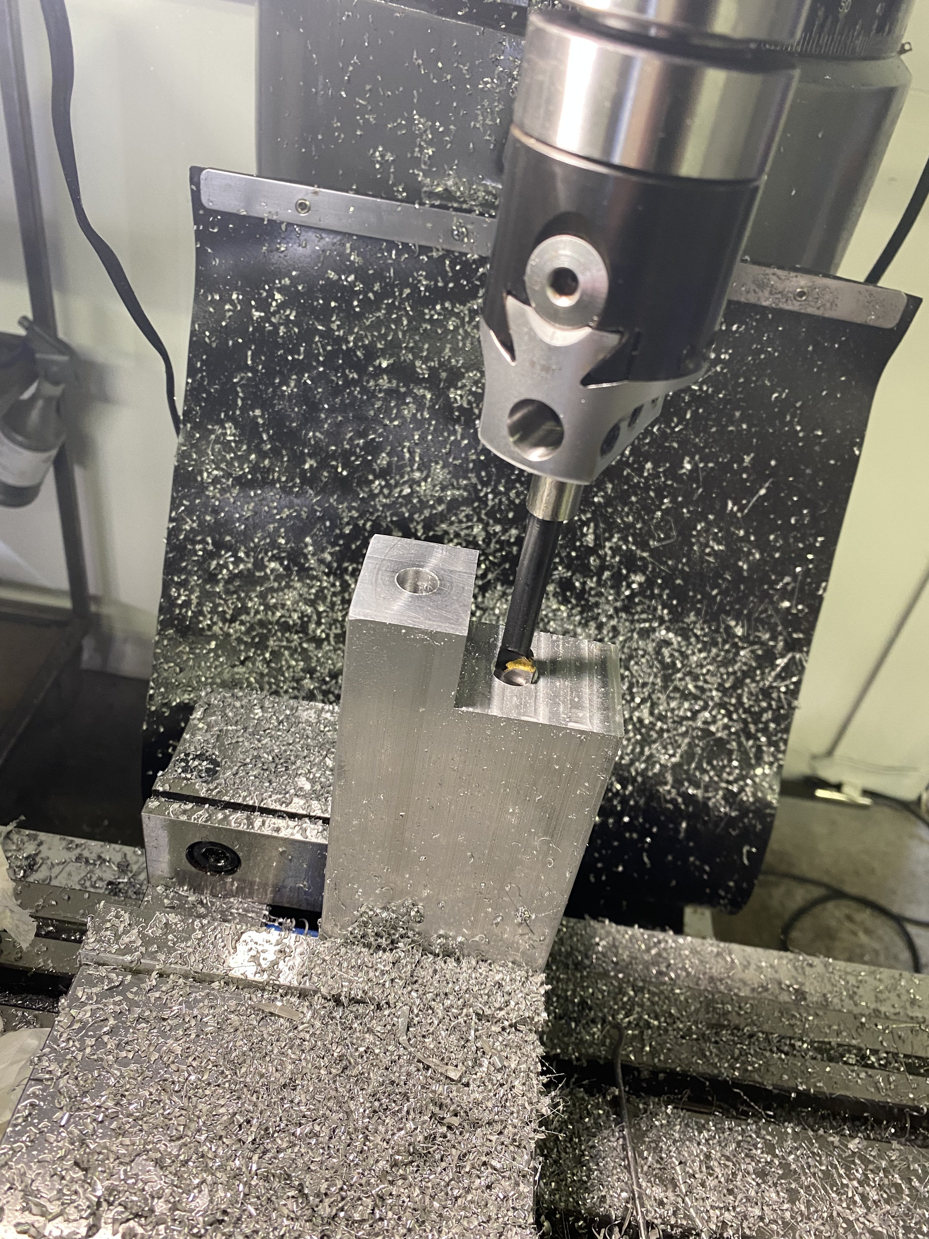

Used a boring bar to enlarge bottom hole to .788" to accept valve:
Test fit el-cheapo Amazon valve. Right after I bought this I saw one in Fleabay that comes with a regulator. I may upgrade to that if this receiver turn out ok, the front parts are the same:

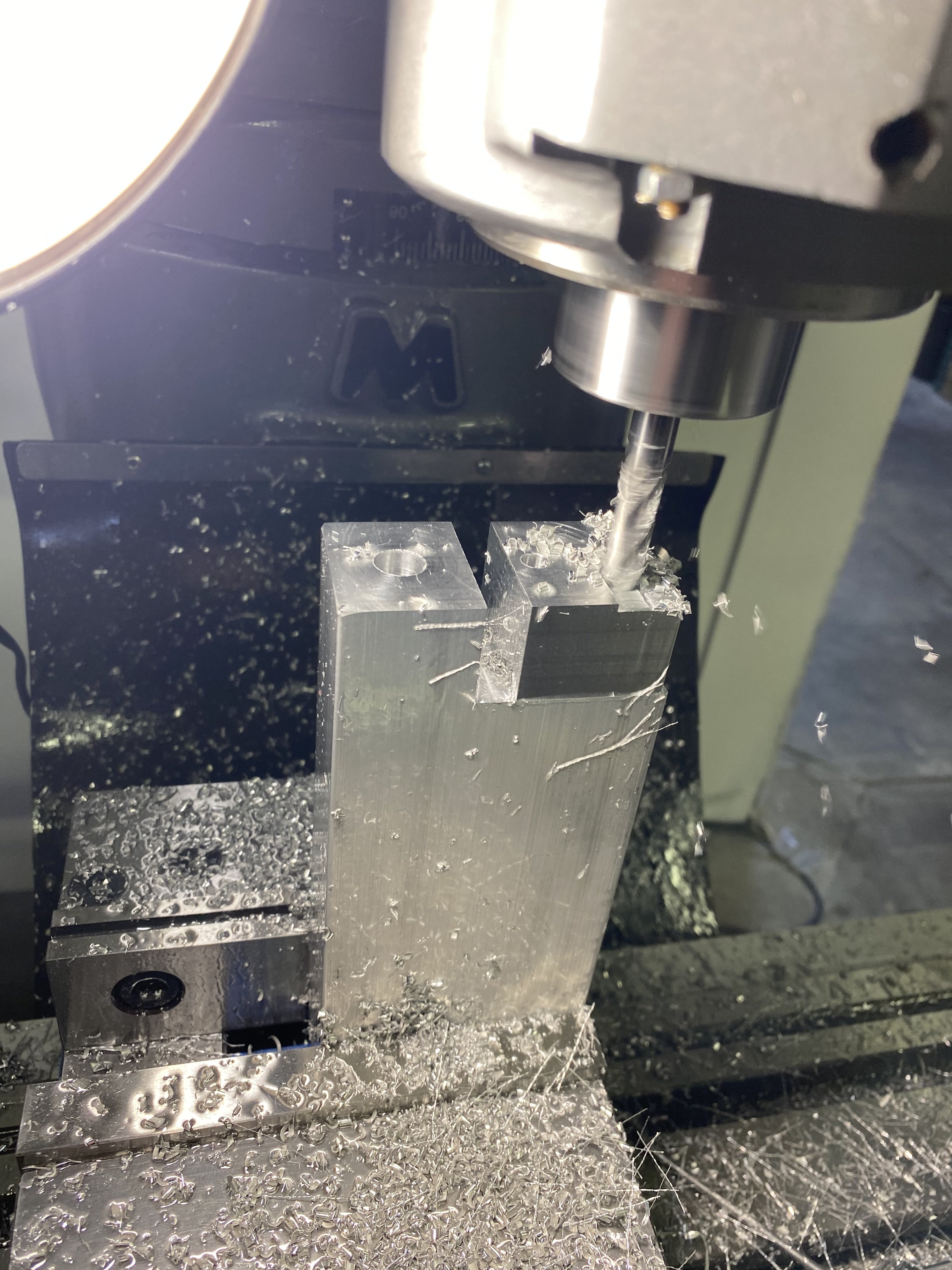

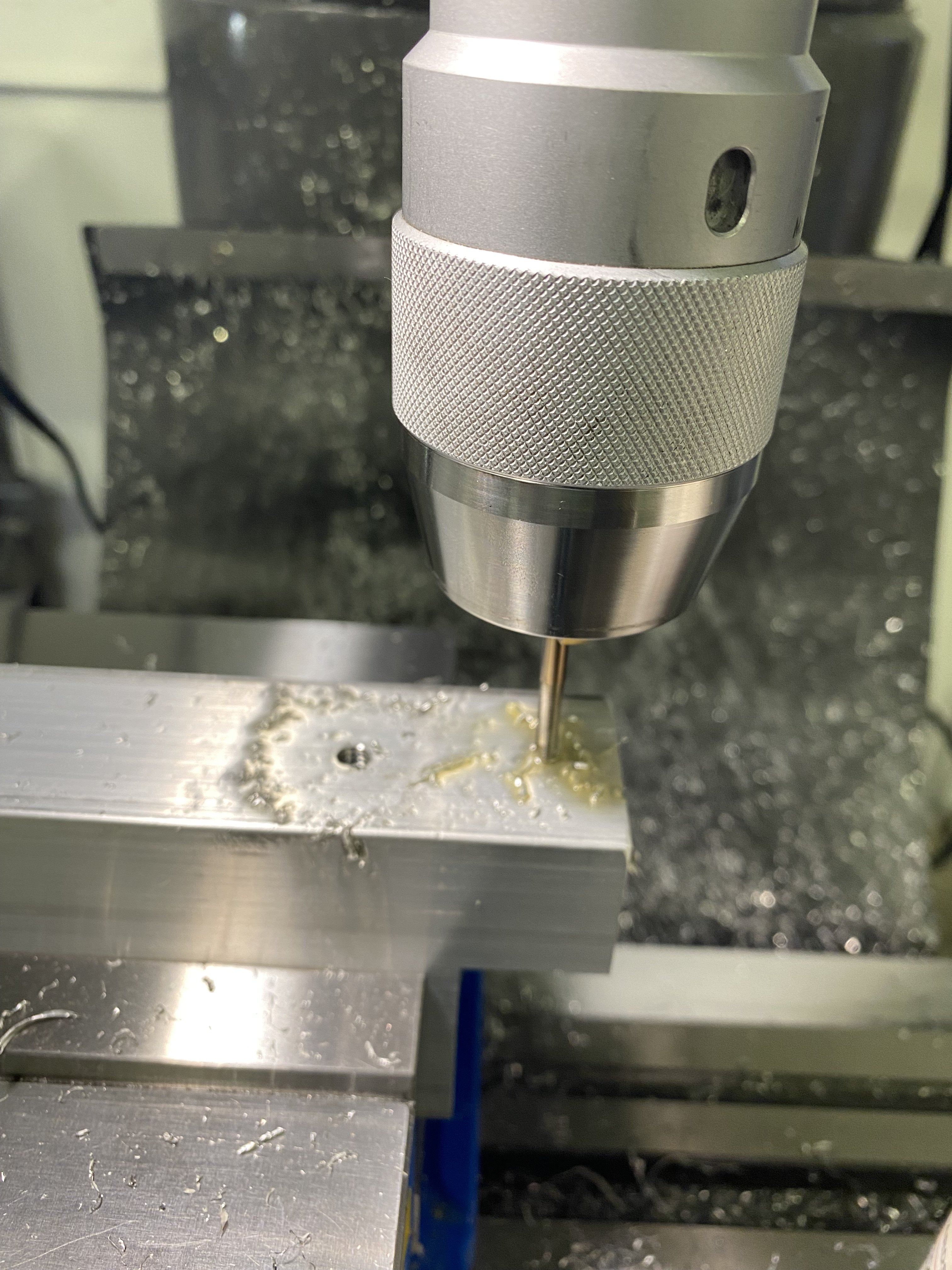

Plunging the transfer port, I used an end mill since I was drilling through the barrel channel, drill bit likely would've walked:

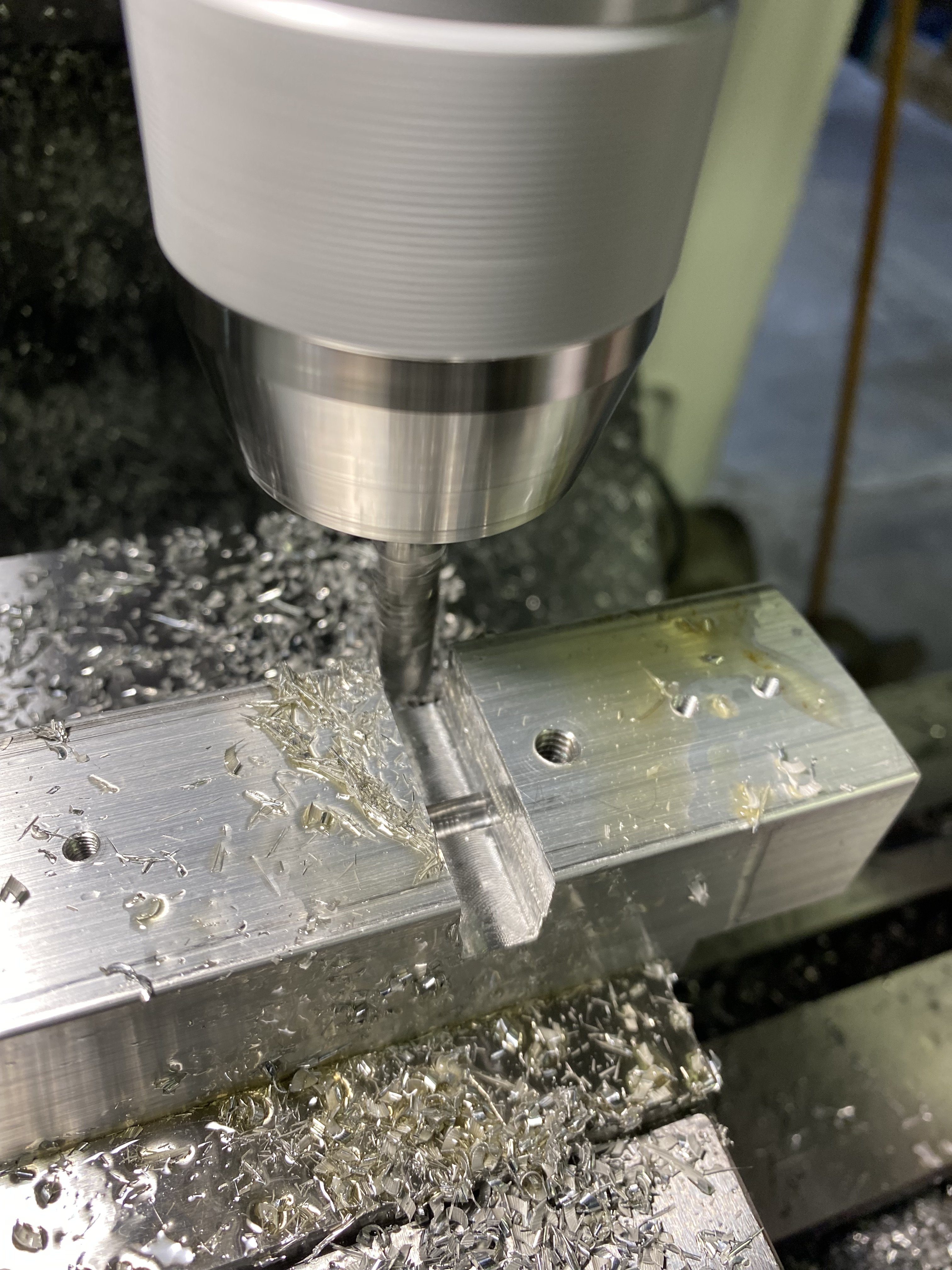

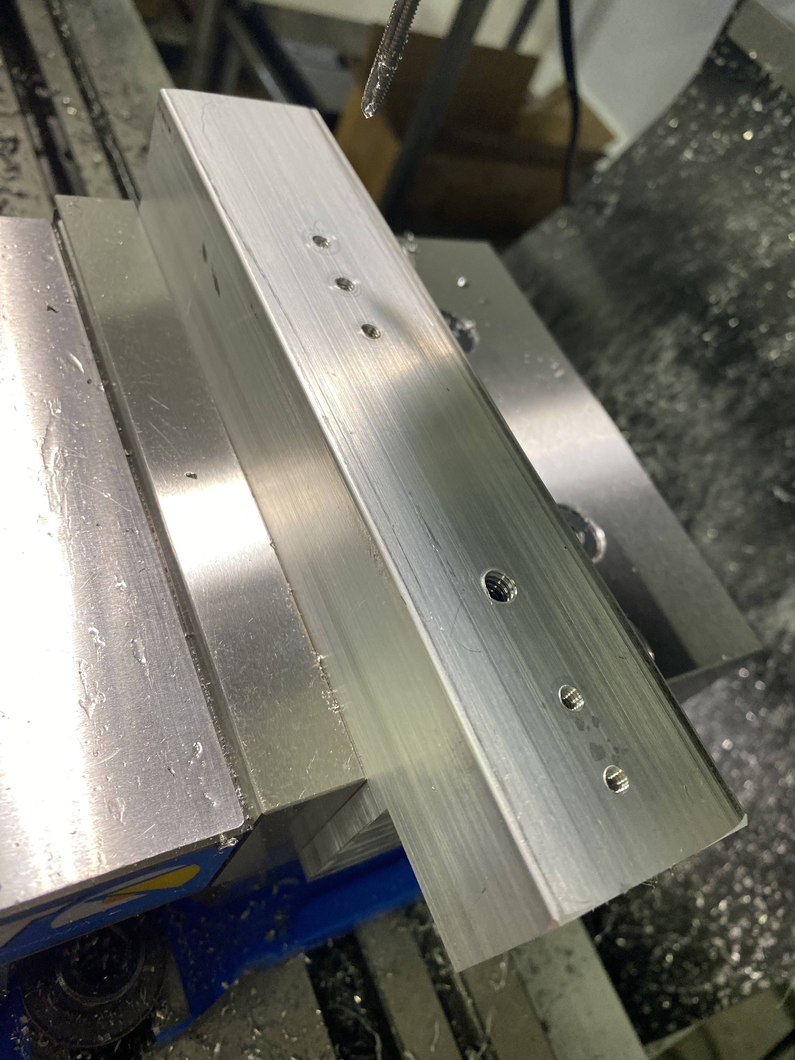

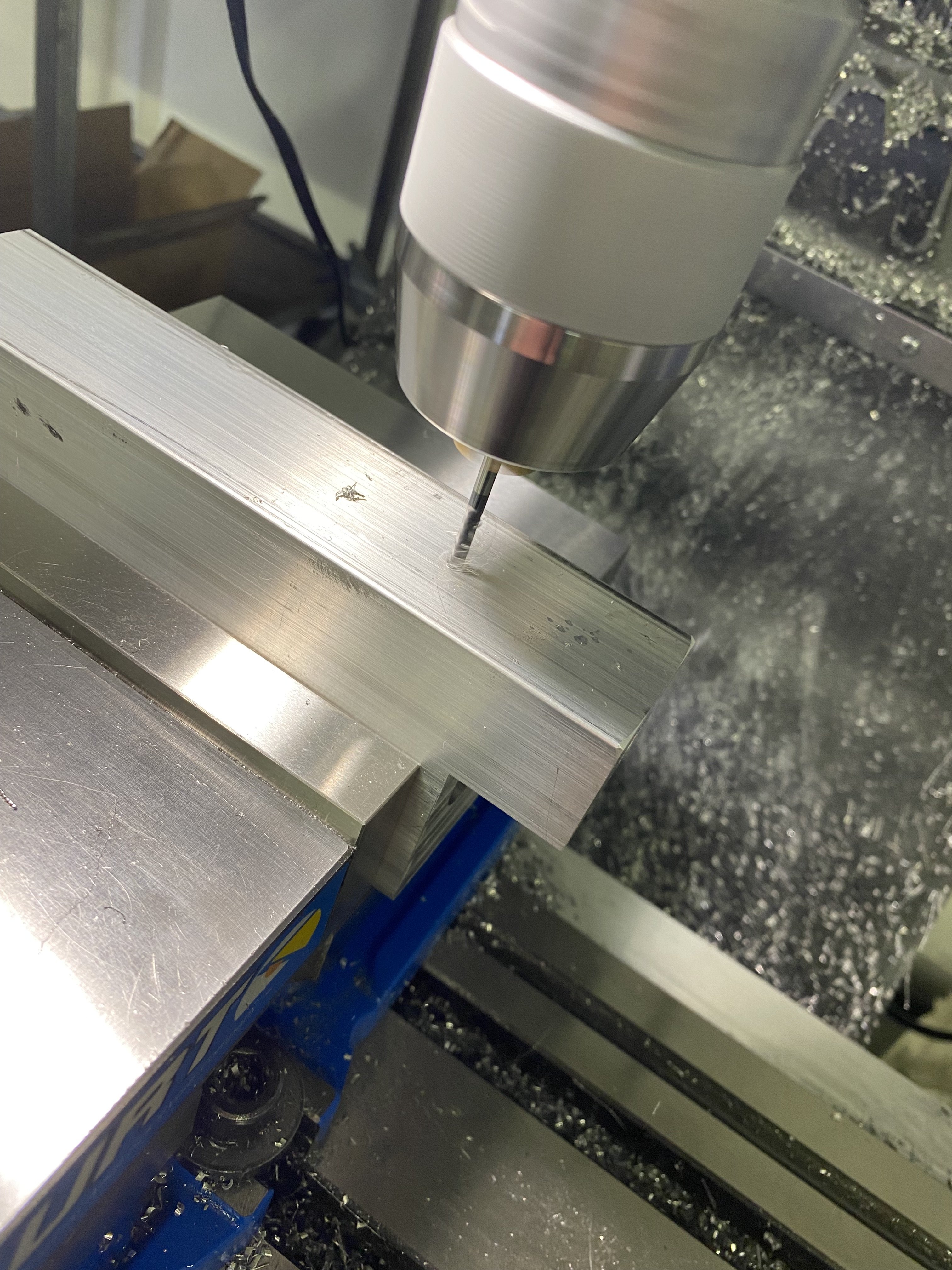

Drilled & tapped some holes for a pic rail, you know, in case we wanna scope this sucker. Machinists may scorn me for tapping with the mill: I'm lazy ok, if it's faster I'm doin' it:
Scope rail holes & transfer port plug tapped:

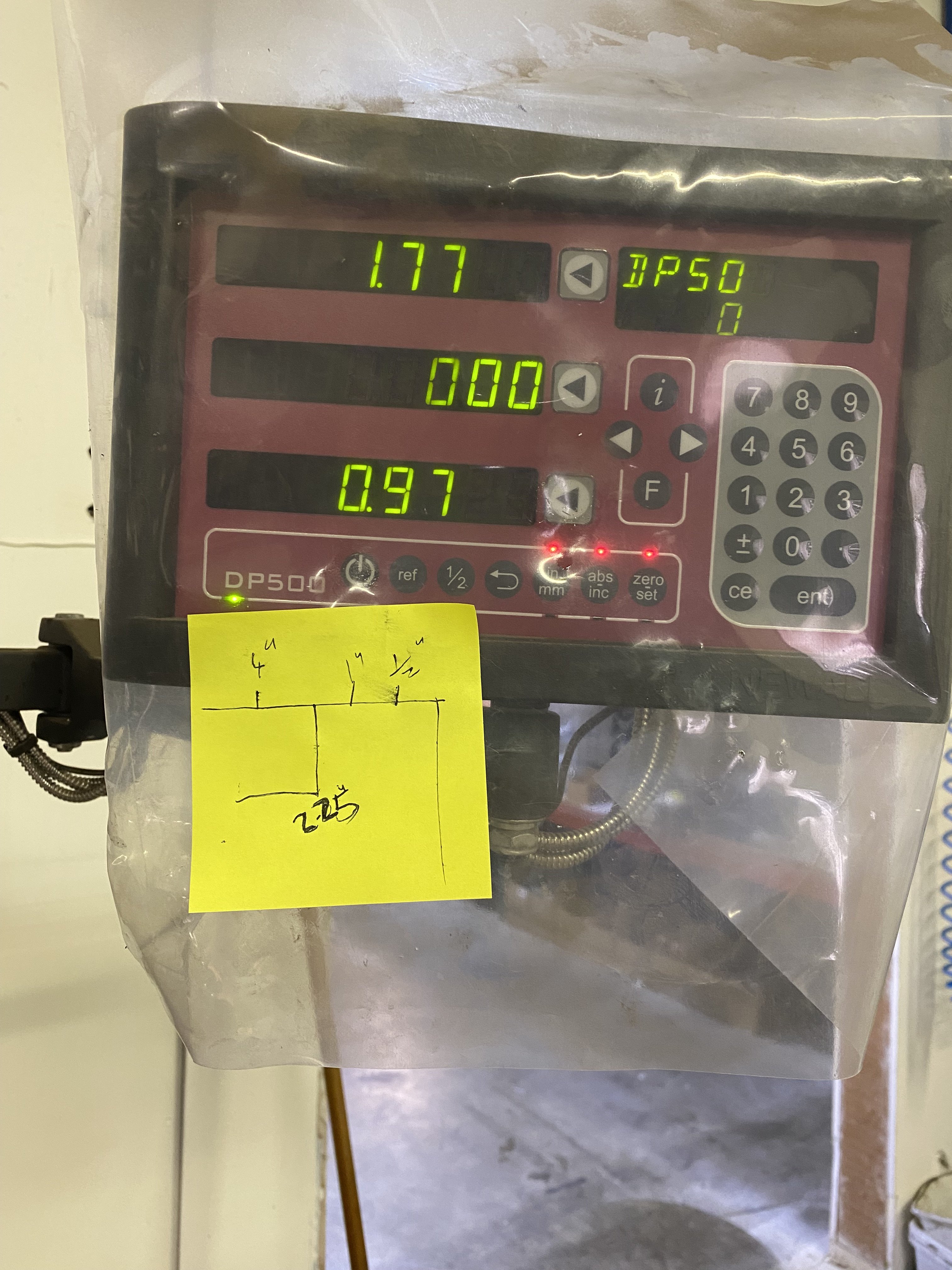

I always consult my meticulous technical drawings before I cut:

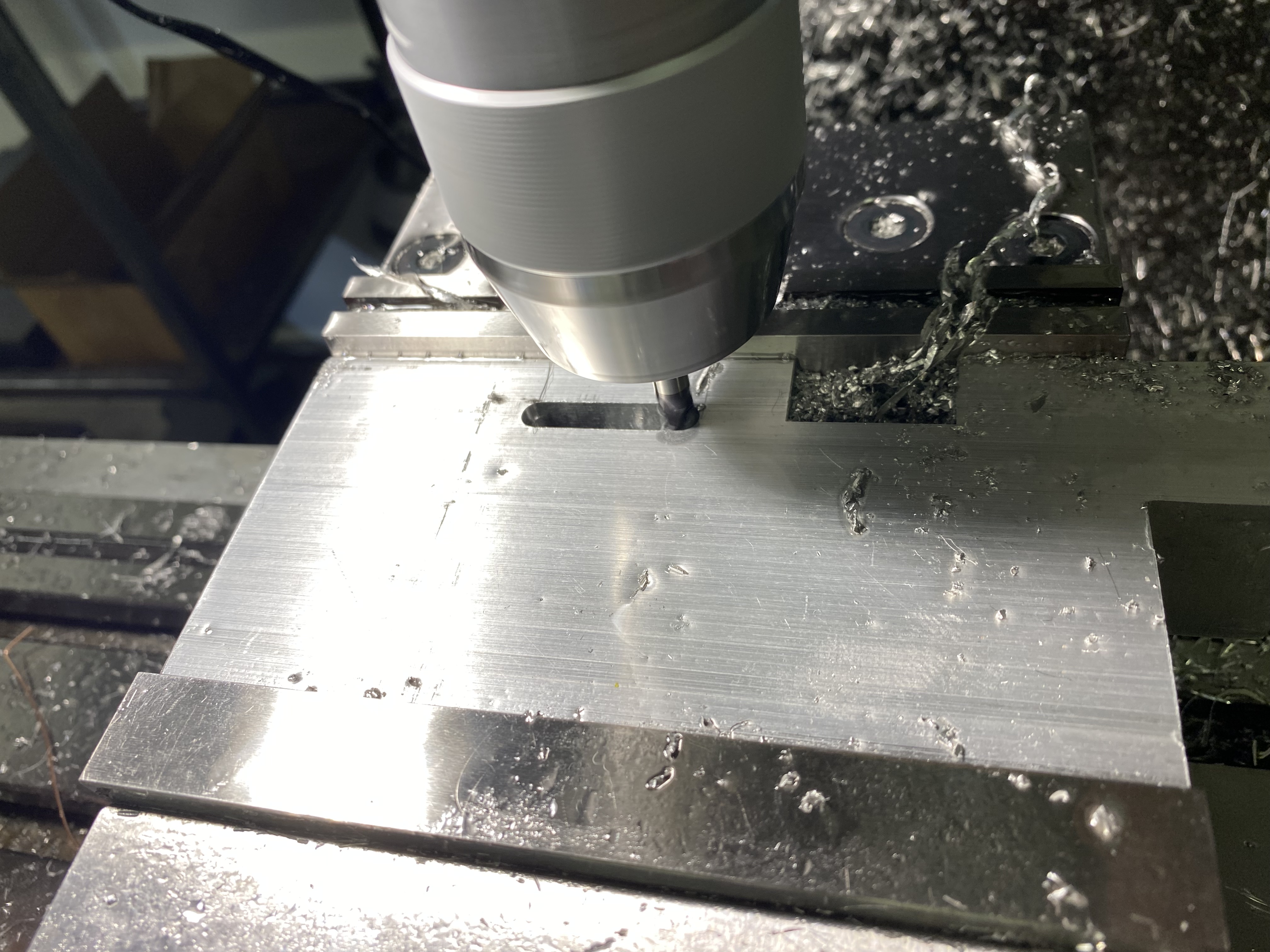

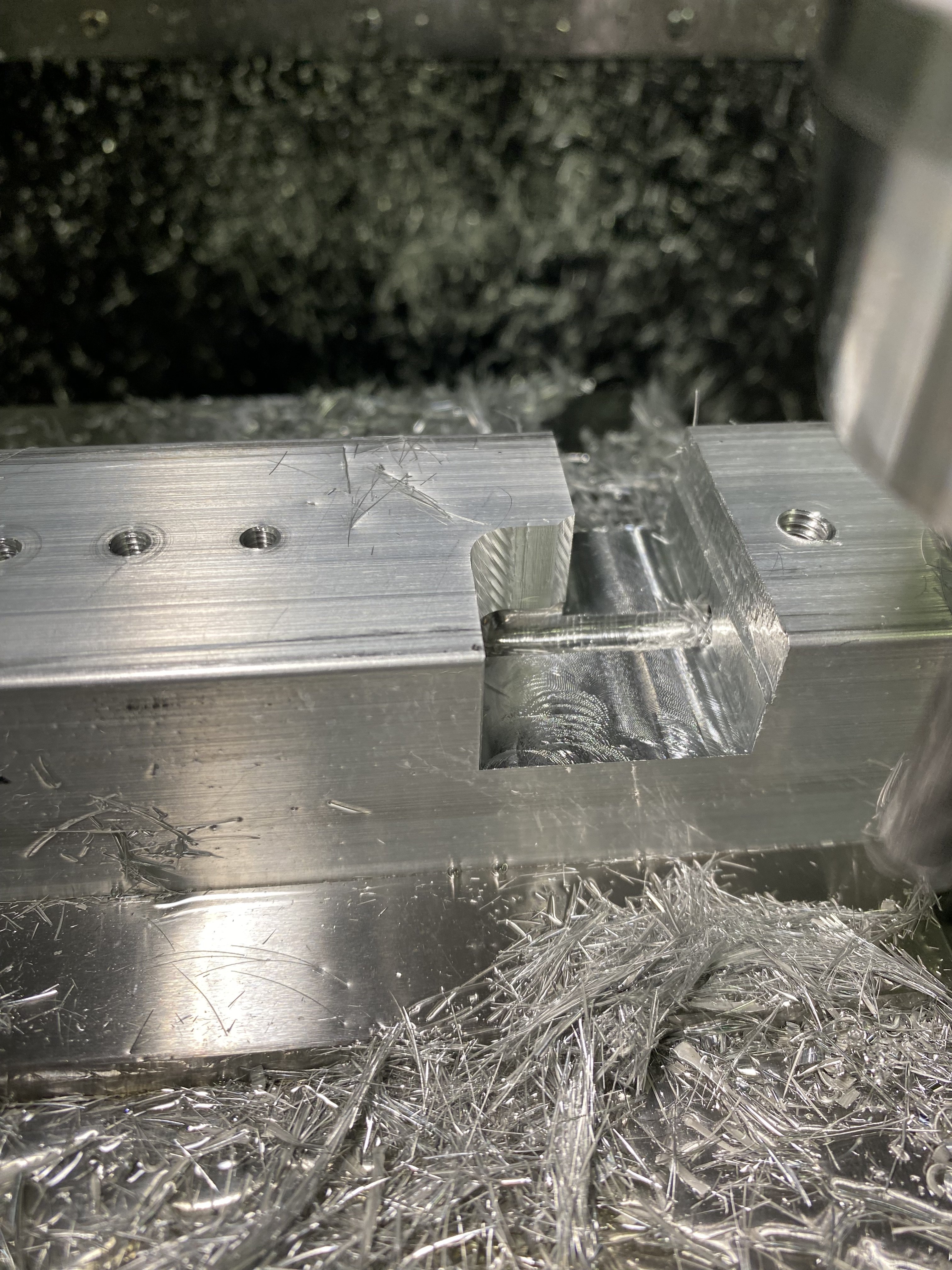

Time to cut the loading port:
Little more room:

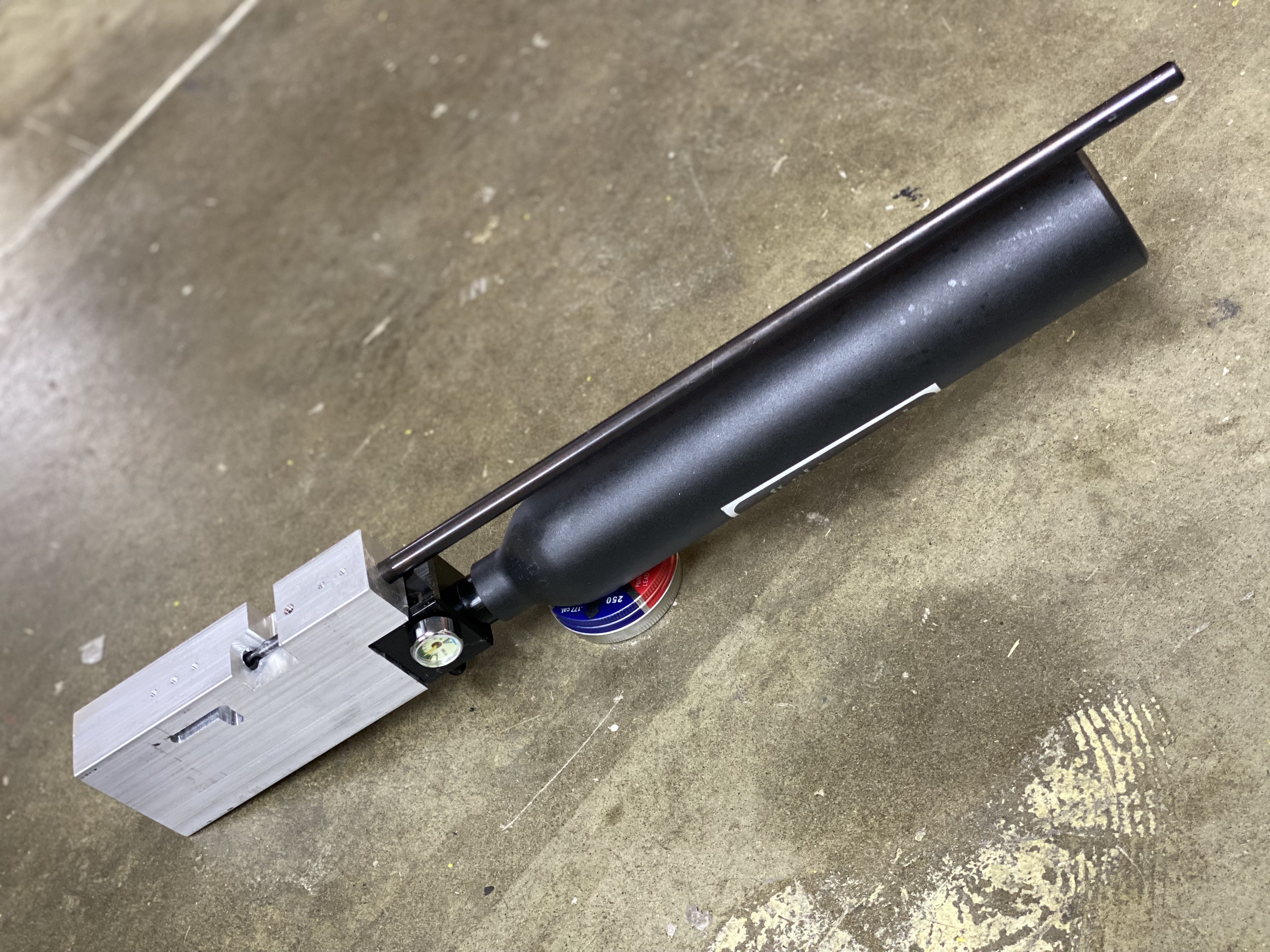

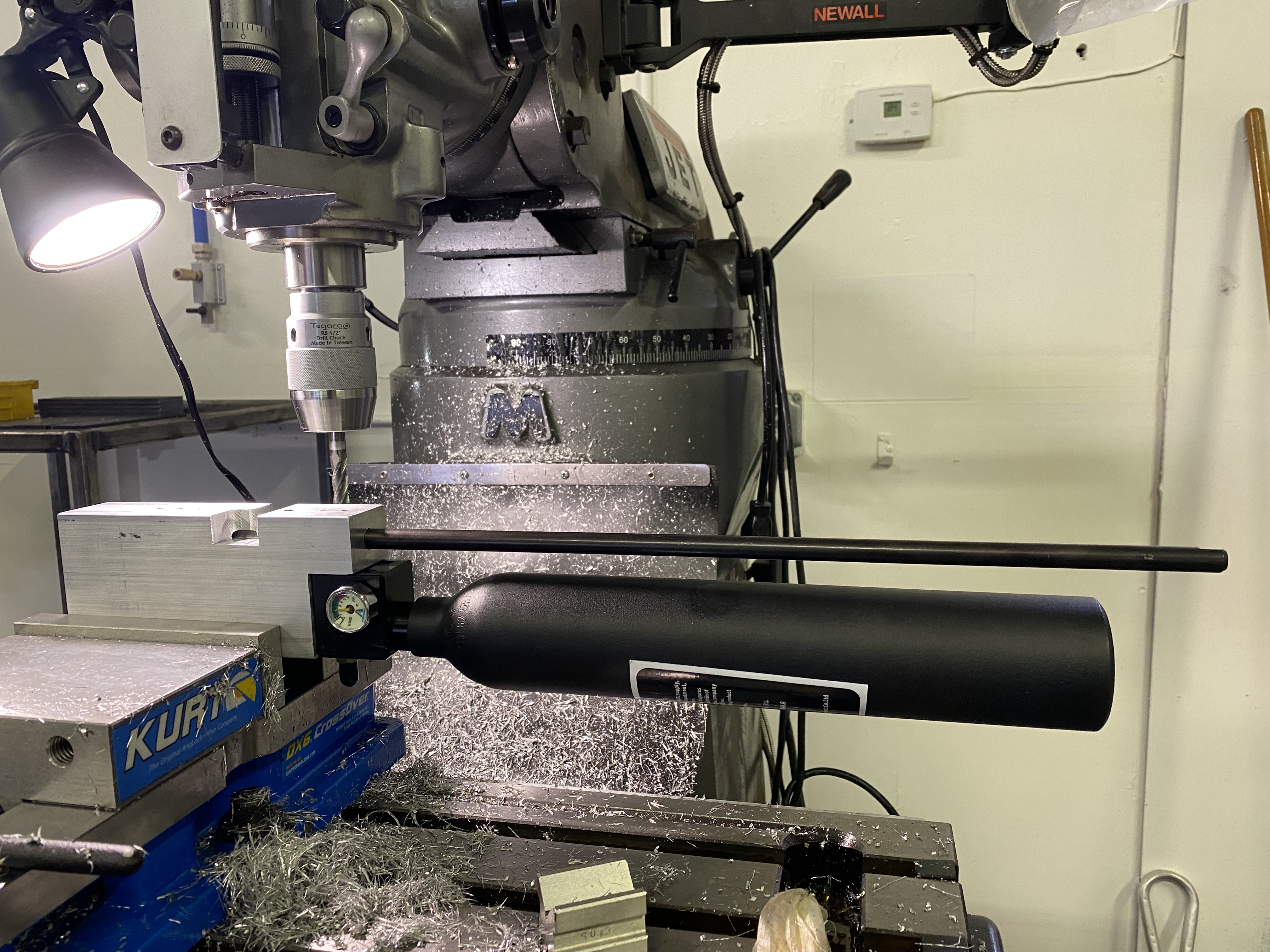

Test fit barrel, valve & tank:
Drilled & tapped some holes for a pic rail, you know, in case we wanna scope this sucker. Machinists may scorn me for tapping with the mill: I'm lazy ok, if it's faster I'm doin' it:View attachment 489161
Little more room:

Tapping with mill = great. Looking good. Holding endmill with chuck is a little dicey, collet is more rigid. Can't wait to see end reault.
Sorry! It's not that I don't know better, in some of the pics you'll see me using collets, it's just that I'm lazy. I take small cuts though, lotsa lube so I don't really have issues.
