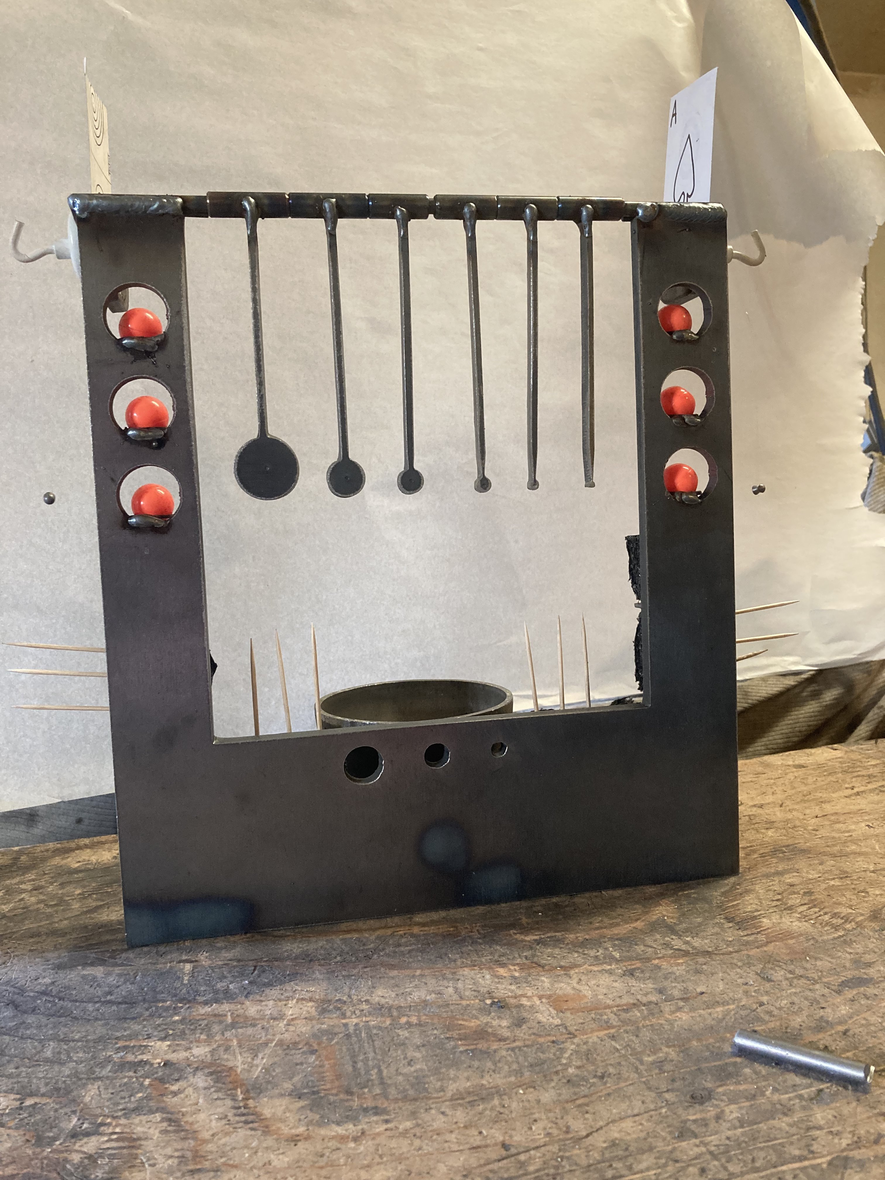

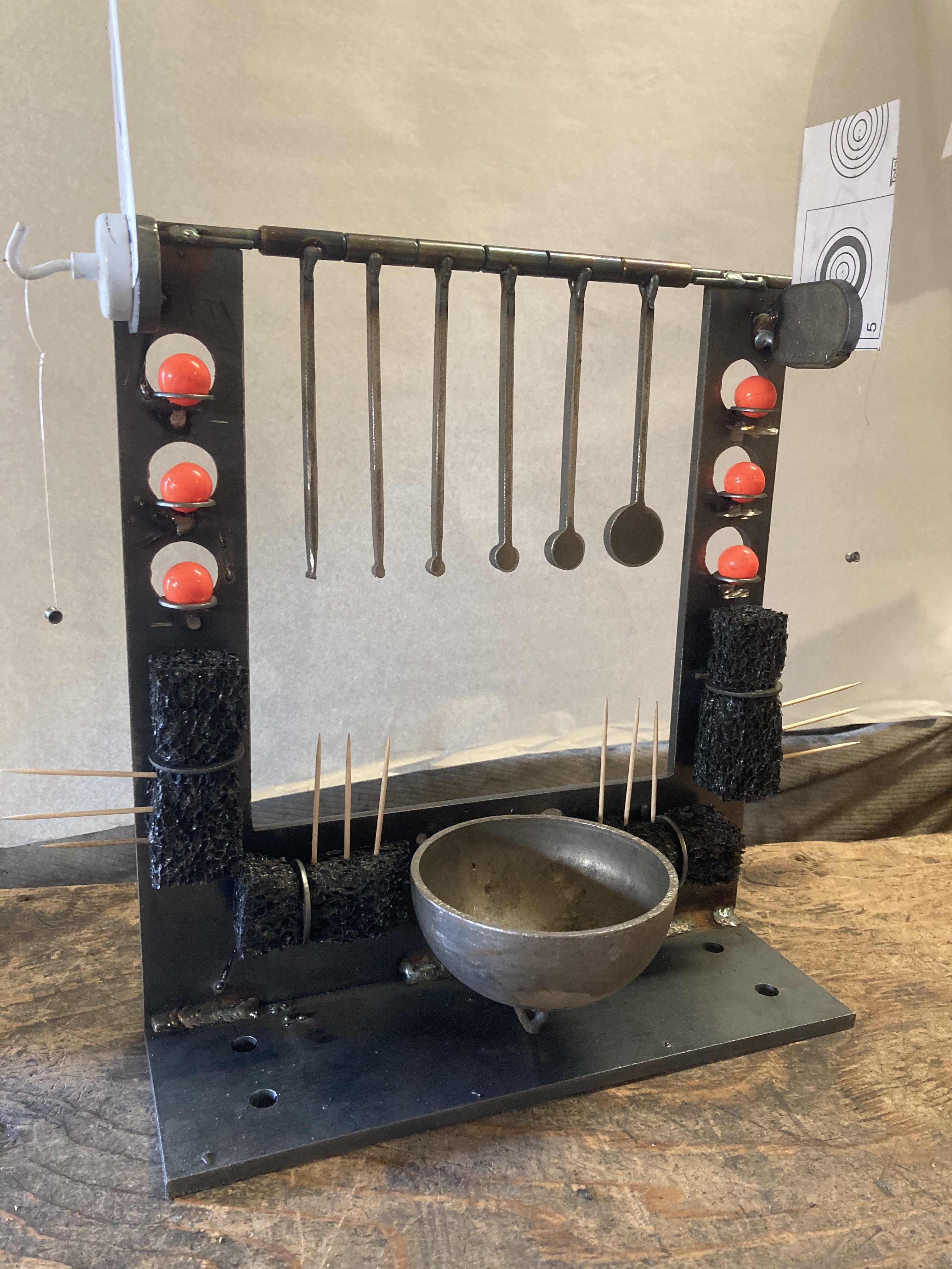

Here’s a shooting gallery spinner target I made.
I wanted to have many things to shoot to see if I could “ run the target without a miss “
It’s too hard for no missing, but really fun.
What is the bowl for? Does it ring when struck and if so, is it attached or just set there?
It’s a bell, actually it’s called a hemisphere, I use them in my metal art projects.
They ring loud and clear, it’s set like that so when you shoot through the holes in front you hit the edge of the bell and get a nice ring.
There’s a rod holding it in place and it’s got a weep hole at the bottom so it doesn’t hold water.

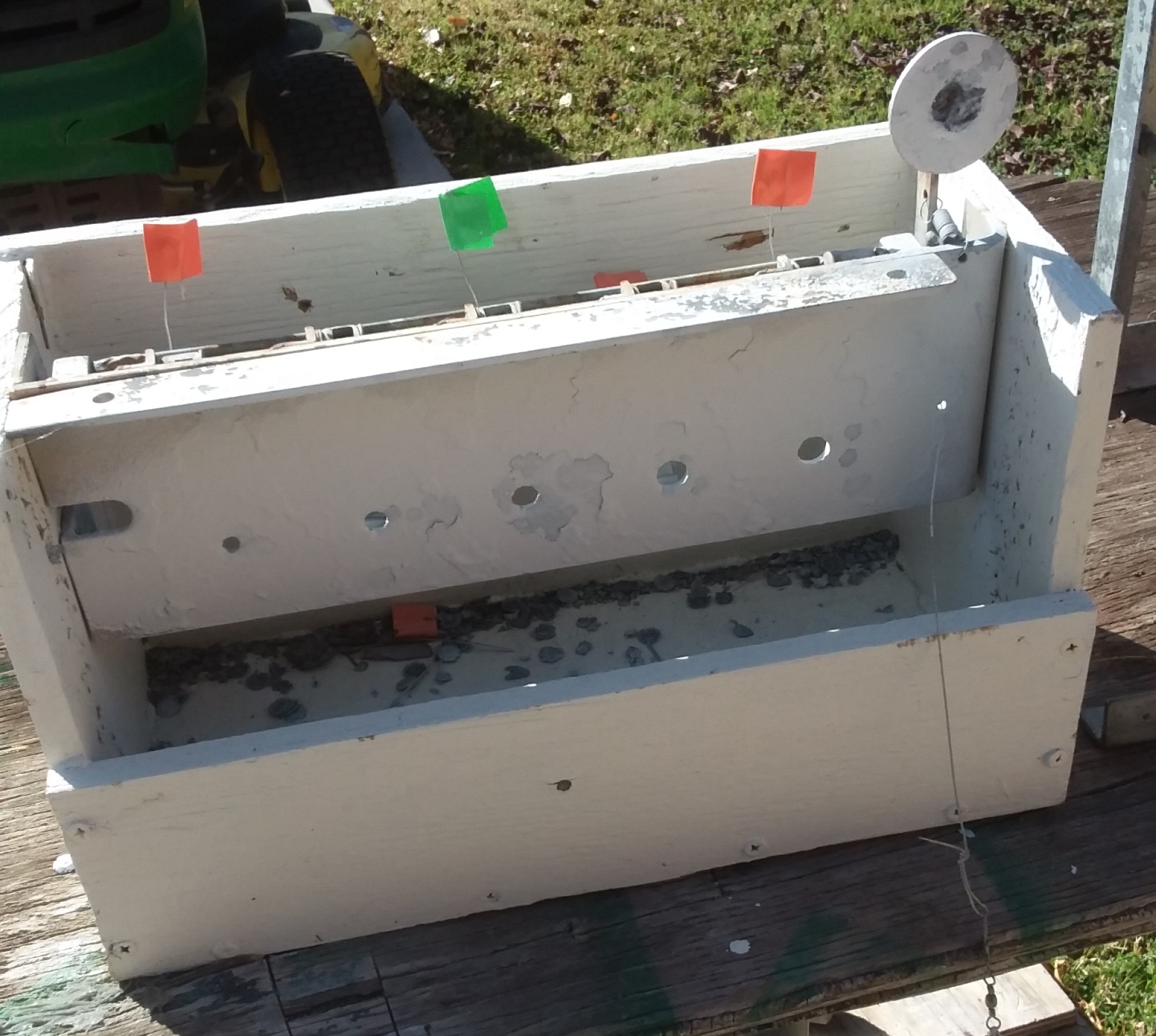

I like bells, so have made a variety with all kinds of things that ring. Nothing classy so I'm not posting pics but I thought this might be of interest.
It's a training aid for me for offhand and some FT practice from 30 yds or so. I made some sear type latches and when you shoot through the hole, the flag will latch. It's reset by shooting the upper right disc or pulling the string. The box captures a good bit of the lead. The right 2 holes are 1/2" down to 5/16" on the left. It latches pretty well from 5 ft lb up to about 20 ft lb. It's one of my favorite and most challenging targets.

I would like some pictures of your mechanism if you wouldnt mind thanks
