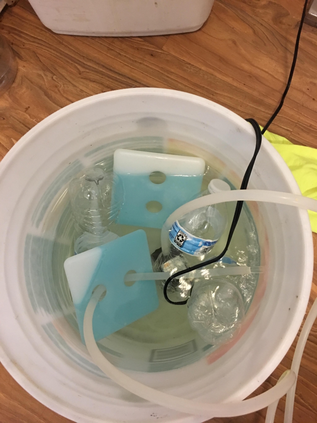

I fill my sink or a cooler with water then put a bag of ice or a bunch of frozen bottles of water in it. Once the water is really cold I start to fill everything. I think the last fill which was a few days ago it ran around the mid 50c. If it ever gets up to 60c I shut it off and let it cool a bit before I start filling again and I also only fill no more than 5 minutes at a time before letting it rest for a minute or two.

Fresh oil change this is temp after filling 60min scba 2900-4200ish I use a lot of ice in the bucket tho. Knock on wood never really had problems with it. Just frozen water bottles they seem to work well for me

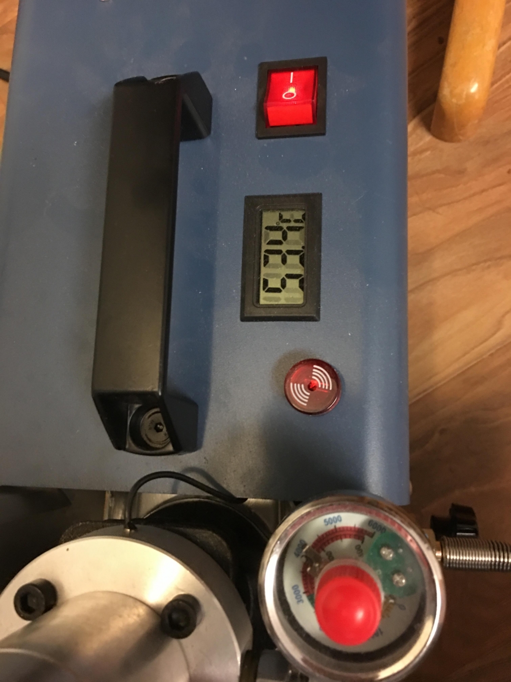

the first pump that came with my yh quit working I just went to Walmart and got a small aquarium pump not sure of the gph of this one or the one that actually came with the compressor but at the end of completely filling two 90ci bottles and topping off a 60min scba this is the temp I’m seeing but I also put ice in the bucket as recommended hope this helps

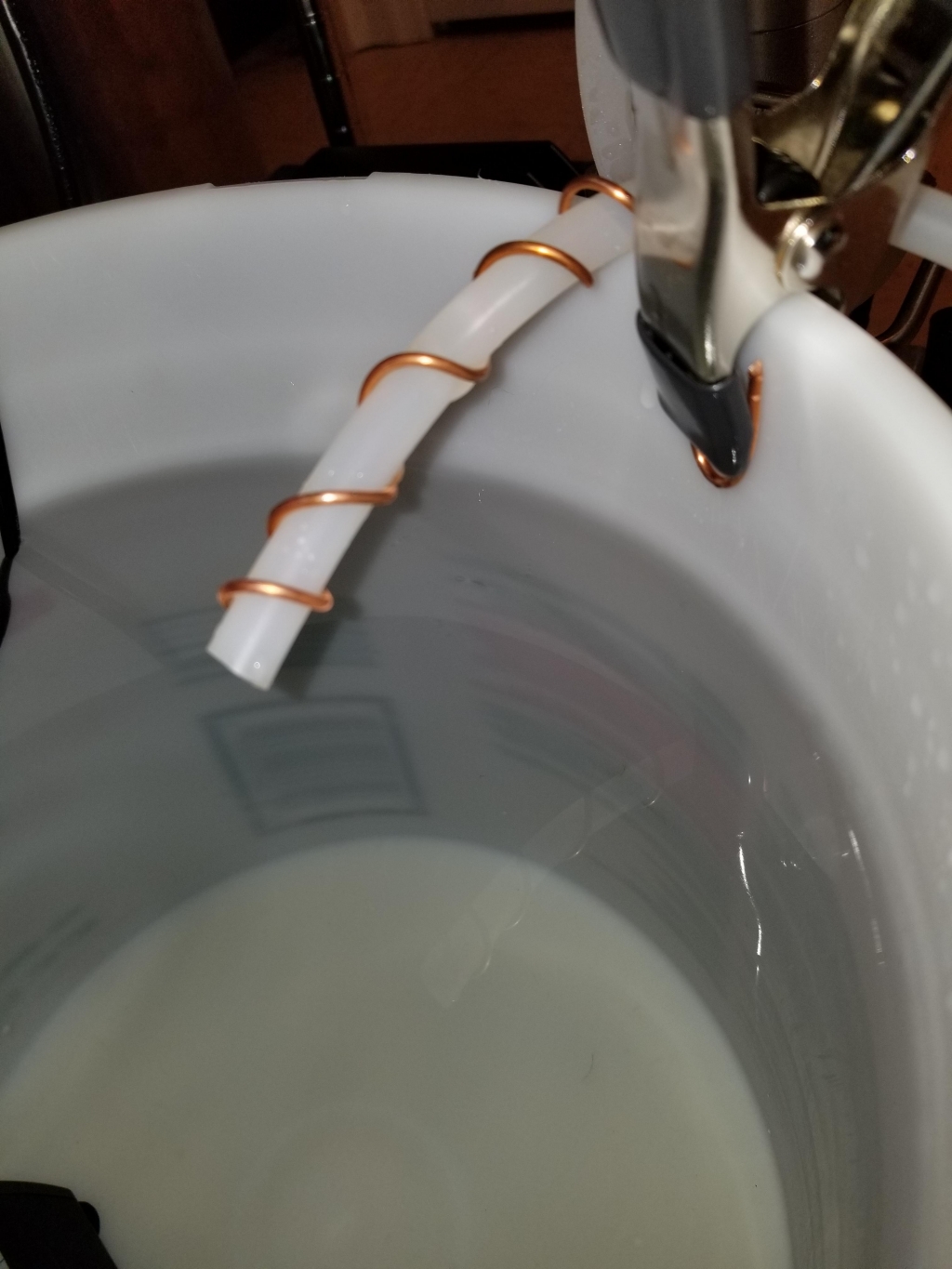

I still have the factory pump with mine and it works great. I do keep the flow rate set to the minimum to allow the water to flow slower through the head and conduct more of the heat. It would run a bit warmer if I ran it on high so I played around and found out low worked best for mine. I'd imagine with a cheap pump like these not all will run the same but if you do get one try out different rates and see what one works best. One other thing I do is keep the return line above water so I can see if the pump is still working and water is still flowing.

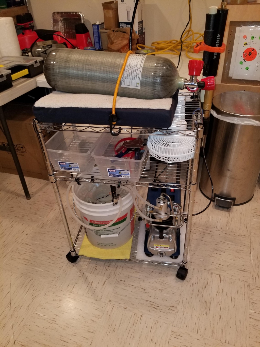

This cart off of Amazon worked out really well for my Yong Heng set up. Cart was around $30. I added a $9 six inch fan to aid in cooling. The plastic bins for misc storage were $1.18 at Home Depot. I stapled a towel to an old plastic cutting board and set the water bucket on it. This helps keep water off the floor.
A piece of copper wire wound around a dowel hold the water discharge line where I can easily check on water flow. I have a three filter set up. First filter is the one that came with the Yong Heng. This catches any oil blow by. The other two filters are filled with desiccant with color changing beads (small gold filter then a larger Airmega). After a fill I change out the Yong Heng tampon filter and check the small gold filter. If the beads are ok in the small filter then I don't have to open the large filter. I run the compressor using Royal Purple oil and plenty of ice in the water bucket. I keep the run times to 15 min or less with moisture purges every 3-4 min. Temp has not gone over 45° C. I also added a vibration activated hour meter to keep track of oil change intervals. Grand total for the whole set up including compressor, 6.8L tank and valve, filters, fan, cart, fill whip w/ foster fittings, inline one way valve, Royal Purple and 13x molecular sieve = $630.
Still $170 cheaper than the Omega Trail I bought and has already lasted longer and pumped WAY more air.
