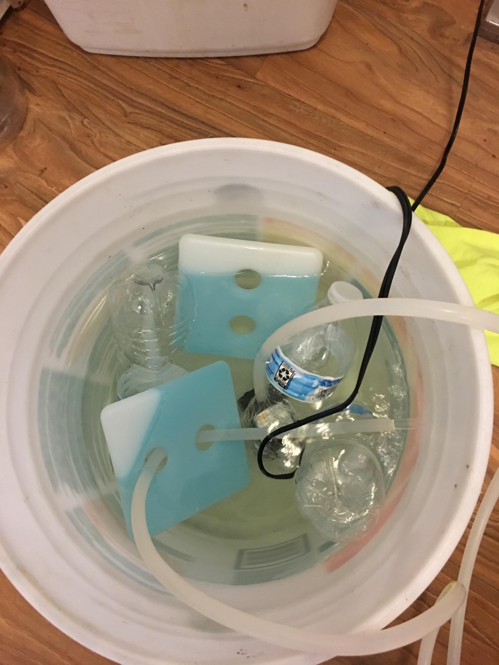

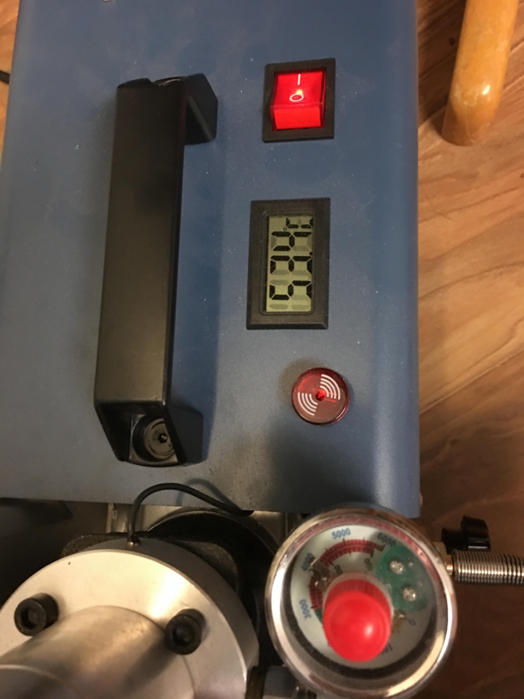

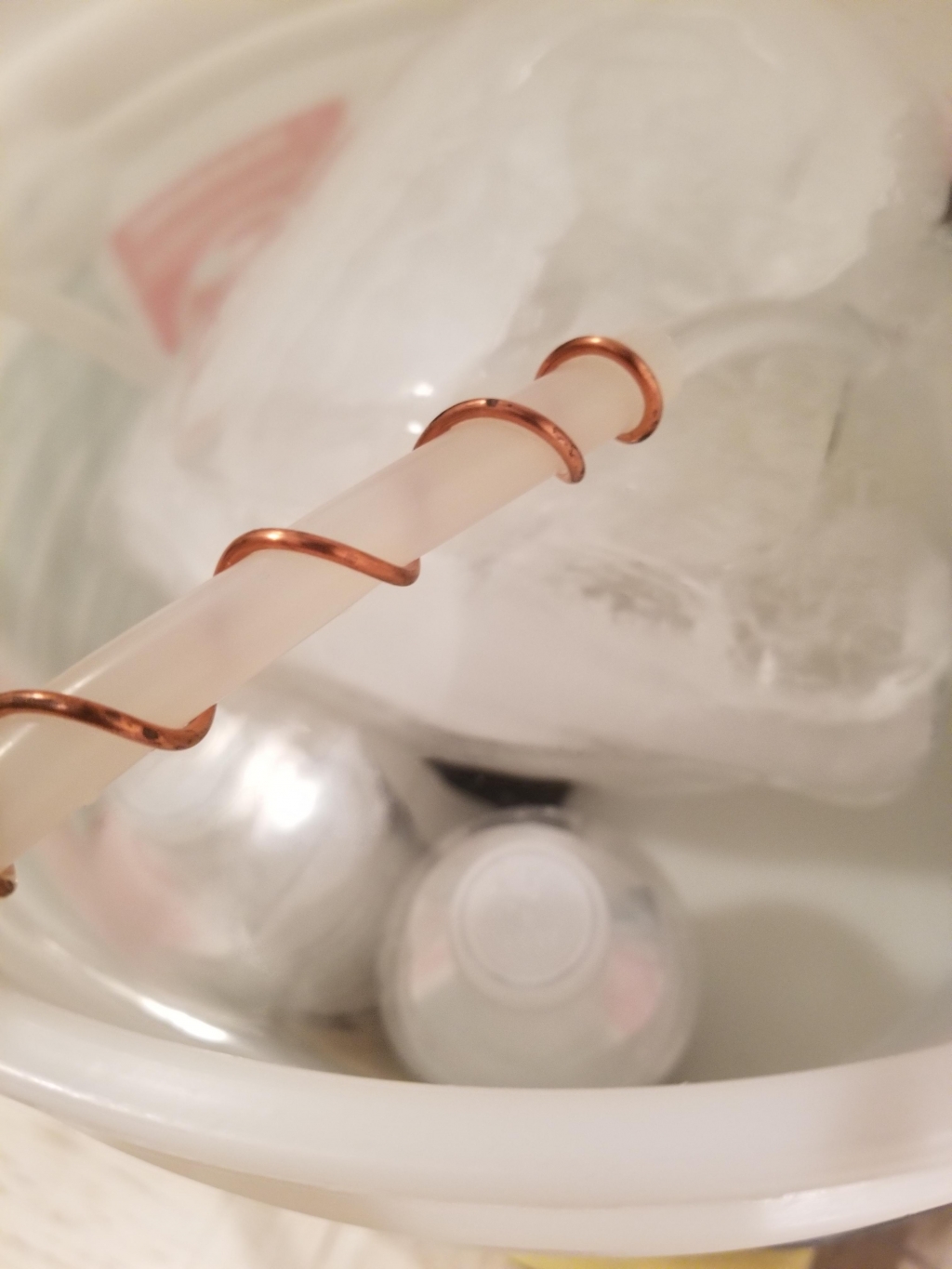

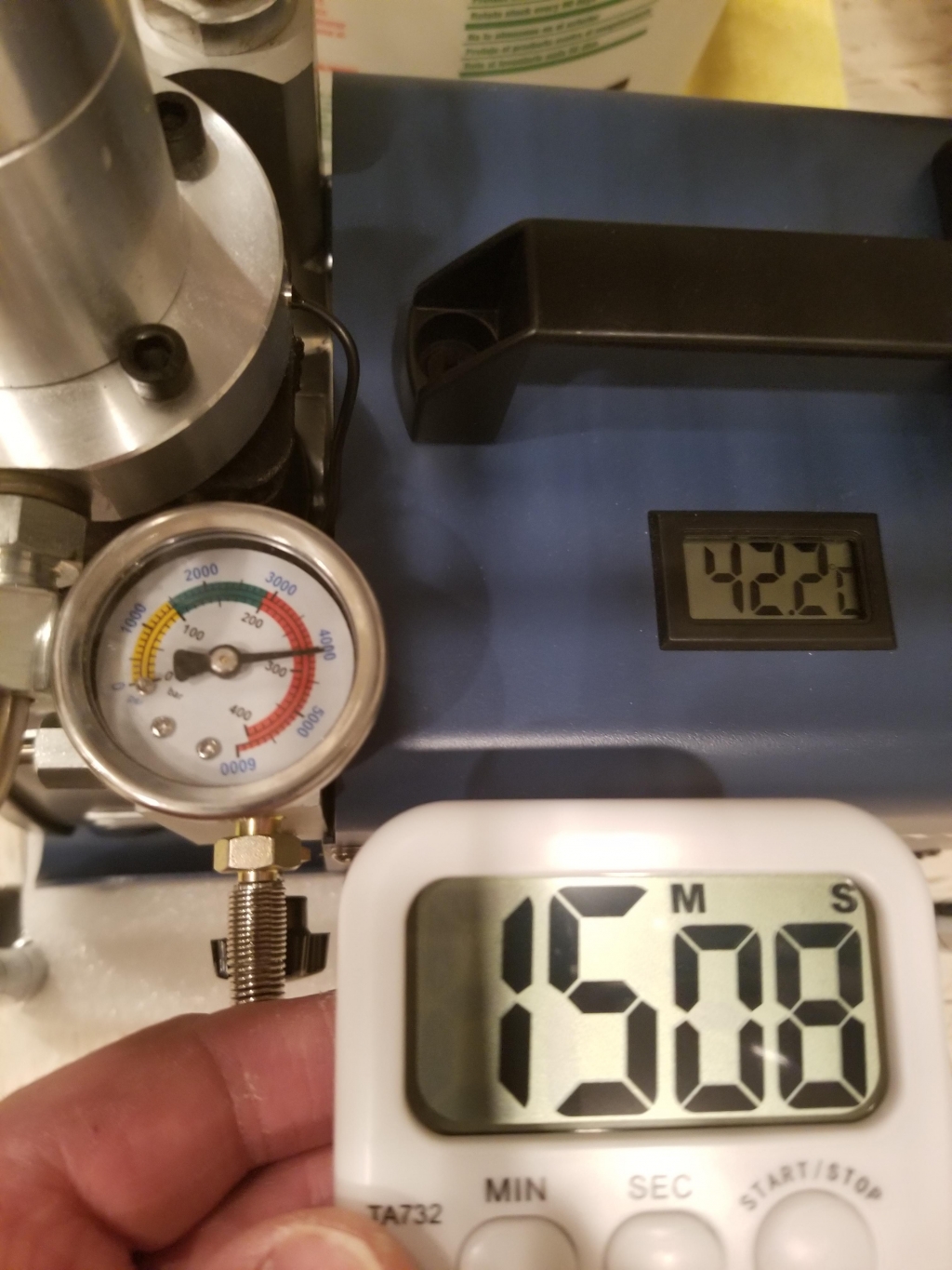

I think you guys are a bit over concerned about the cooling temps. and comparing to others is not helpful unless you state the ambient temps you are working with. in the So Cal desert here, both of mine ran at over 65C and one accidentally got up to 120C once when the cooling hose got pinched shut. the summer temps in my shop get over 95F and even with the cooling bucket full of ice, head temps get over 60C in less than 10 minutes......just filling up the water separator cylinder (about 2 minutes), gets the temps over 55C. these temps are really not very hot when you consider that 4 stroke gas engines run 200 to 220F cooling temps.
