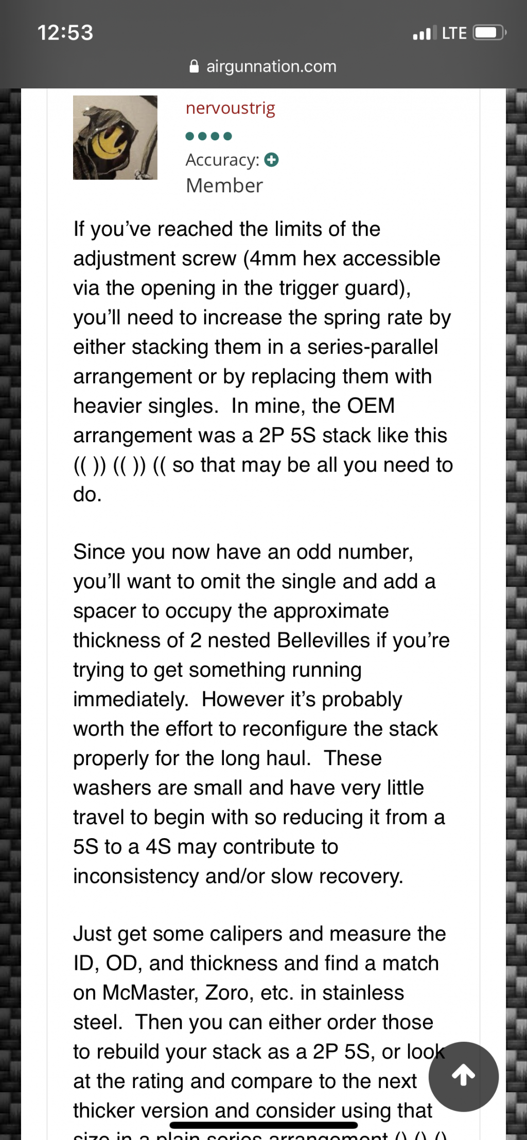

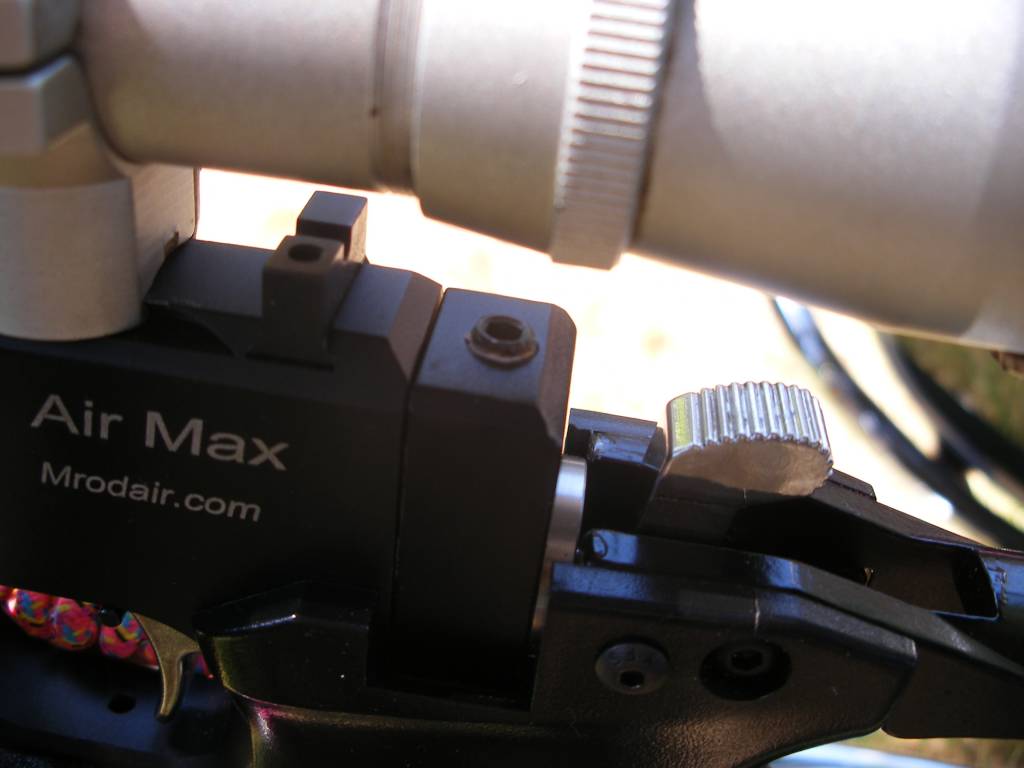

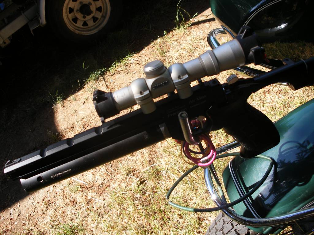

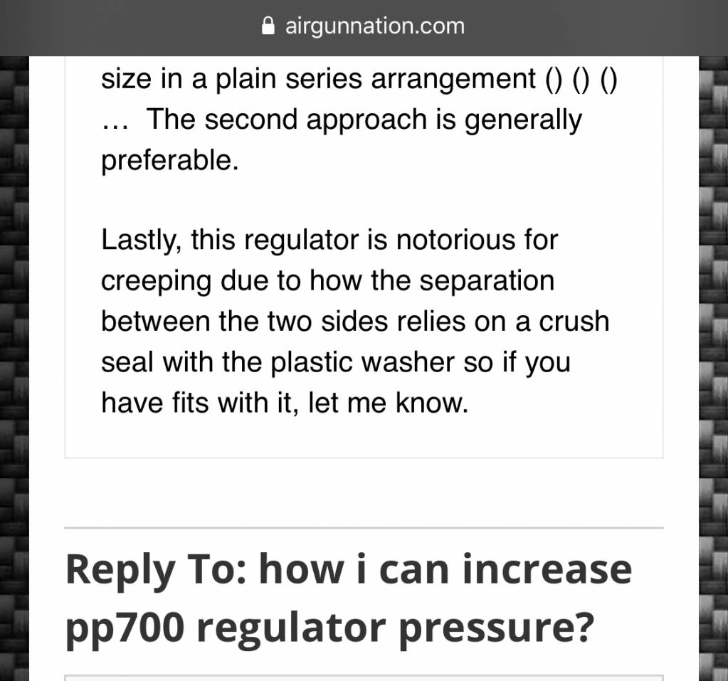

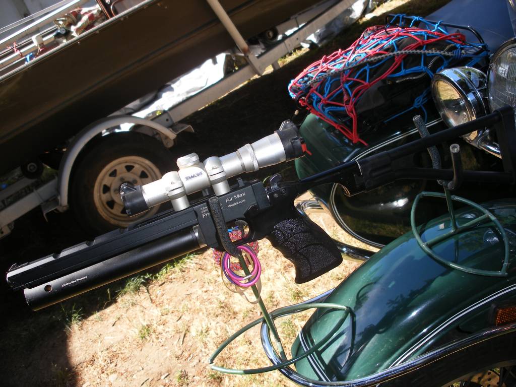

Wellgot me a pp700 the other day.Made a few adjustment and got it up to 620 fps. in 5.5mm.Had to .Back it out two turns.Played with hammer ,spring didn't do much.The little allen on top of the swing loader made the differance.Went from 540 to 620" put the little scope on it and a folding stock.W
OW" its a keeper"
