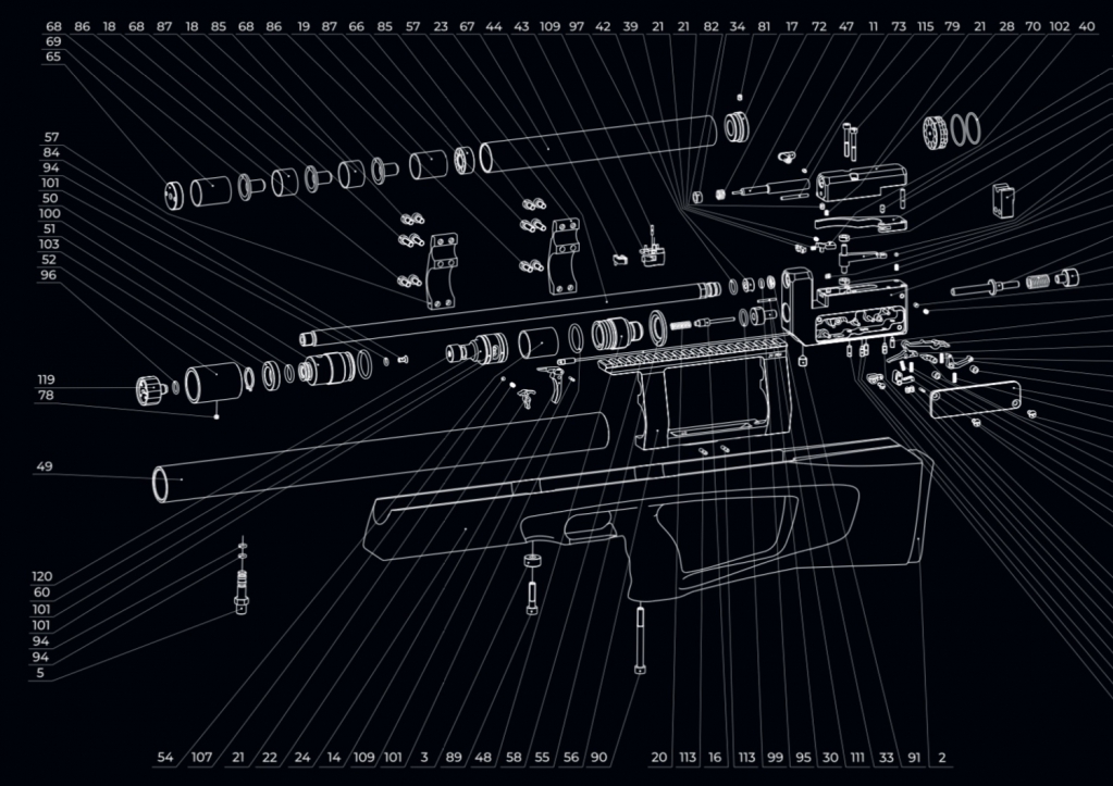

You may find that replacing your reg, that the gun still leaks air. It might be a good idea to replace all O-rings. I did a Veteran O-ring re-seal job a couple years ago for a friend. The main culprit on his gun was the O-ring the sits between the air tube and the receiver block. I believe the part number on the Veteran exploded diagram is #99

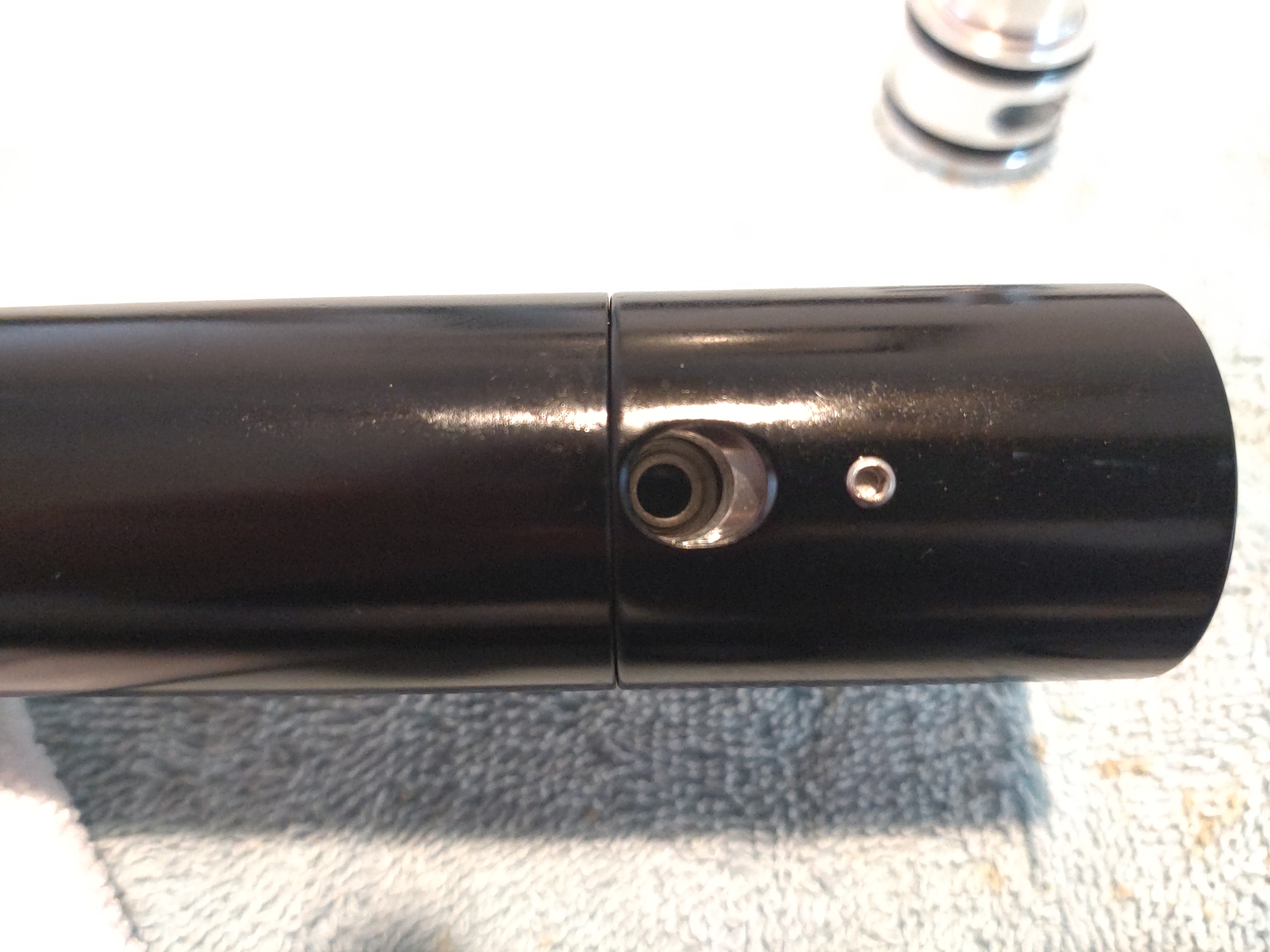

I decided to try checking the barrel so I started filling until it got above 110 bar and put some soapy water on my finger tip and placed it over the end of the barrel. Sure enough, that's where it's coming from. I'm not a rifle expert so where do I look for that type of leak on a Taipan Veteran .25?

Do you have a schematic of the gun? If not, there have been posts on AGN with the photo, that way you can identify the O-ring.
Did you try changing the o ring behind the gauge? Recently one of my taipans was having an issue with leaking and I changed all o rings except for that one. Guess which o ring it was after the 20th time opening up the gun...
Like you, I opened up my buddies gun several times, thinking I knew where the bad ring was. Next time I do a re-seal job on a Vet, I'm opening it once and replacing ALL O-rings at the same time.

Where is that located on this diagram
OK. I finally got the o-ring (#99) out and replaced it but not until after taking out the valve and lapping the valve seal to the face of the valve with some Tormek polish I had. In the meantime, my Huma-Air regulator showed up. The only problem was their plenum was not long enough so I had an old one that I cut a piece off of to make the regulator line up correctly in the air tube. I then filled it to 250 bar and it has been holding for about 2 hours now with no noticeable leaks. If it continues to hold I will tune it tomorrow since the weather is supposedly going to be nice here. Thanks for all of the help everyone!!!
