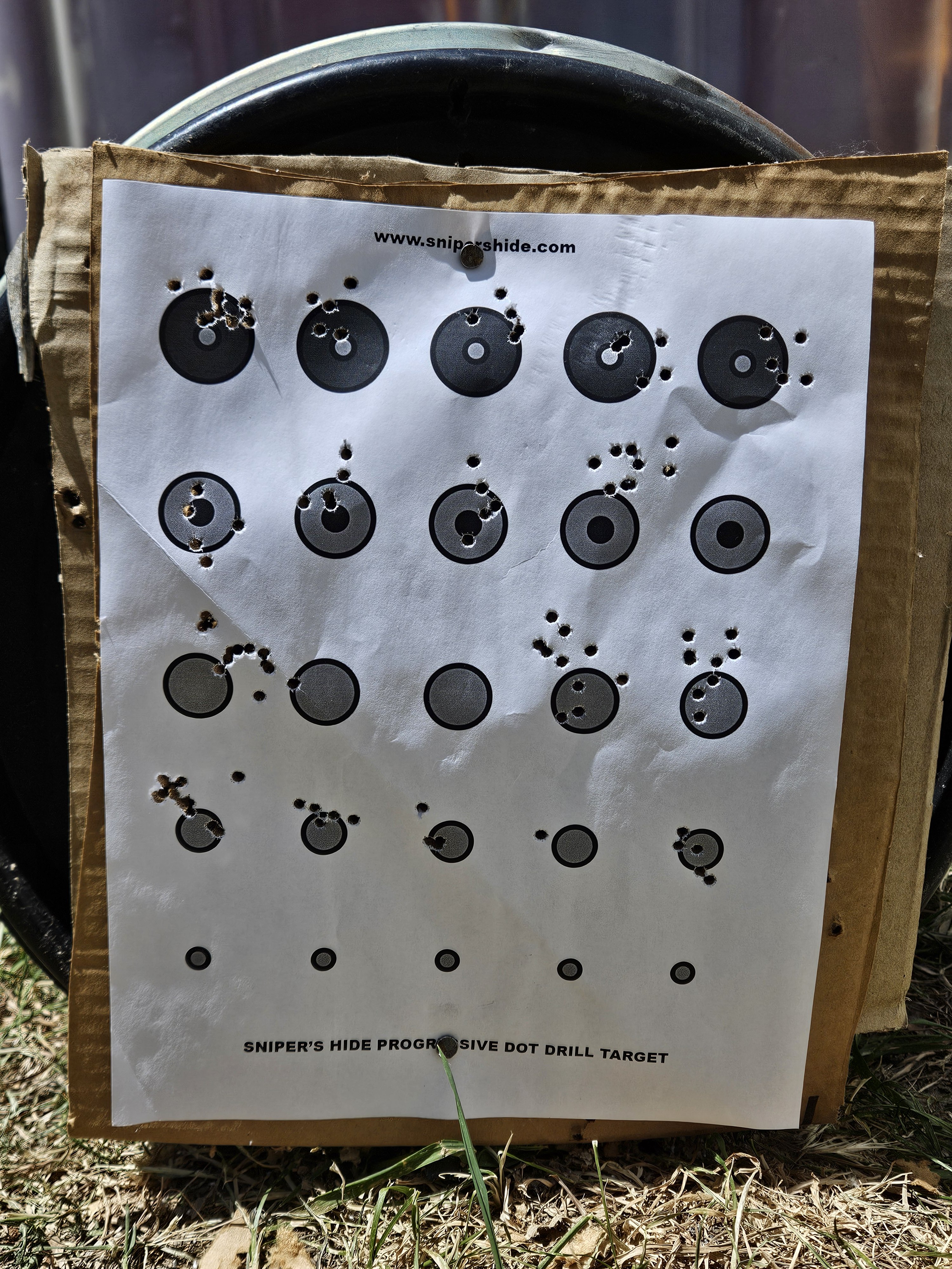

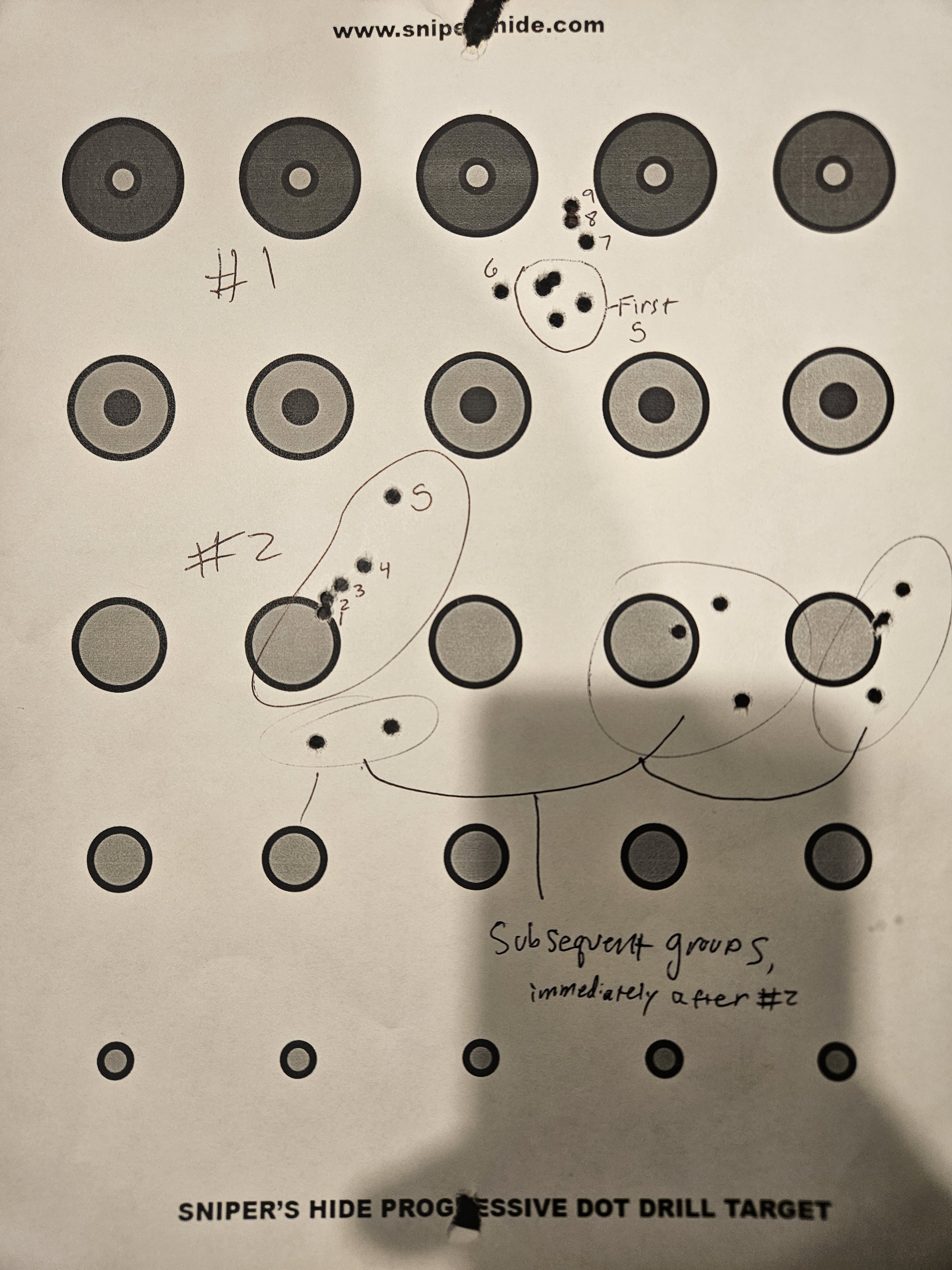

Alright, I'm turning to the pros here. I have been shooting slugs out of an RTI Priest 2 in .177. This has the standard LW barrell. Not polygonal.
My standard practice is to burn a shot to get the reg leveled out. My first 5 shots will easily be .5" at 50 yds. If I go for 10 shots in that group, they will open up to as much as 1.25". If I wait for a minute and start a new group, it's back to all holes practically touching. Again, for about 5 shots. Then they open up significantly. It is very repeatable. It strikes me as similar to what one could see with a powder burner as the barrel heats up. What would cause it on an air rifle? I wonder if the regulator still hasn't fully settled in or if it is just a harmonics issue??
I would say that maybe it just isn't grouping but the first few shots are ALWAYS tight. The attached picture may not be perfectly convincing but I could shoot a sheet of tight groups if I only did 5 shot groups with a rest in between them. Maybe I'm just dense. Any ideas?

I am usually shooting over a chronograph. I have a pile of different slugs in different weights and diameters. I have settled on the JSB KO in 13.xx as the most consistent. They work well at about 960fps. I'm not getting major deviation when the groups start to move around. I suppose I could be rushing larger shot count groups, but not enough to start seeing them open up as much as they do. The part that's really getting me is that if I wait 30-60 seconds, the groups are tight again. And I highly doubt it is shooter fatigue.

. . . I put the .177 barrel back in it and w/out changing my tune at all I just started shooting these .177 ko's. I had to adjust the scope after I figured out where on my little test target it was hitting but boy oh boy - once I did - holy mackerel! The attached photo is the 10 shots from the imported chrony string. Granted only 28 yards but as I've learned from some of you - get it nice & tight close first - then take it out longer at 70, 80, 90, 100 yds . . . that's going to happen tomorrow.
This is just off of a kind of rickety table on the deck at my house and shooting off of a bipod - no sand bags or anything like that at the rear. I'll sand bag it and get real super steady at the range tomorrow - but for down & dirty, 10 shots and not even having changed my tune at all. I'm kind of a happy camper. :)

I second what Headshots said about barrel cleaning. Your “first 5” group looks like what my slug guns do when they need cleaned. Then its back to cutting holes at 50 after the barrel is seasoned again. After a good cleaning be patient for the first 10 shots or so as your slugs walk around a little before they settle into shooting in the same spot. If they never settle into a tiny cluster, its back to work.
The problem with not being demanding enough to have all your slugs basically touching at 50 is this. If you are happy with a 1” group at 50, many guns can shoot that a decent percentage of the time and not even be close to using the right components or settings. When you are on the edge of a horrible tune/setup, nothing is ever consistent. Or the only thing that’s consistent is fliers. Good luck.

Looking at the target you posted. I don’t see a gun/slug combo accurate enough to judge anything. I’m not being a wise guy but you haven’t found the right combo/settings. You’re not shooting groups, you’re just putting random holes in paper.
That's why I excused my target in the original post. I have much better examples with multiple 10 shot groups. Just not handy. The knockouts end up making a clean 1" circle, worst case. .178 Nielsen's were hole in hole for multiple shots but would throw a nasty flier randomly. It seems like it does better with fatter slugs but maybe debris or some irregularity, maybe at the choke, sends them out of whack. Smaller diameter slugs like H&Ns, usually mic at .176, are a complete no go. The KO are spot on at .177 and have been most consistent. Along with the 13gr Zans. I'm starting to suspect either fouling at the choke or possibly the barrel not fitting snuggly within the shroud. The gun responded very well to a thorough cleaning. I keep hearing that the LW foul up quickly but I thought that was with the polygonal. I got maybe 75 shots before it was back to throwing fliers. I never clean my FX liners, and they do phenomenally with the proper slug.
